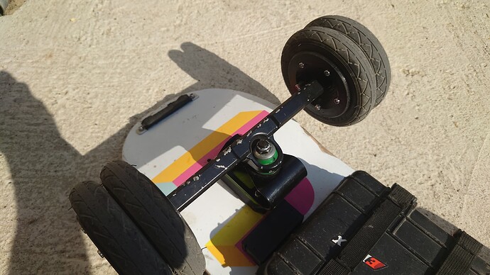

200+km, the tires and 3d printed rims seem good
Sharing the test 3d models:
https://www.dropbox.com/scl/fi/6a8gq9g5436zi3cyihaxw/pneumatics5.rar?rlkey=3h1u8kcyz2ahzc8oxt57sypko&dl=0

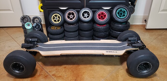

so tynee!
