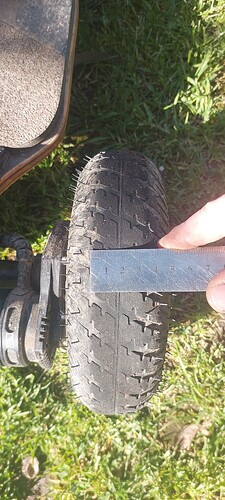

I have abandoned all of my 34mm wide wheels and scooter tires because in 50 miles they wind up looking just like these:
As in this picture, that tire was designed to be leaning side to side on a regular basis. On our four wheel platforms they do not.
Everything has it’s compromises, for the way that I ride I see no advantage to those scooter tires other than their price.

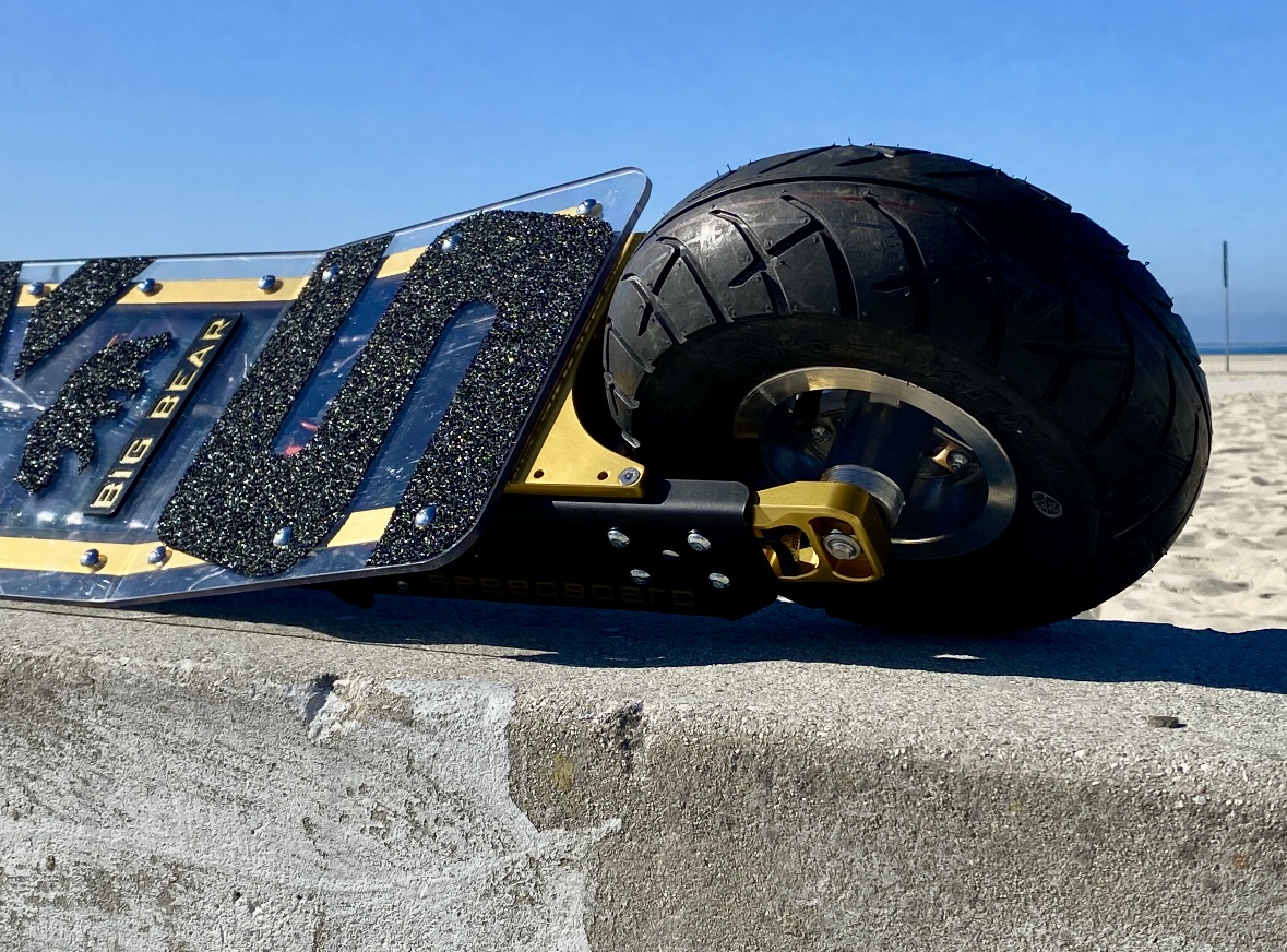

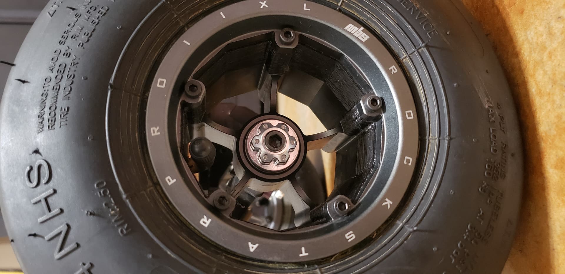

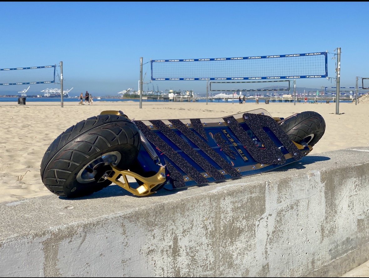

Currently I have 5 different types, sizes and brands of tires/hubs that I am switching between.
But in the past I have gone through 6" Hota, 7" Sunmate, 8" CST, QING DA, & Cheng Shin tires. And I found that none of them lasted very well. They all “crowned out” wearing out the centers first. I even tried running low pressures to spread out the wear pattern. But that l caused them to feel unresponsive in my opinion.
Once I went to 12mm axles and 28mm MTB bearings I bought a set of 165mm x 62mm XCELL RS V2 eSkate Tires and a set of 160x70mm Linnpower NEXT racing slicks that I have yet to wear out on the street.
But a couple weeks ago I went to a set of 235mm x 89mm turf tires on 80mm wide MBS RS Pro II XL hubs thanks to @Dinnye and these beasts may just be my new favorite. They are unstoppable and rugged. Great for exploring the unknown at night.
The kool thing about the larger volume tires are the ability to accurately set tire pressure to the exact pound, with out the pressure dropping as you remove the gauge or pump. As was my case with the smaller tires.
I find that these big tires are extremely tunable with pressure changes.
