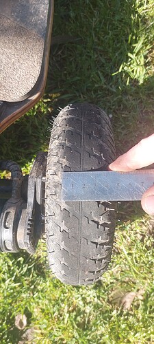

Can you measure the inner diameter so we can try to determine what wheels these might fit on?
Internal diameter is around 75-76mm
Looks like berg/sixhsooter size maybe (~71mm ID)

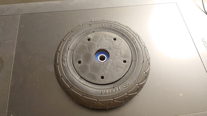

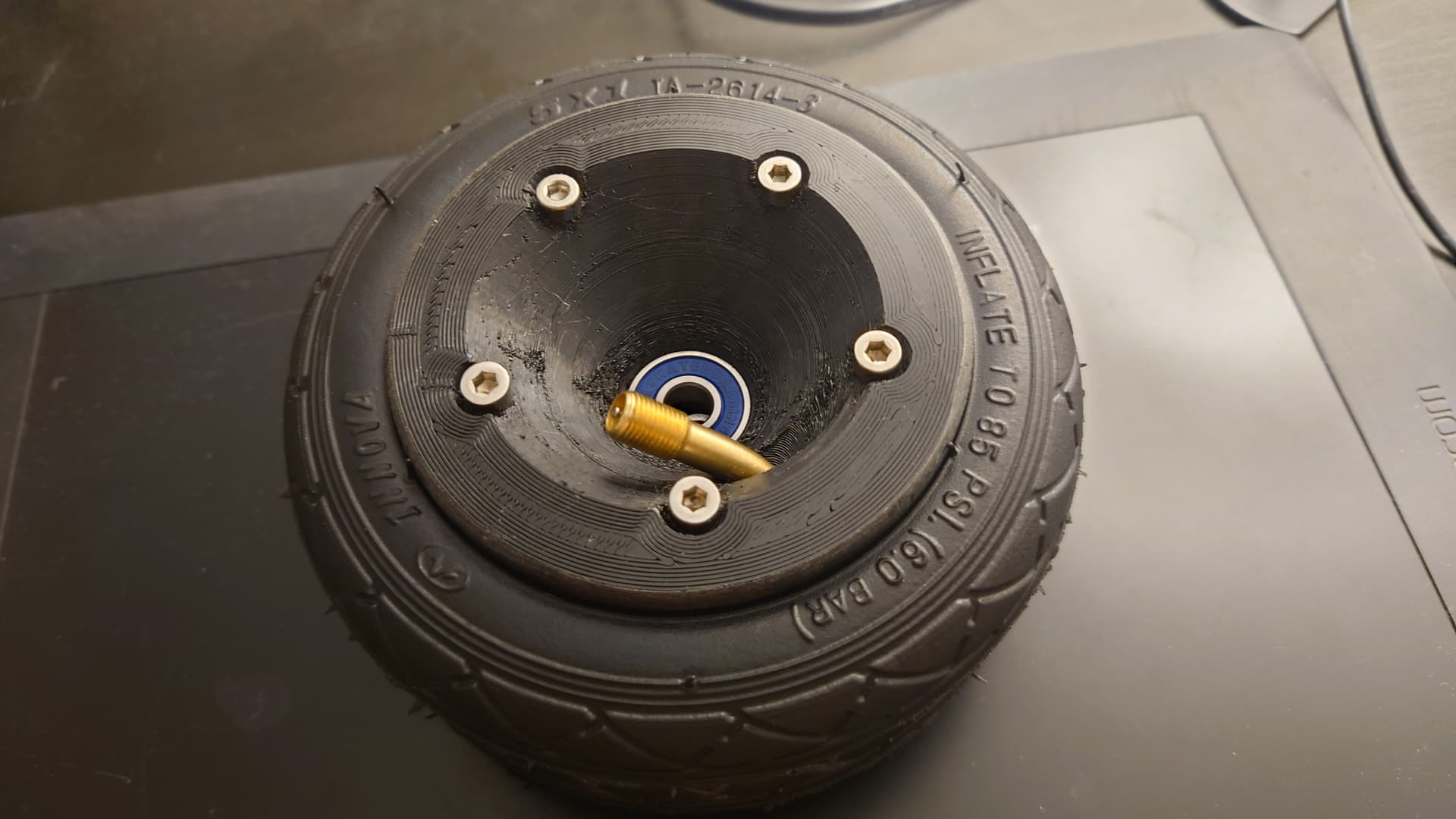

First attempt, 1 piece out of 3, everything fits, aside from wrong valve direction.
:doughnut: :doughnut:
Haha, it even clears, there’s no wheelbite on the deck, but there could be wheelbite on the foot, so +5…+10 mm riser.

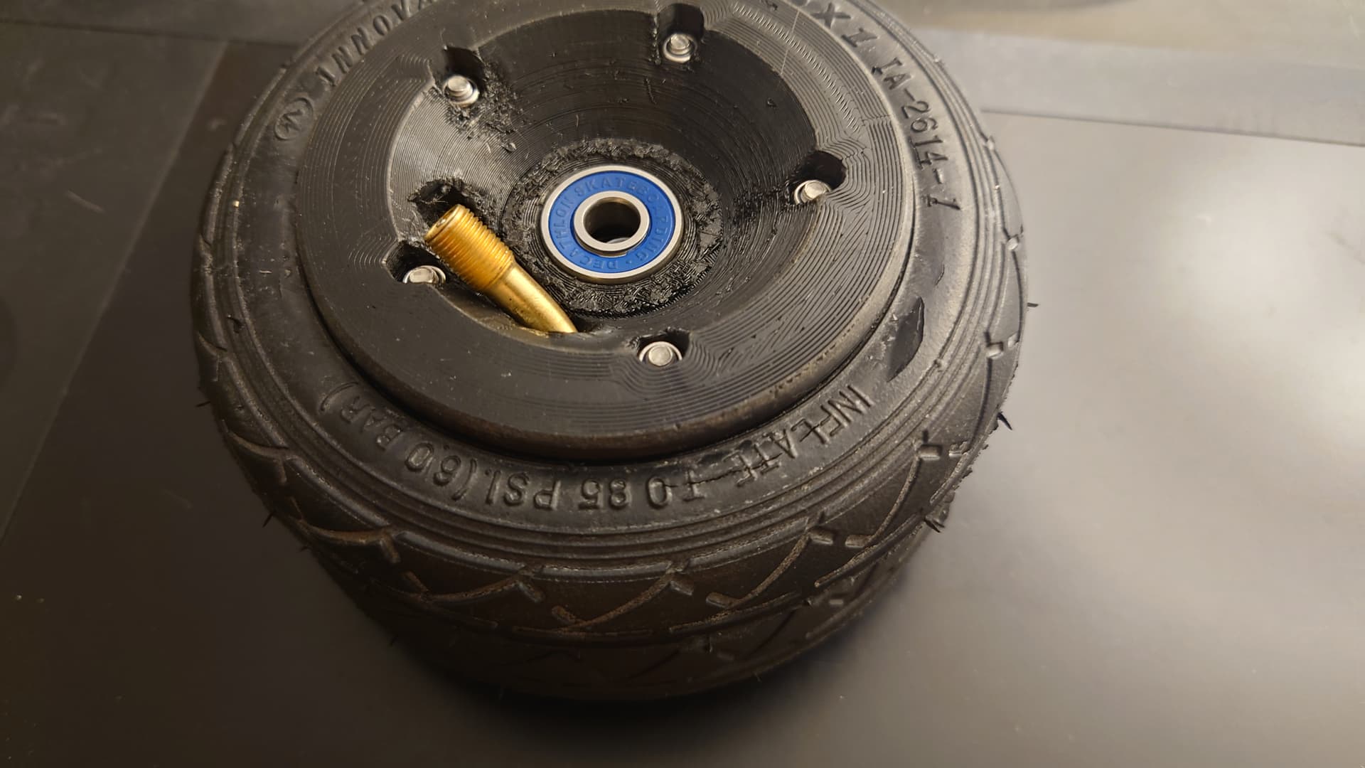

1 tyre out of 4 was noticeably older and crustier. It started cracking after few hours at 45 PSI.
The other looks new and is alright:
That’s disappointing. I still gonna test them. I only got 4 tyres and gonna be using them on the front. I couldn’t find where to buy just these tires, but there are spare 5x1 tubes on Ali.
At least I would know if pneumatics on my cruiser are worth the hassle.

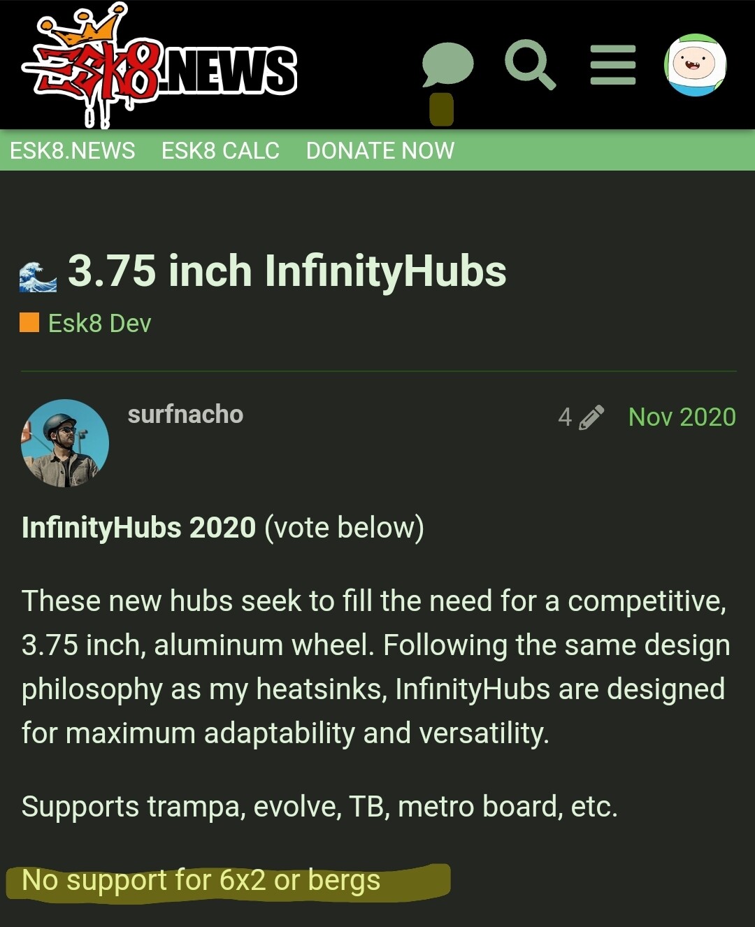

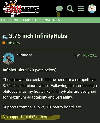

Does anyone know if the Berg gear interface works with the infinityhubs?
Tire wise, no. What do you mean by berg gear interface though just to make sure I’m not misunderstanding.
The 3-lobe interface found on the boardnamics Berg adapters and the avio Berg adapters.
Kinda looks like it’d fit
Ahh then yes, those fit the same 3 bolt pattern :+1:

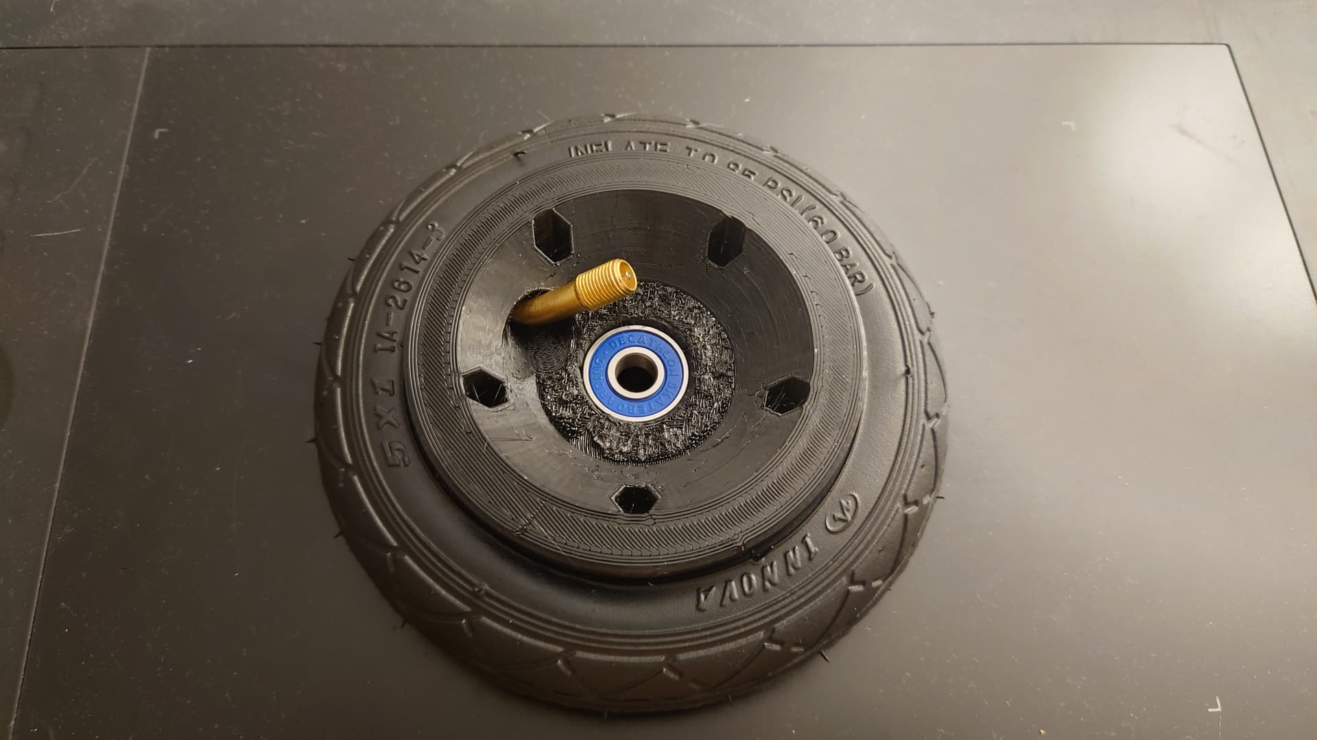

Made the hubs a bit narrower, these are 60mm m4 screws.

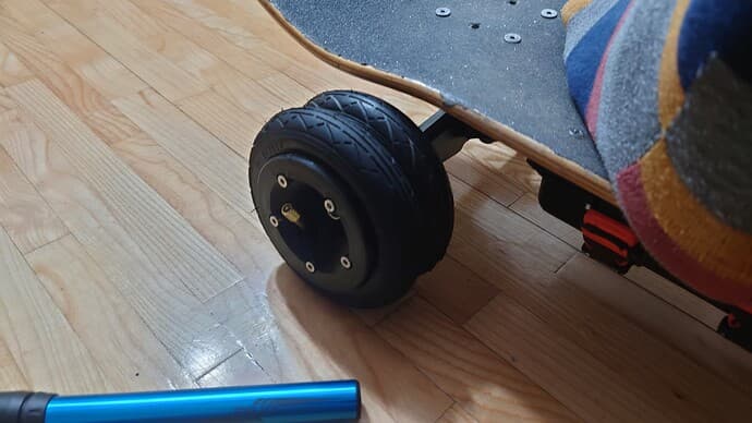

Haha, they do work, tons of grip, don’t feel the bumps at all. And I think there’s quite a bit more rolling resistance compared to madwheel clones. I’d like to try a full set, but I think I would need a whole new board with bigger battery and deck for that to be practical.
How do you inflate both tires?
The valves are on both sides.
