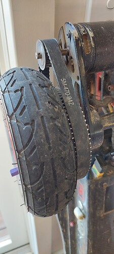

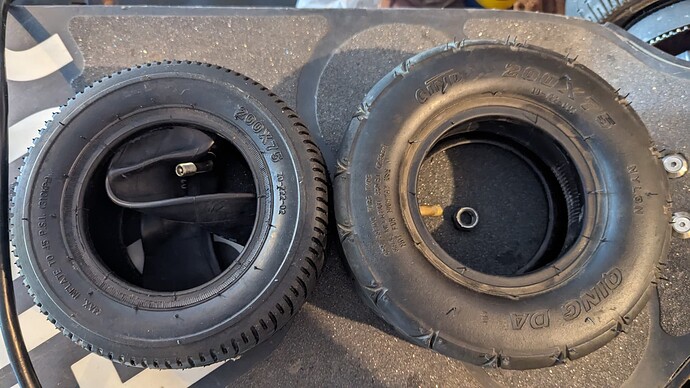

They’re a little shorter and definitely rounder than the qingda. I had to rotate them after about 200 miles, so I don’t expect to get much more than 500 miles total. That said, they are a lot more comfortable than qingda tires.
Nice! Thanks. If I drop my build down to 8inch, these look like a sweet option

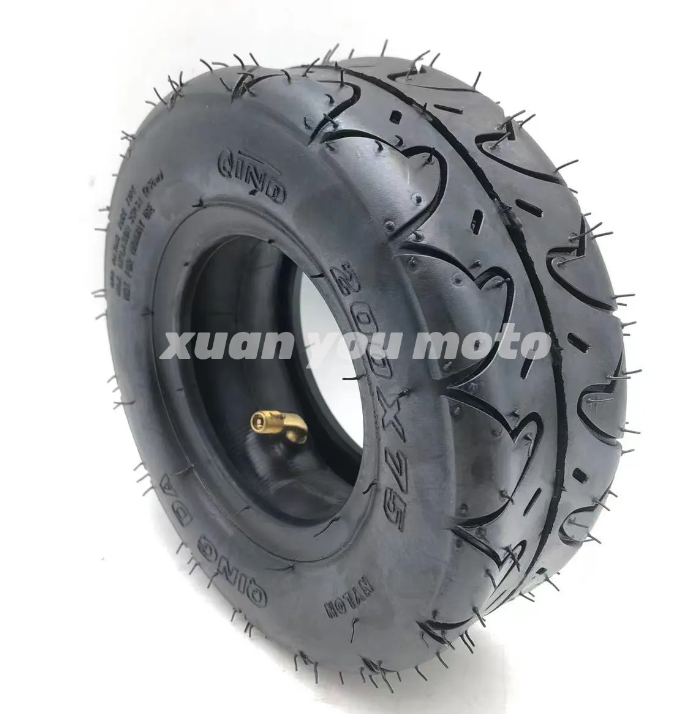

I’m wondering the same thing about these tires that ali recommended me the other day. Pattern seem to be the same as Kaly tires and they do have some positive reviews.
https://www.aliexpress.com/item/1005005447959274.html
hohoho this is a find
those are qind, same as Kaly. they haven’t been on ali in forever afaik
(personally I find these tires overweight and don’t like the hit to my mobility)

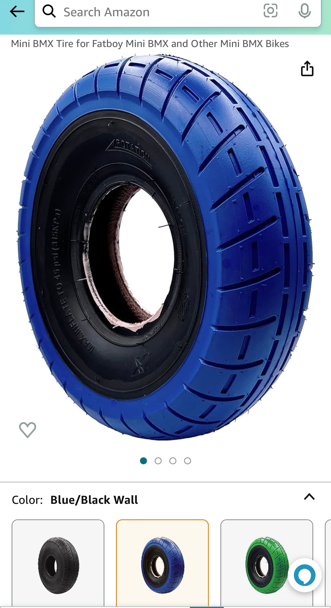

Lol, they are the tires that the hellcats were made for after someone post an Amazon link to this tire and Ernesto made the hubs that fit.
@3DServisas, this is your destiny. The entrails have foretold of the hub that fits this tire.

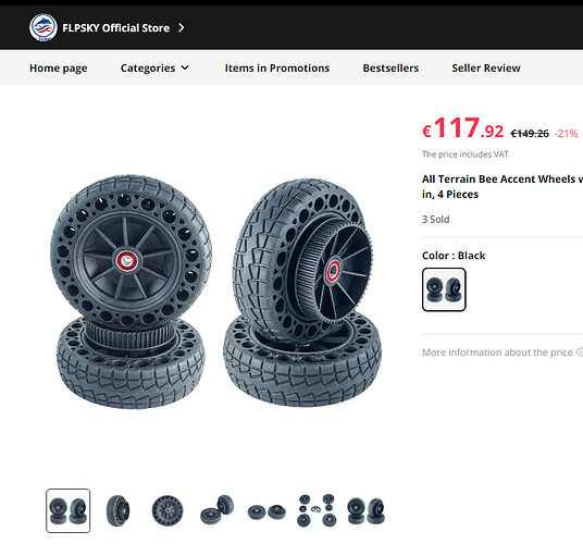

Has anybody tried these “airles” “pneumatics”? :smiley:
They’ve been on there a few months. They shaft you on shipping tho
I did not enjoy how these made my board feel
Ride feels like you took to much Benadryl
Exactly. But it’s just personal opinion.
Personally I feel that the race to the most car like esk8 wheel has the potential to spawn products that make your ride worse for the sake of aesthetics
I’ve ridden them on a buddies evolve carbon gt style clone.
Durable, no maintenance, no popped tube chance. “Practical” I’d say. Completed the assignment, C student.
It’s a stiffer ride, with less bump absorption. Stiffness didn’t come with extra precision or grip. Can’t say it properly exists on an imaginary spectrum between urethan to pneumatic tires.
Never ridden trampa gummies, but I bet gummies don’t feel like them.
put these on evolve hubs with a little 3d spacer as the ?welt? isn’t standard - i wouldn’t recommend trying to change the hubs. up to 25mph they seem good, above that and they will unseat and expand to fall off the hub if spun in free air though it may be because of fitment? gave them to a friend who is a snail and he loves the 0 maintenance and has gotten about 250 miles on them afaik without problems.

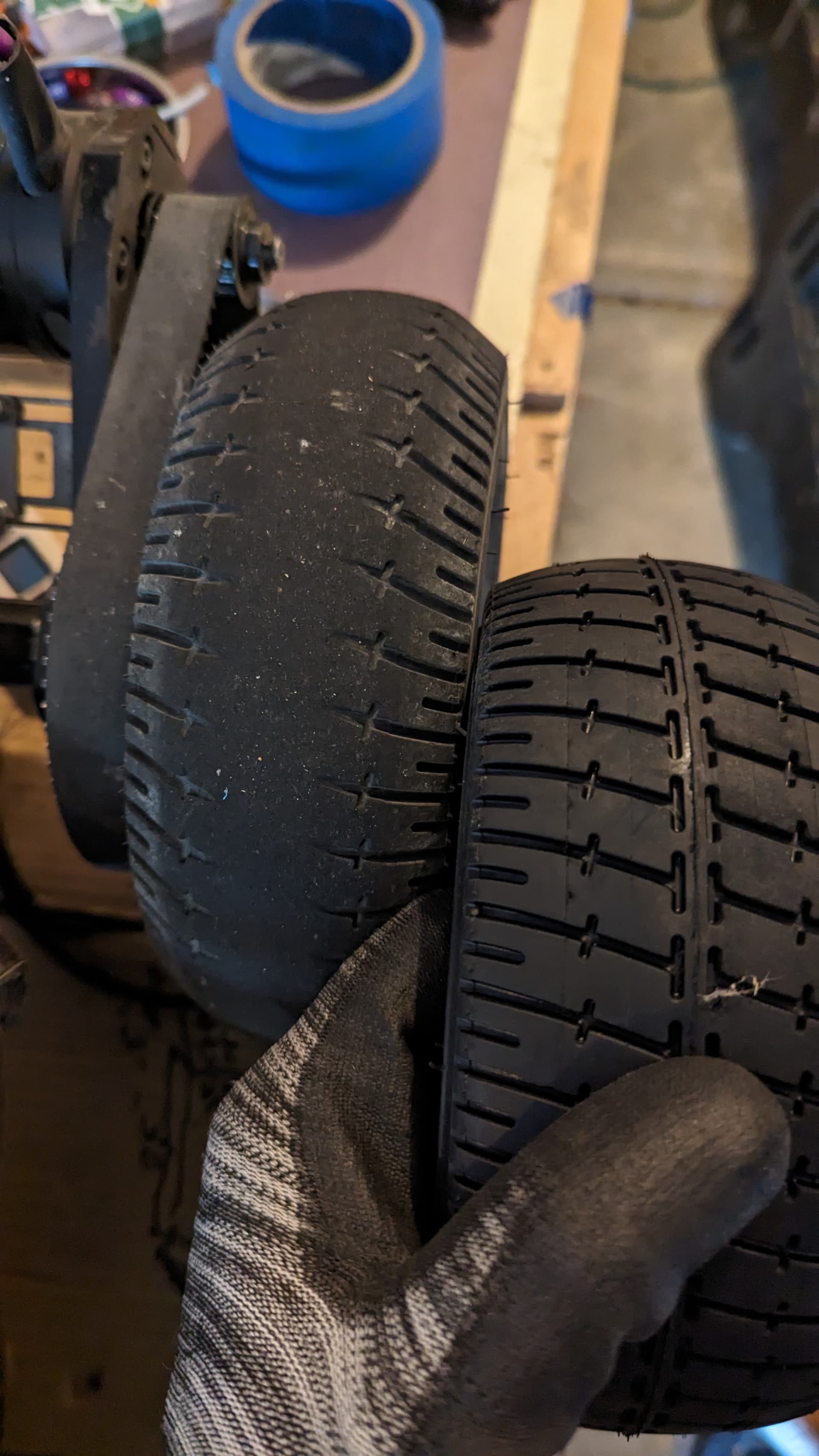

I normally prefer 200mm rubber but recently got these 175mm to see if it would solve an isse (didn’t) bit they are very good wearing, comfy and durable.
This is them at about 2 weeks, by comparison, the MBS roadies I had on prior I shredded in 2 weeks. I loved the grippy bastards… probably too much, but at 2 weeks, i just can’t justify them.
The supplier is the same one that manufacturers for Evolve. They went on with only 5g to balance, which is much better than I’ve been getting with other China brands. They also uave other sizes and white walls unbranded with Evolves logo, which is a bonus.
Anyway, shipping was shit (haggle them), but i ended up landing them for under $20aud each, which is ok… not great but decent.

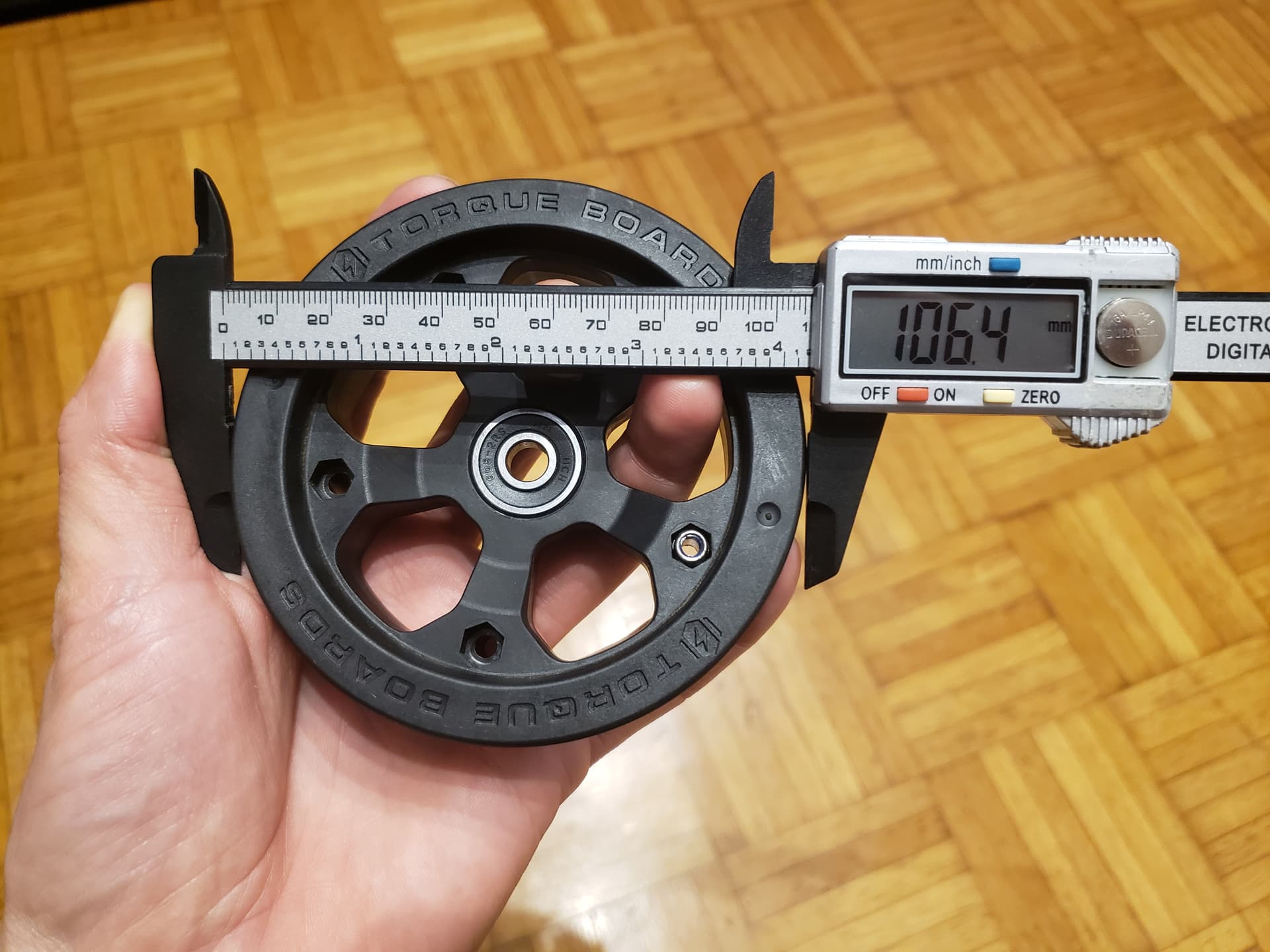

I’m talking about these:
you can use pretty much any 6", 7", or 8" tire with those hubs. For reference, we usually refer to hubs of that bead diameter as 3.75" hubs.
You have a wide variety to choose from. BKB all terrain tires would be a good choice on those hubs.
