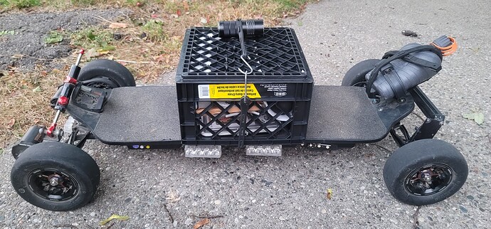

I ran the Kenda version for a while last year on both my Flux and Comp95 mountainboard. I found them to be more comfortable than 200x75 phatties due to softer sidewalls. I used 2.5in offset hubs as shown here, ran them very soft… 15-20psi. Grip was outstanding for T-racing and on pavement. Efficiency was just as bad as with Phatties… More contact with the road = worse efficiency.

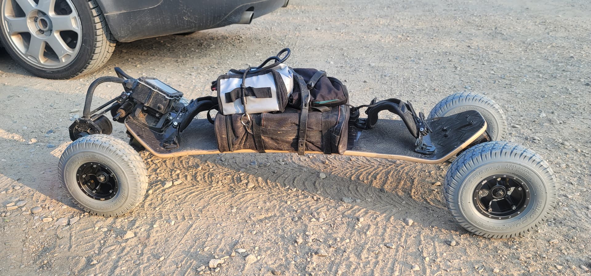

I’ve not seen anyone use these before, have been thoroughly enjoying them. Starting with stupid over-gearing, I improved my efficiency from 27Wh/mi to 22Wh/mi by going from 200mm to 225mm too! These are Primo Durotrap 2.80/2.50-4 9x2.5 225x65 made for mobility chairs, which I found at Monsterscooterparts.com.
I don’t have the directional stability at speed on dirt/gravel I had with rounded knobby tires (specifically 200x50 Clever “shitslingers”) but have much more control on those surfaces than with grooved 200x75 phatties.
Once warmed-up on dirt, (me, not the tires,) I find myself throwing my weight into carving when finishing my skate on pavement, practically trying to rip the tires off of the hubs. They’re just as grippy as the phatties or slicks were.
I have yet to balance these, and they need it. They ride smooth up to about 15mph unbalanced as shown, then I can feel vibration starting. I’ll report back after balancing, trying them at higher speed.
UPDATE: My settings were off by a country mile, indicated speed and distance were totally wrong. These feel great up to 20mph w/o balancing, but have worn very quickly. I’ve probably scrubbed half the tread off of the front, 60% off of the rear in only about 300mi. Now that I’m comfortable with the powah of the new motors, these are a joy to powerslide, but do seem to let loose much “earlier” than either Phatties or Kenda 8x3 slicks due to the much softer rubber compound. SO, for lower speed stupid carving these are GREAT, but for T-racing, I’ll stick to something a tad less “greasy”.

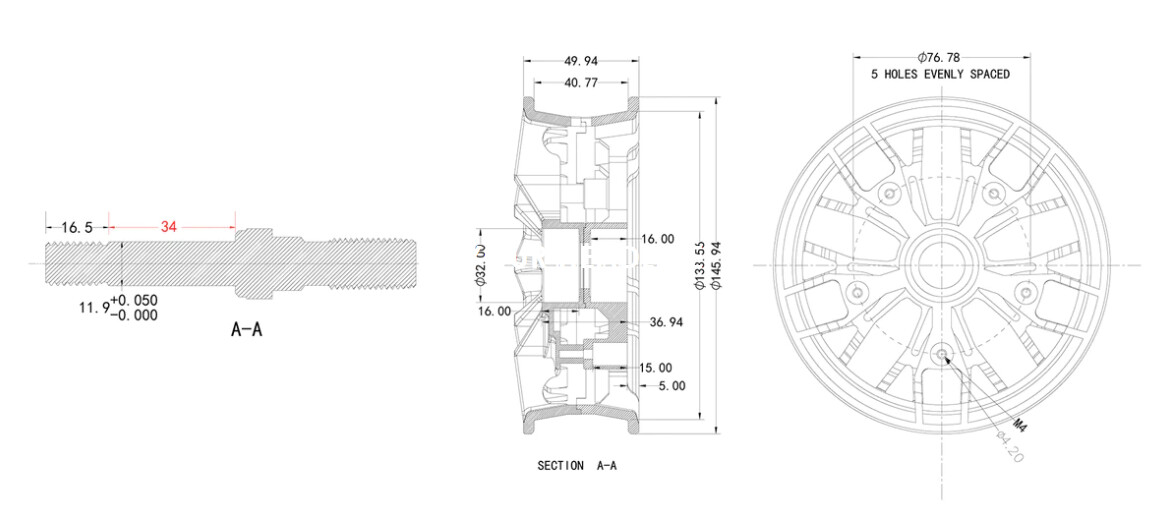

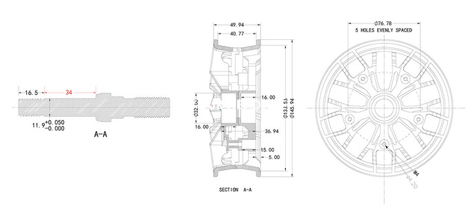

Lol I also have a design but they would cost so much to machine its not worth it
It just doesn’t make sense to support a design for a single tire unless you’re selling it on your board. Lorentz has some wheels for them now too I think
Tuovt 8.5x3 that 3DS has a wheel for is bigger than the lorentz boards wheels. Lorentz appears to be it’s own weird bastard tire.
200mm Track & Road Wheels - LORENTZ BOARDS
No its just a different widely available one that you can get on aliexpress. That wheel would fit the hota one that I also designed for
