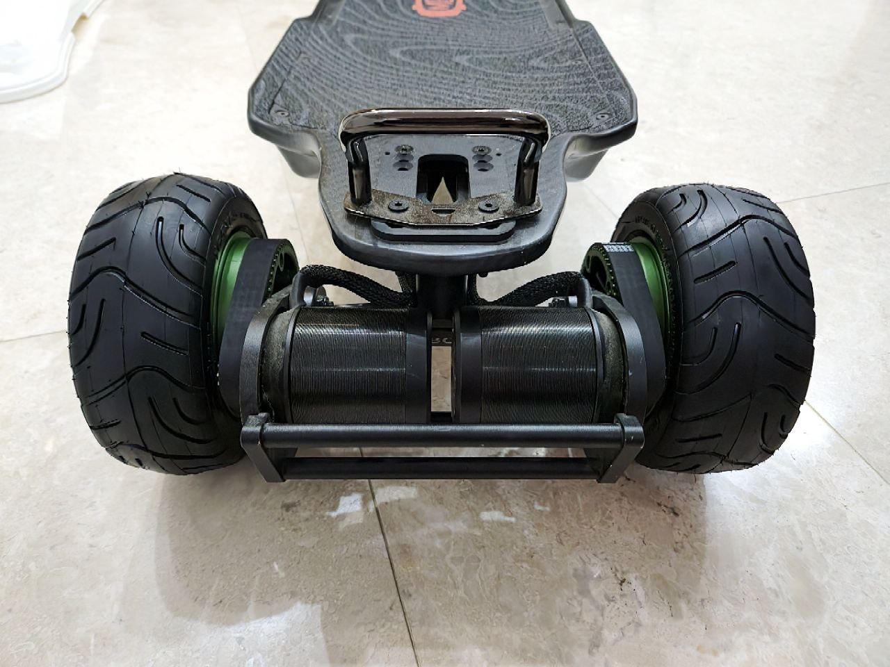

I got some of these to try on my wide rims too, high hopes.
From @frame 27-30psi
try 20 psi 4thewin
Not to shabby. Looks promising.
