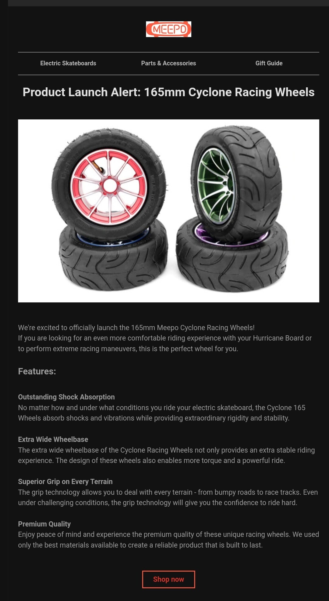

New pneumatics from meepo finally released, haven’t added them to the wiki yet because of lack of information but here’s the announcement
165mm diameter, 65mm wide (nice), hubs that IMO look great and come in lots of colours, set of 4 hubs + tires etc + pulleys for $249, damn
That is a pretty good price for the set. The original 155mm tires on the Hurricane lasted less than 300 miles. On top of that the cornering performance was not very good. I am much more satisfied with the Sunmate tires I am currently running.
Does anyone know who makes the 165mm Meepo tires?
Also appear to be missing an accurate shipping cost. Nothing of any real value / size ships for free to New Zealand. Or does it!?
They do seem to have a lot of free/cheap shipping options, their boards ship for free to Ireland because they have an EU warehouse
That’s pretty cheap then, for 4 wheels, tyres and pulleys, if shipping is actually free. These are pretty new tho, anyone know if the hubs size fits other tyres? Doesn’t look like they’re selling just tyres by themselves which is strange…
Yeah the question of which hubs they fit, general quality, availability of replacement tires, special tubes etc are why I didn’t add them as a listing to the wiki. Once I get more experience on pneumatics I’m tempted to try these out
