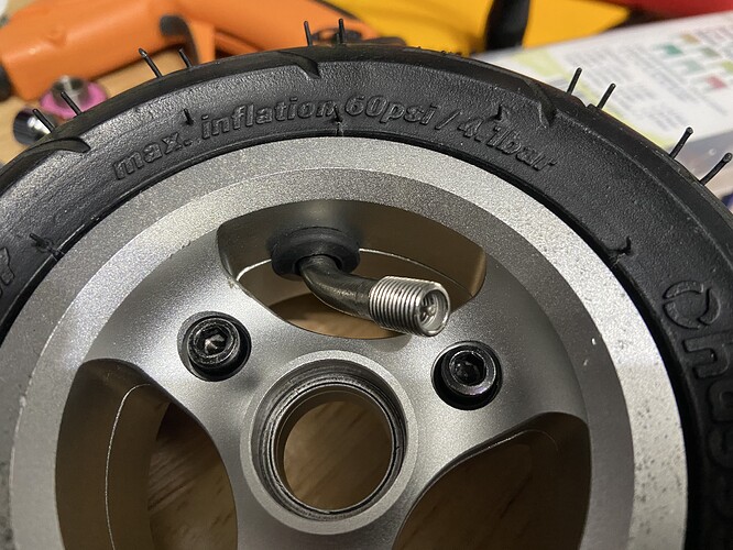

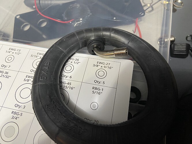

I’m not sure if anyone cares, but I got a grommet set so that I could find the size needed for my Bergmeisters.
The set I bought from Timo right before he moved, came with grommets instead of the orings on the valve stems, and I’ve got sets of Bergs without anything.
So, in case anyone wants to know:
