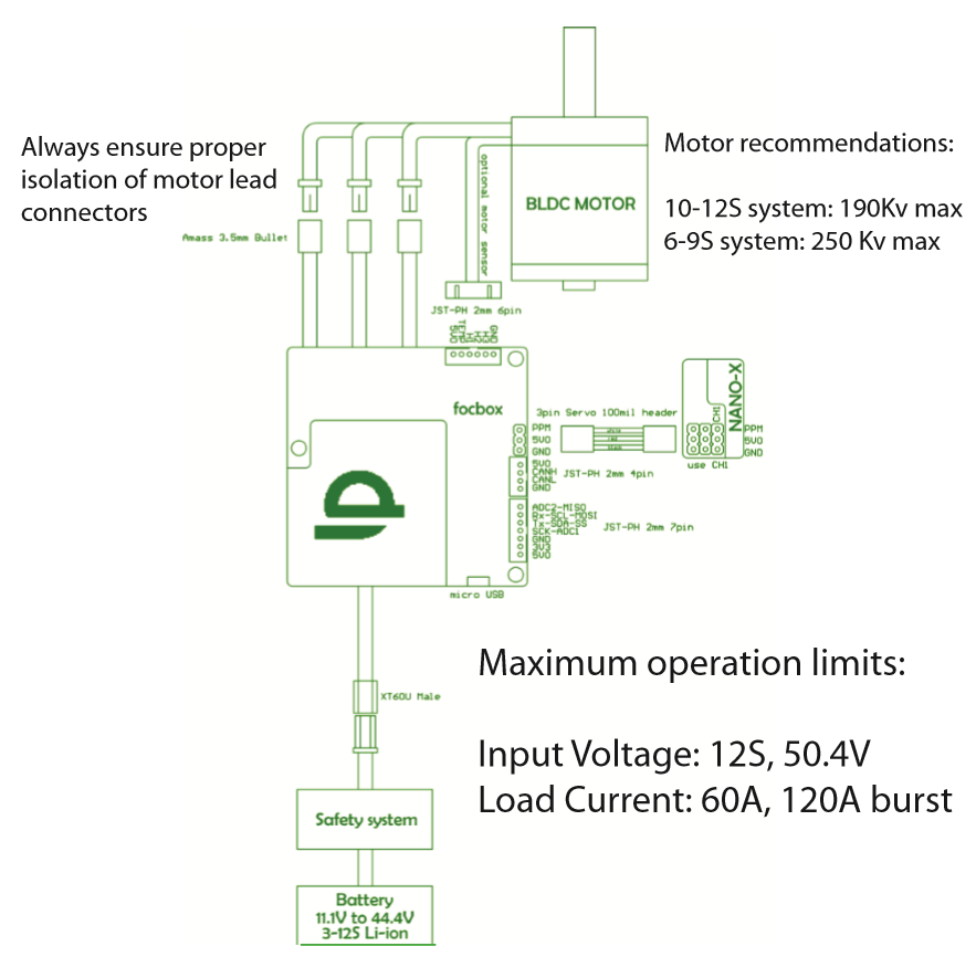

This is all I could find on setting motor/batt settings. Assuming 80a motor max will do fine as it will only really ever reach those amps on hard acceleration for a short burst.
Though this note on the site says here regarding batt max:
Please note: Batt max shouldn’t exceed 30a / Batt min, shouldn’t be less than -15A (recommended)
If anyone reads this who use OG focboxes, have you run battery max over between 60a and 100a total? Knowing they say to not exceed 30a, not sure if I should run 60a total/30a each, Or 100a total/50a each. (13s5p Battery outputs 100a.) Pretty sure though 60a total would do the job though.
Ran mine at 40 batt amps per esc for ages on a street board, then ran em again at 30 on emtb for a while and blew one up.
how did you blow it?
IDK. one day during a ride I got a DRV error whenever i pull the throttle and it worked no more.
Also broke one DRV at I think 50 amps at a stop when throttling and making it cog.
Well I guess I will just put it 60a/-20a total and limit erpm to 60k and hope for the best that nothing blows, then all I worry about is breaking down a hill at full charge. That is kinda surprising that 2 just randomly died.
