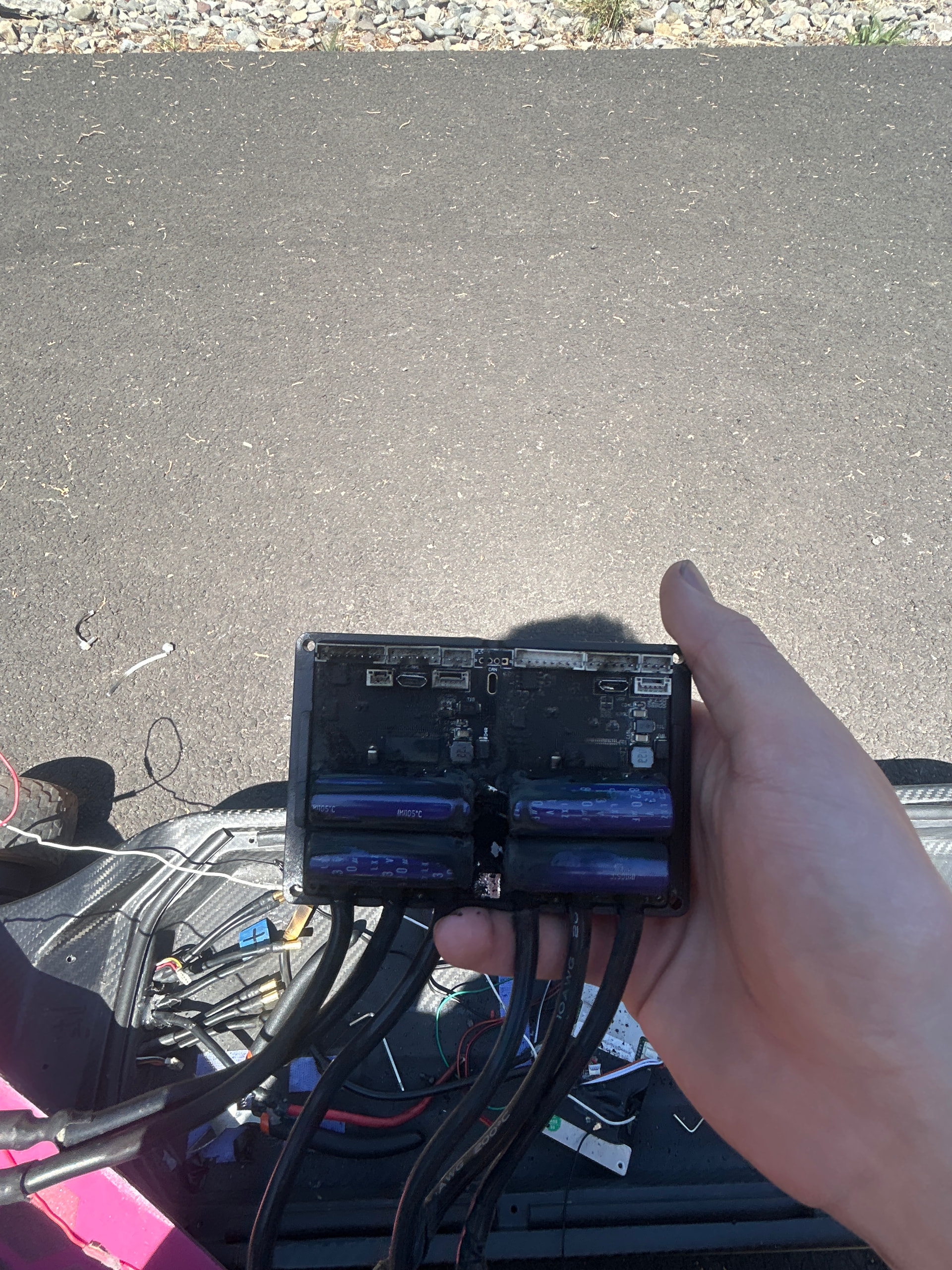

Pink Puma, first ever build. 10s4p, flipsky 4.2, dual 170kv motors
Everything was connected and fine. I just ripped out all the cables when I got home.
I was gonna say the same, usually any time I’ve seen a reading like that is when one lead isn’t right and it throws off the next one
Totally understand if you’re just throwing your toys out of the pram, i’ve been there several times. I just find it EXTREMELY unlikely that those are true readings on the battery. That’s exactly what a faulty balance wire shows up like on the bms app.
I really don’t want to mess around with this stuff anymore. If you really think that would be the case I’ll try again. The other thing that happened is my vesc smoked. It was only at 145f when it smoked and I thought that was reasonable but apparently it wasn’t. When I opened up the board and pulled on the positive and negative leads the both can straight out. I don’t think solder melts at 140f so idk why shit melted.
Edit: just checked the bms wire and it’s disconnected.
I cut my battery negative on the bms about an hour ago. Do I still need that to get readings for the battery or no? I just realized another thing. When it started burning my bms started trying to balance cells all my other cells even when they were relatively balanced. Group 11 is also kinda low and I’m thinking maybe it was from group 12. But now that the bms wire is bad (I might have snapped it whilst trying to get the heat shrink off) I’m really confused on what I should do.
Yes
Very much doubt any of the groups are low. When a balnce wire is faulty it can mess up the readings of multiple cells
Also you shouldnt have always on balancing. You wanna change that to charge only

Your VESC failure mode is interesting. In one of your pictures it looks like a phase wire is exposed outside the heat shrink.
The rats nest of BMS wiring in one of your photos is also concerning. I do not know what was going on with that, but all the best battery builds i have seen, the balance wire routing is freaking ART. Having built a few myself and trying to achieve similar is not nearly as easy as one might think.
I approachmy enclosures as though it is going into a vibration machine and everything will flex twisty and normally under rider weight. I envision what would happen if board gets run over by a car, and balance wires pushed down onto the cells.
I want the wiring to be able to flex only enough to not be stressed when board and enclosure flexes, but also i do not want anything to be able to move or rattle. Your complaints of board noise, like the enclosure was acting like a speaker seems to paint a picture that things inside were not properly secured, and added to that resonance.

Yeah, didn’t really want to shorten the wires so I just zip tied them all together and folded them on top of the bms.

I still have no clue why my Vesc failed. I was just riding up a hill with around 5-10a of power draw. I could be something to do with an old mofset blowing or something of the sorts. I bought it untested and that’s what I got.
