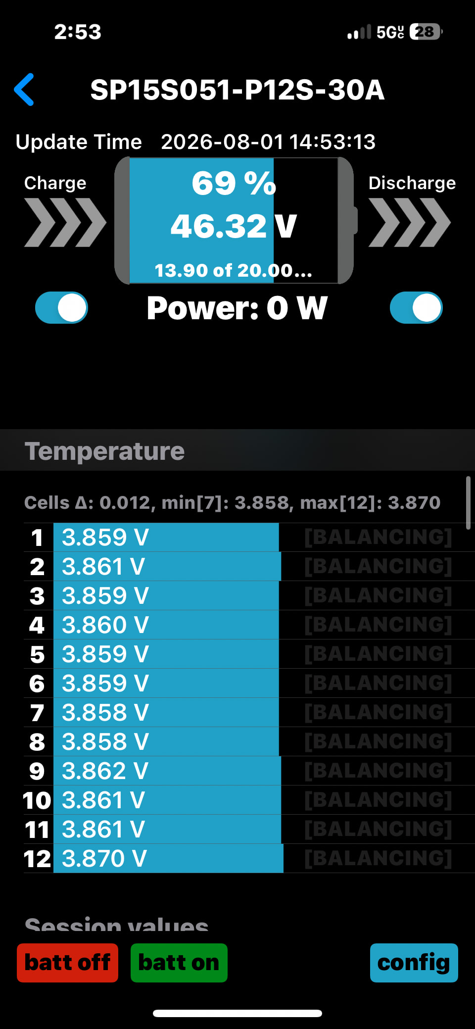

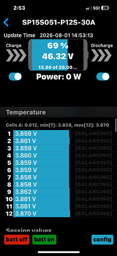

All my cells are relatively balanced within each other. 12 seems kinda high but that’s about it.
When under load a potentially compromised cell can drop a lot of voltage, and rebound back upto where it looks normal in relation to the other cells when the load is removed.
Cell balance in teh 3.8v range does not really mean all that much. its more telling in teh 4.18v range or when under 3v if any groups are out of whack with the others.
I am not saying the battery is junk, only that older cells have a higher chance of lesser performance, even from just calender aging
A 12mv delta is nothing, but it would mean more if that was at 4.19v or at 2.89v, instead of the middle of the discharge curve.

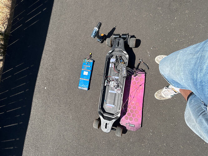

I’m so done with esk8. 2 dead batteries in the past year. Very tempted to just part out for cheap and be done with this.
Gimme a price for anything here plus shipping and it’s yours. I don’t think you would want the battery.

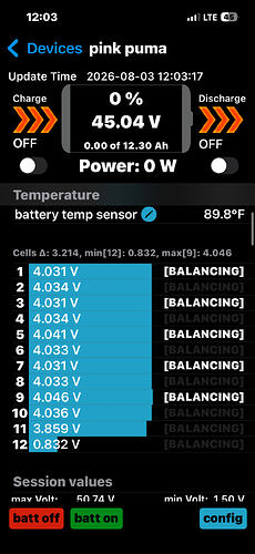

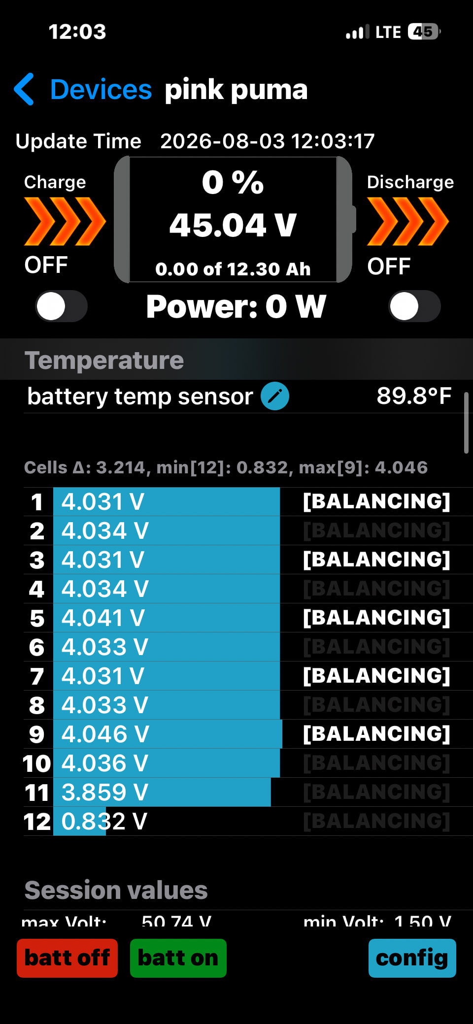

That looks a lot like a balance lead has come disconnected. I’d be willing to bet that battery is fine, just need to fix a balance wire
