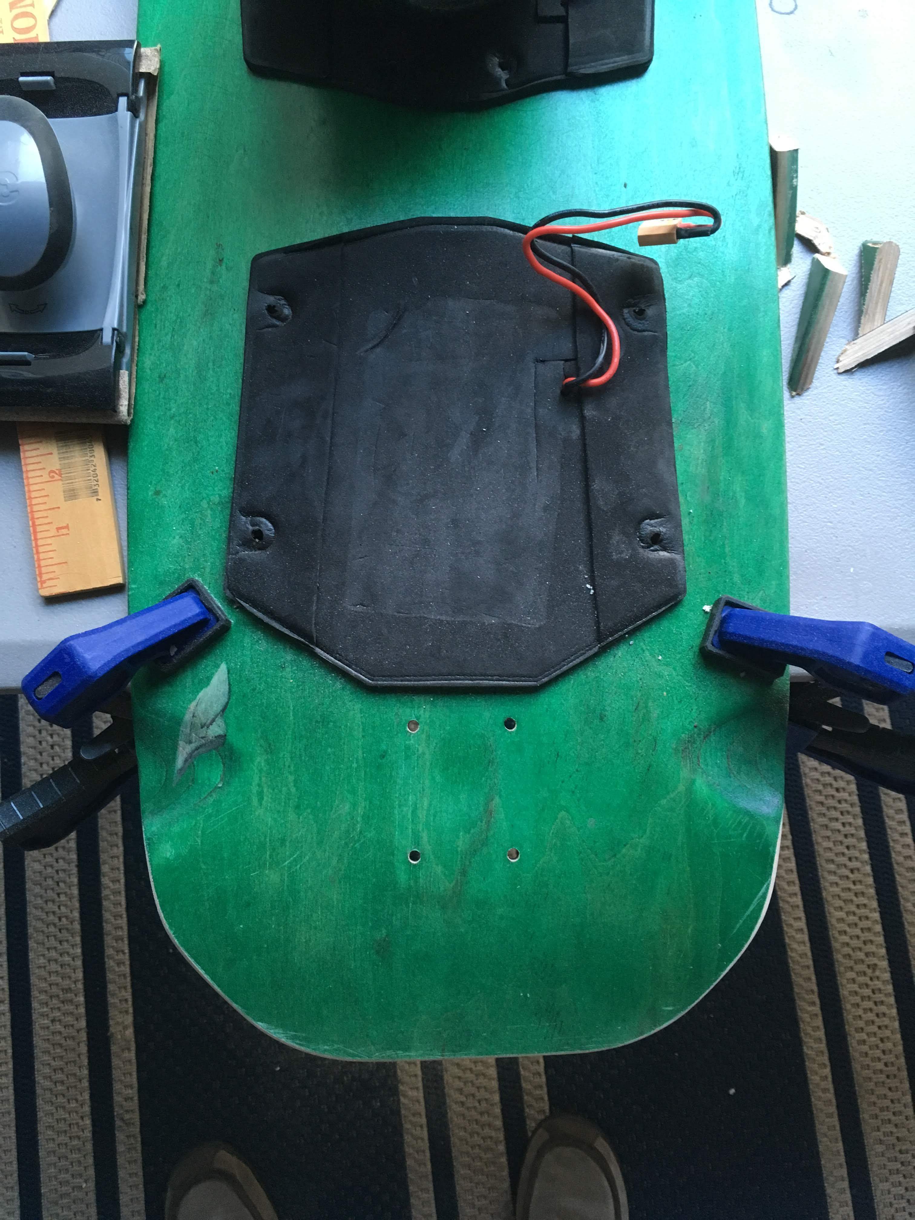

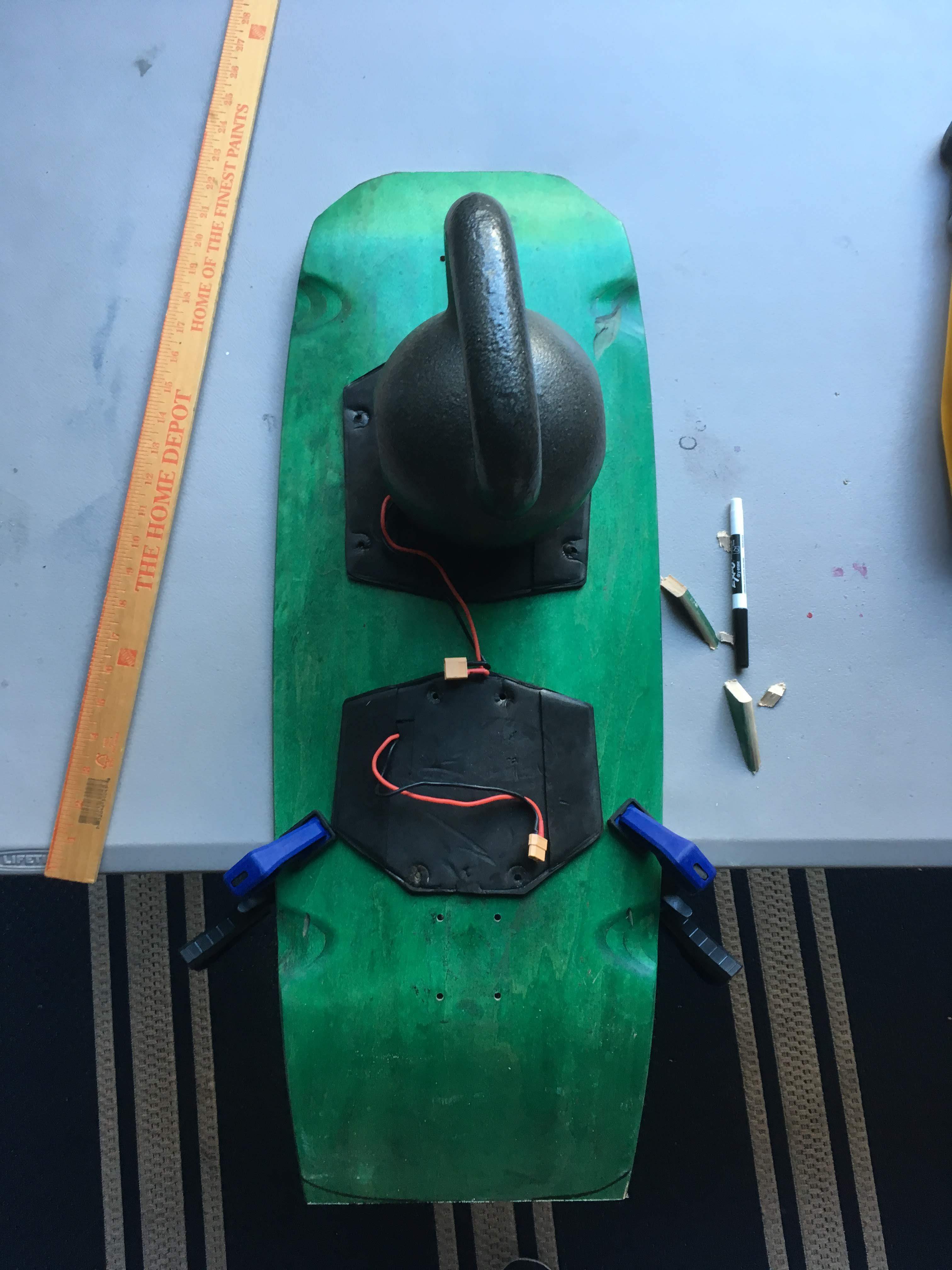

Lining up the front truck holes for scale, I saw that it may be possible.
When I got back home, I stacked the Pescado Grande and the Killdozer to see that there was indeed enough real estate.

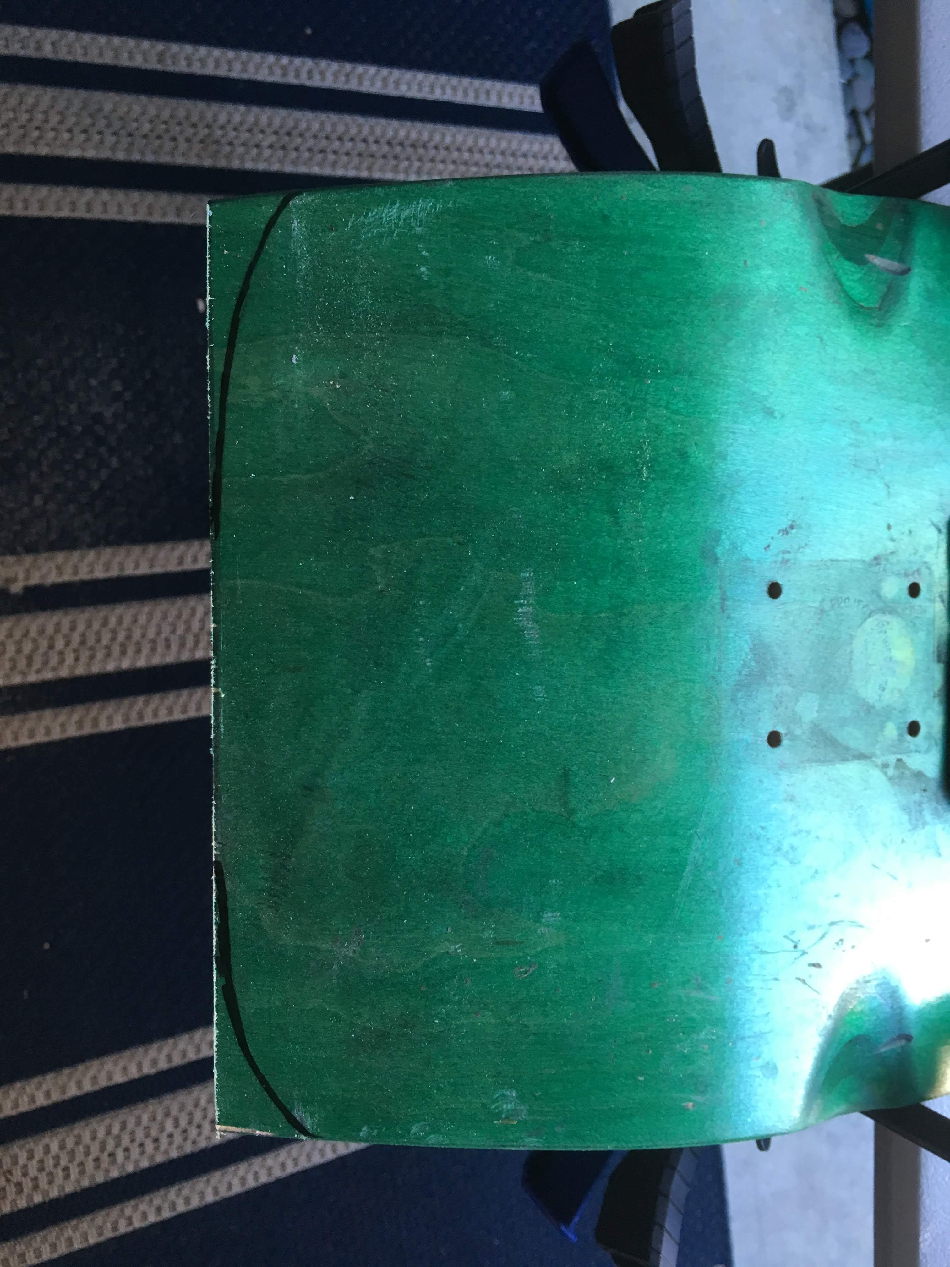

I drew the outline of the Killdozer onto the belly of the Pescado Grande. (+1" ish)
And busted out the saw to begin blocking out the new shape.
I tried to remove as much material in straight cuts first.
Then started cutting some short curves
