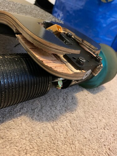

GDs will have deck bite, belt drive wouldn’t be hard for sure but to do the GDs would require taking a chunk out of the deck for clearance or using some brackets to push the wheel base out
True, and from previous people I’ve seen route out the deck for the trucks, it hasn’t been a good experience as the deck stresses and snaps much much easier.

consider a sanding drum that fits in your drill (if you don’t happen to have an oscillating sanding drum laying around). If you loosen the trucks enough to be able to push on the deck you can find the centerpoint of the bite and that’s where you lay the sanding drum, with the end pointed in the direction the motor leans from.
Somebody is invariably going to suggest placing adhesive backed sandpaper on your motor cans and just using the cans as the well sanding drums. The problem with that is that you want the radius of the wells slightly bigger than the radius of the can. Also, wtf you’ll be scrubbing them with alcohol to get the glue off.
I had a similar situation when I did a drop through using torque board direct drives on a maple evolve clone deck. Drum sanded motor wells did the trick.

based on those pics, the lamination was solid too. that’s wood breaking, not glue. makes me wonder why the witchblade I did with the inset for the haggy kahua trucks hasn’t done that. It’s got a ridiculous number of miles on it.
To be fair, this slammed into a curb going about 20mph, so it wasn’t toooo surprising. Still, I’ll never inset trucks again because it did happen.
