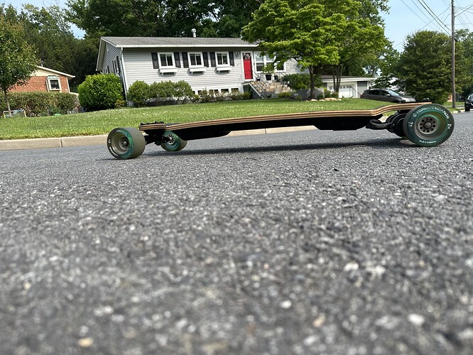

Here’s a picture of my board which is dropped through on adjustable baseplates with forward mounted motors on M1s. Keep in mind I’m on TKPs, so on RKPs you’ll have a shorter effective wheelbase, bringing the motors closer to your enclosure. It’s a very tight fit, and I don’t recommend it for anything but smooth streets. I have maaaaybe 20mm of ground clearance here.

Very detailed reply, much appreciated! Thanks for the input on the potential clearance issue. From what I gathered from your post, adjustable baseplates + BN270s along with forward mounting would solve most of the clearance issues? I’ll also keep your other suggestions in mind!
as you can see it puts your motors horizontal, lower than your truck axle which is not very good for impacts etc on it. also you want to run relatively “small” wheels so impacts are gonna happen. also he is on TKP trucks which give more distance for forward mounting. rkp trucks will make it so when you forward mount those motors, they will hit the dropthrough part on the underside of your deck.
I think it would be optimistic to say clearance issues are ever solved on a dropped through Hummie on gears :joy:
But yes, if being dropped through is your top priority, adjustable baseplates + 270s + forward mounting is likely as good as you’re gonna get. Your motors are gonna get destroyed though. I’ve put about 100 miles on my board with the M1s and the motors already have some scratches and a chunk taken out:
Yes, it is quite possible that the motors would hit the drop of the deck or the enclosure. I held up some RKPs and they look like they’d put the motors a solid inch further forward, maybe a bit more.

Aren’t these the 3DS low profile adjustables? The BN ones are much taller, as are the Hammocks I have.
