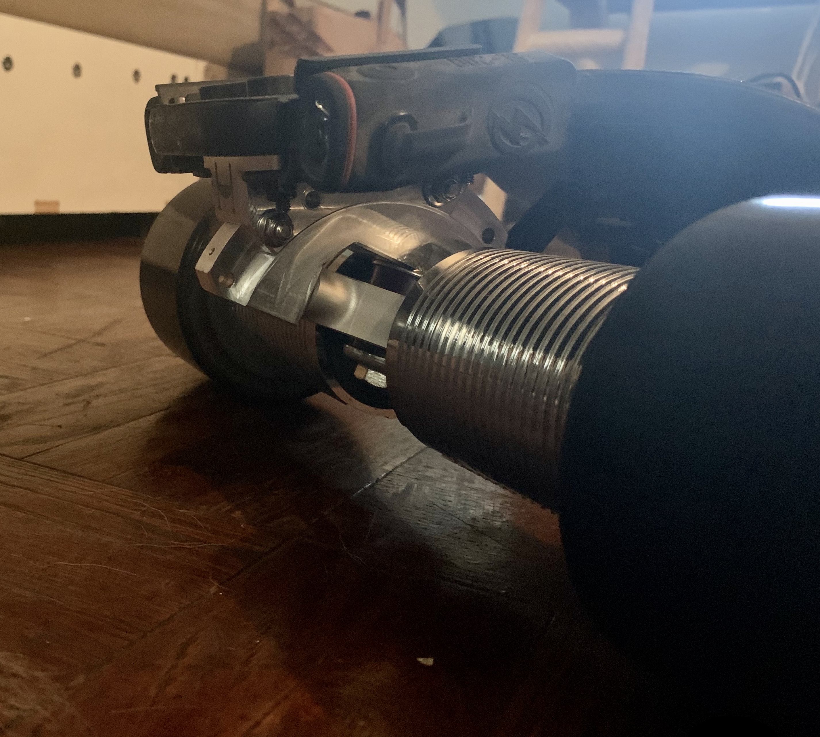

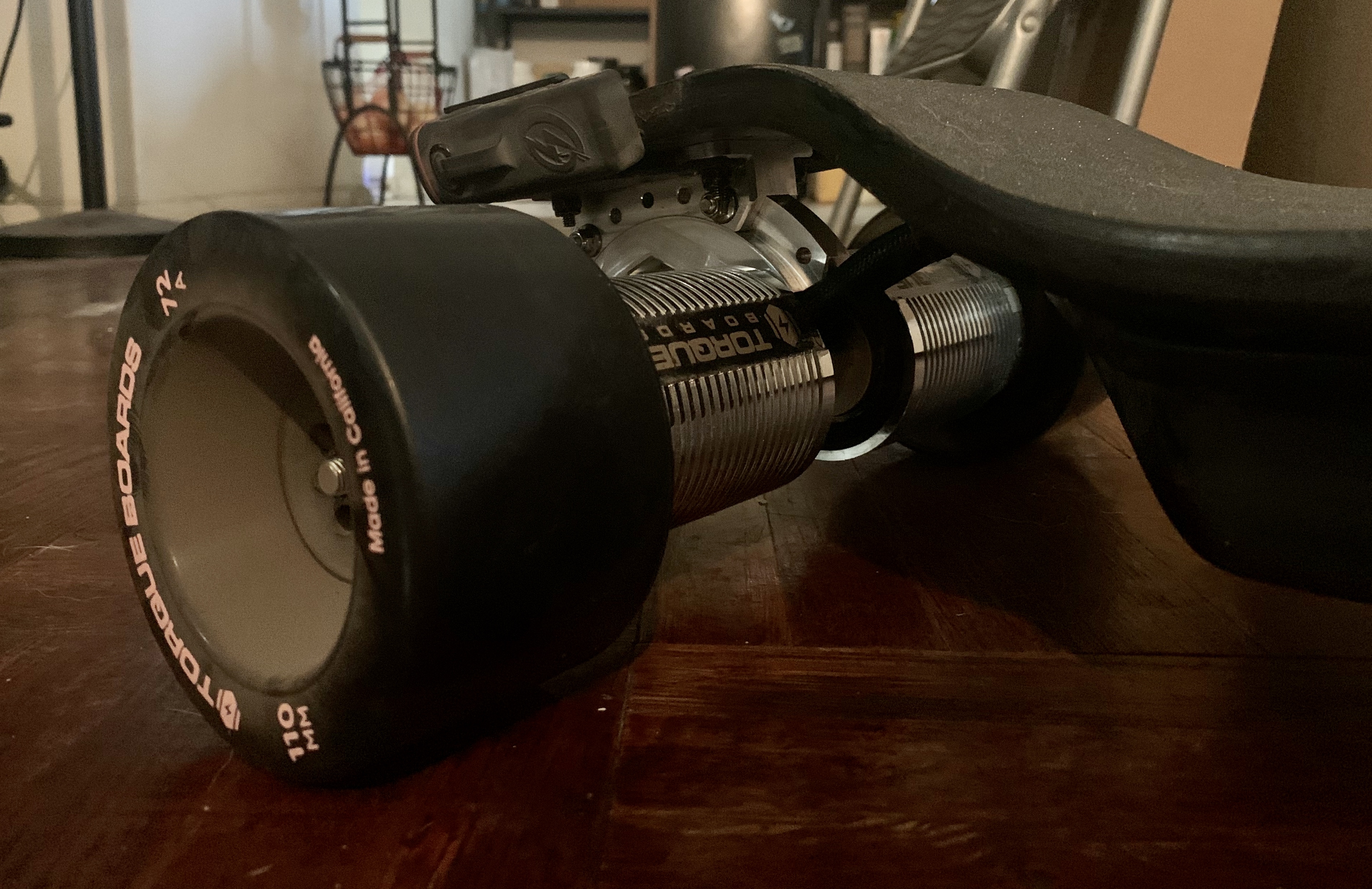

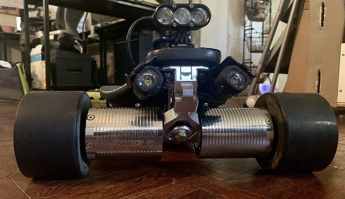

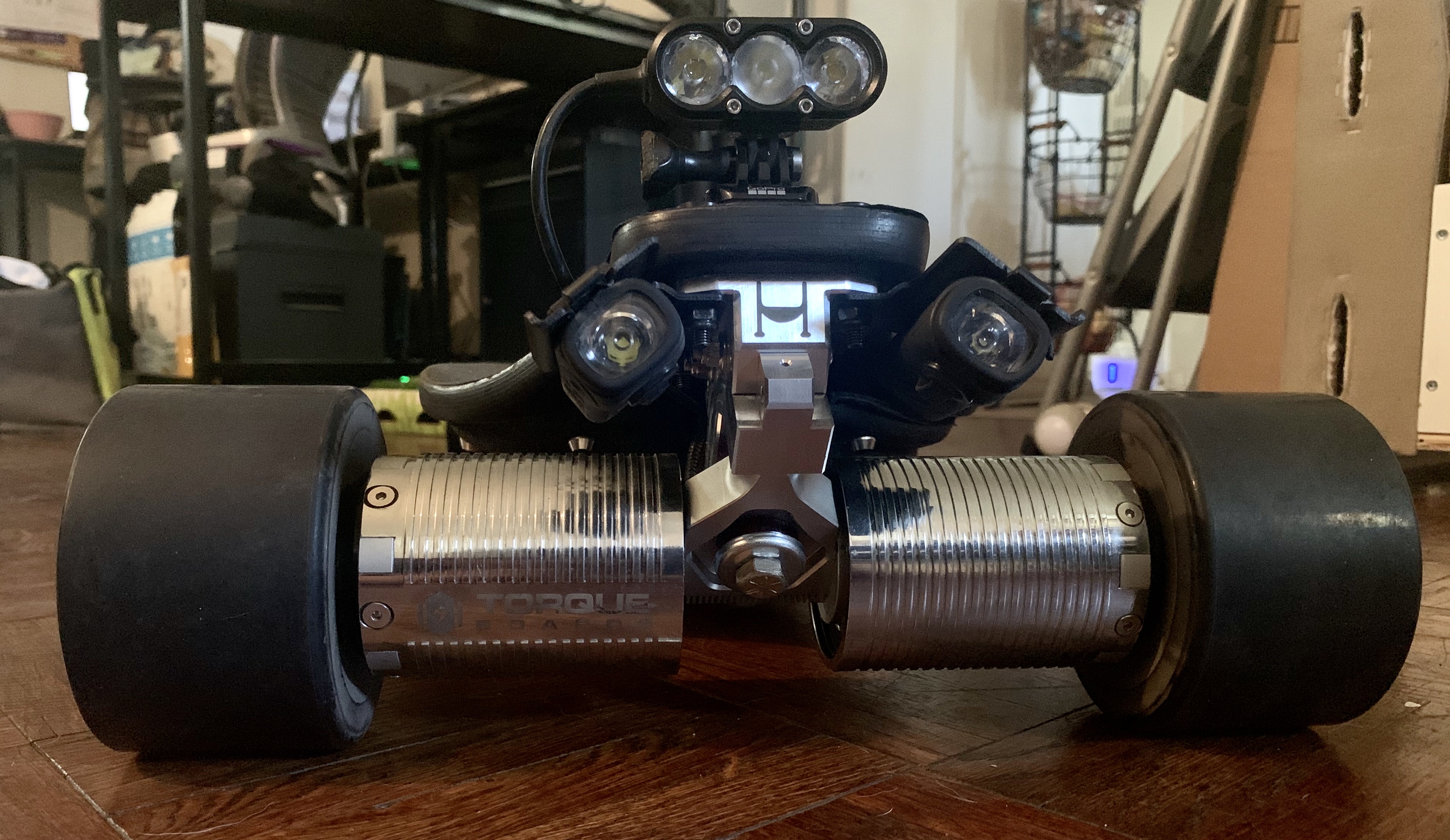

I can also confirm they fit TBDD real well :call_me_hand: only downside for me is I can’t use them with any of my motors. They are too big and hit the middle portion of the baseplate. That is also using FB275 hangers :man_shrugging::sleepy:
Otherwise I’d get a few more pairs. Otherwise they are awesome :doughnut::penguin:

Yeh the back “tail” is needed to support the 0 degree position
Without would be impossible and the allow orientations would stop around 30 degree. I made a more compact version but then everyone wanted to be able to reach 0 degree and there you need the extra material at the back.

Yeh with motors facing inside you have 4 options:
  • use smaller angle so like from 30 degree the tail should disappeared
  • use longer motor mount to pass the baseplate tail.
  • adopt wider hanger.
  • chopped off the extra material :sob:
Motor facing outside is not problem.
Shorter motors are also fine.
That’s the limit if you want a full range of adjustment. Reduced range will be really easy to make it smaller

But for what it’s worth they are pretty damn sweet with the TBDDs :call_me_hand::call_me_hand:
