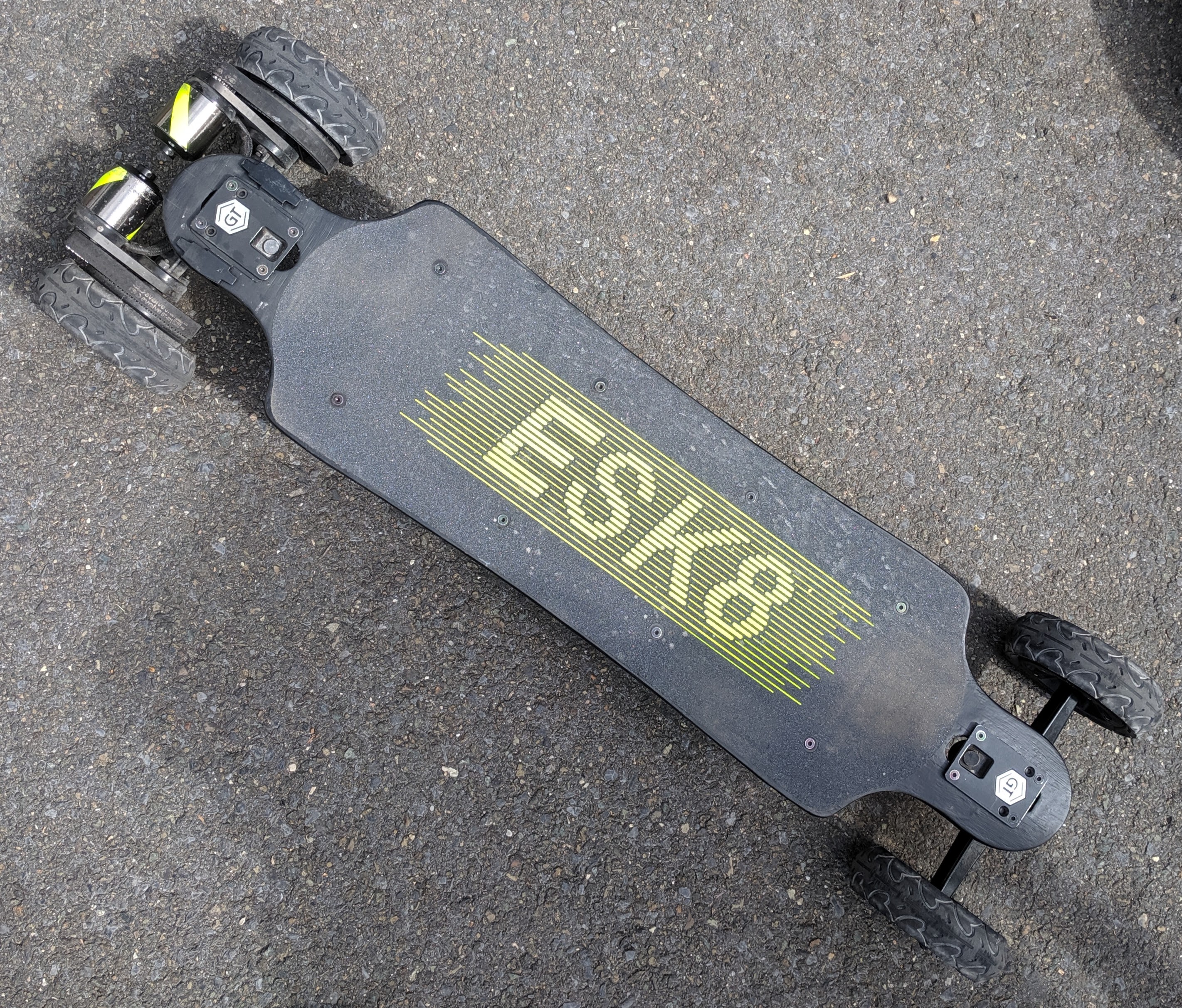

Some of the nicest custom grip-tape at the event. Simple but bold and unique. I love it.
