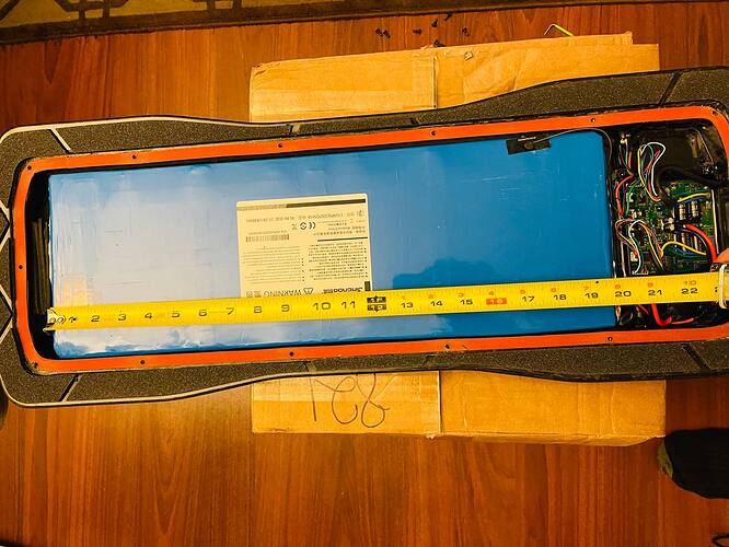

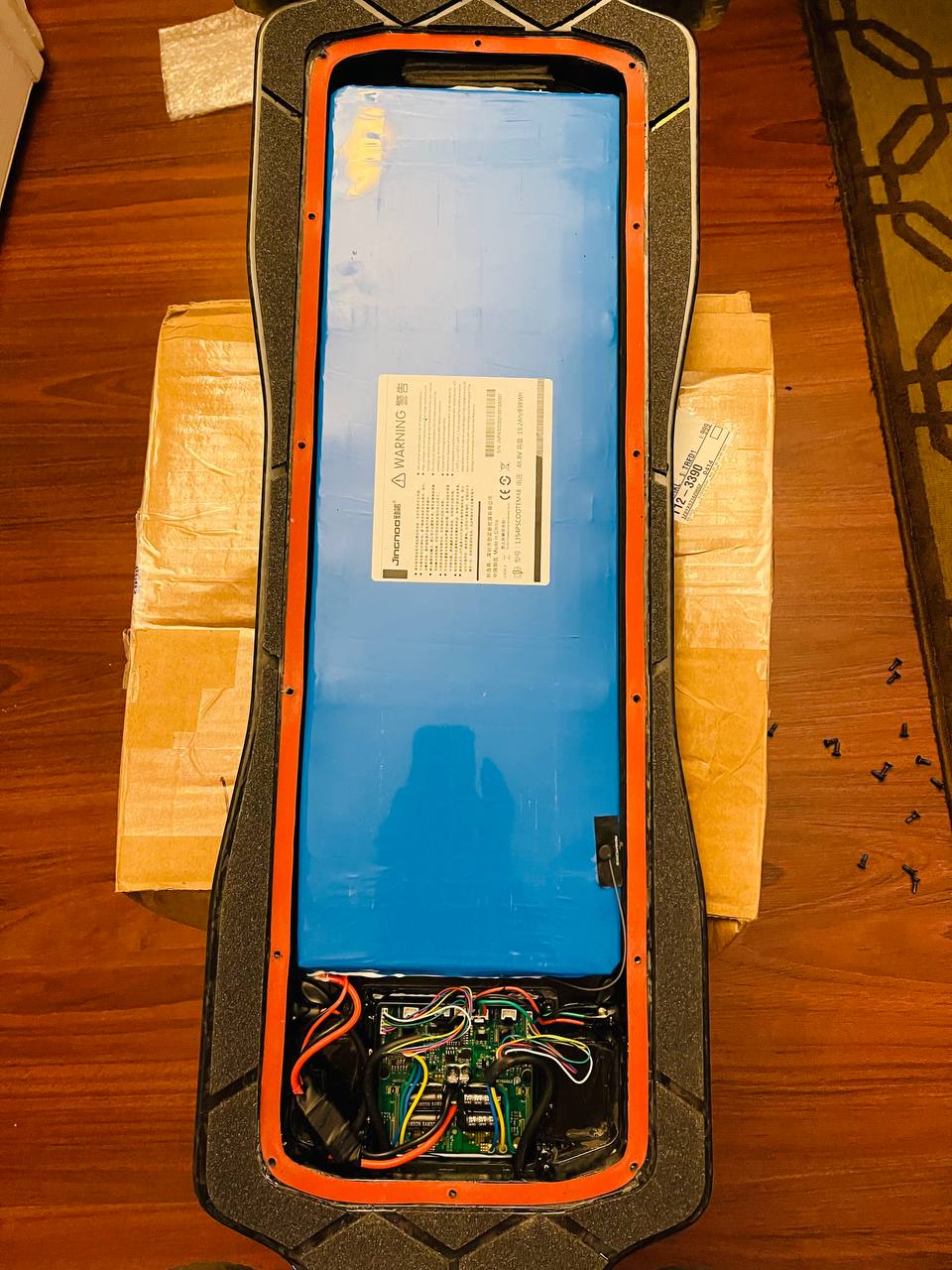

Also interested to know
got a space measurement?
thought the hobbywing esc would be potted, or has a shell in these newer version
It’s potted. Clear epoxy
ah, no wonder why its shiny at some area
did u measure the depth as well by any chance?
Nah. It’s got the external heatsink and can’t really measure it.
Thanks man!
