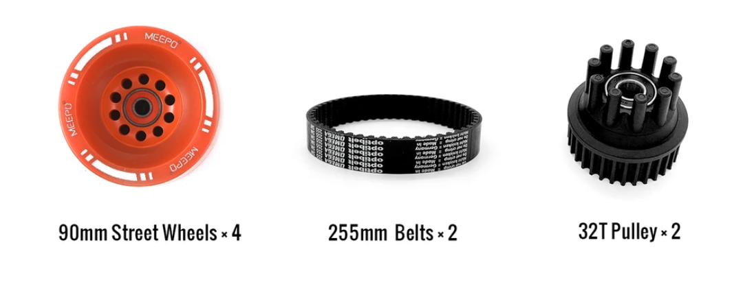

Questions: using the 97mm urethane or 120 clouds, and using either 40t or 44t, what’s the setup that maximizes range? I might try to make that commute again and would like to do it on cloud wheels for comfort, but wondering if I could make it there.
It’s because they are the same. The only difference is acceleration.
Good to know!
44T and 97mm wheels.
But interesting to read that this setup is in real life actually slower than the Hurricane and I’m quite positiv that it has a slower acceleration as well.
Was the hurricane speed tested with this setup? Thought it came with 90mm (which would make it more impressive if hitting 31mph with 44t). Also keep in mind I’m 205-210 lbs. but yeah I’m sure hurricane would beat Zeus in acceleration on any reasonable setup.
When I was on clouds I hit 35mph easy with 44t so pretty sure 37 wouldn’t be a problem with 40t.
I believe the hurricane comes with 32t pulleys for the 90mm wheels.
Yes
90mm wheels with 44t pulley, u will need perfect road to ride, ground clearance is very little
Interesting, if I were to use 90mm wheels I’d probably choose 36T

The setup does not matter because of the probably different KV. You just ne to match the top speed and use the same type of wheels. And I think that even the Hurricane is geared slightly higher it would have a better acceleration due to the better battery.
