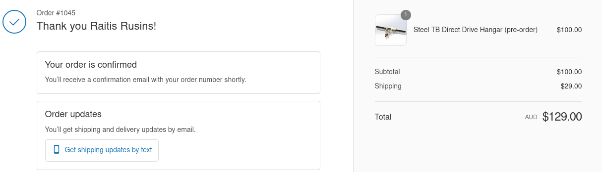

[Order Placed] TBDD CNC STEEL Hangers

Its up to you guys to make this happen! Needs to hit MOQ of 8
Nice work @Tony_Stark :partying_face:
Yep. I’m in for two!!! Thanks @glyphiks for putting this thread together and @Tony_Stark for designing and making it happen!

Don’t let the Australian dollar scare you guys! 129AUD = 82€ = 98$ USD
Edit: looks like that counter on the site doesn’t automatically update, lol
