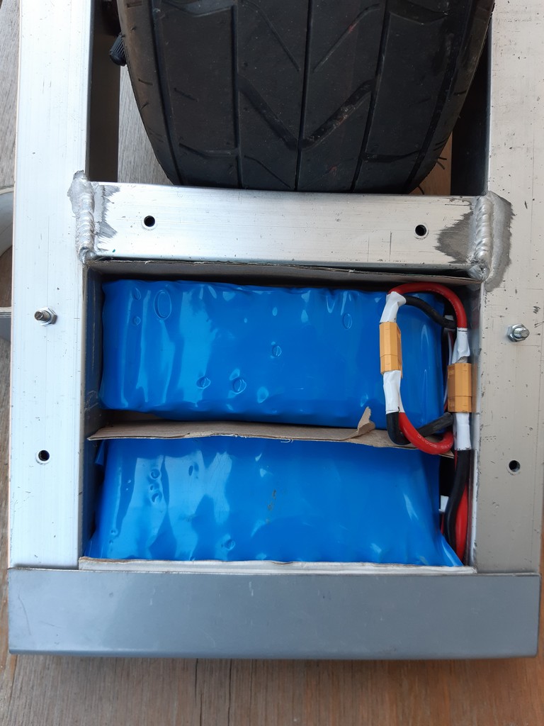

Yeah i could have probably made them better. But the errors or weak points will hardly burn down my house.
Put fish paper between the groups of batteries in parallel.
Good point, but how to glue the batteries then, also the pack will end up much bigger.
Put fish orings on the + ends
Takes alot of time and in my opinion not really necessary. The batteries already have a o-ring on them and i have never seen one rubbed trough
Route balance wires so that they are not on top of each other. Use kapton tape to secure routing. Place a line of fishpaper where the wires will rest
As i said im not worried about balance wire trouble. They are awg 30 and in the worst case they just burn up.
For+ and - main leads, don’t solder them directly to the battery (see video of how he did it with a little tab and fishpaper where it rests on the sides)
I use a 100w soldering iron and the contact time is very short and not directly on the cells. Also a external tab would create another weakpoint on the battery (i like to be able to hold my battery at the power leads if i have to)
Once battery is done, wrap with kapton tape.
Why? kapton tape is good for holding things down and is very heat resistant. i never heard about its abrasion resistive capabilies
Optionally, I’ve seen some people put a layer of foam
Wrap in the heat shrink
Good point, i should do that with all my batteries. Im looking for something like a large glass fiber tube that i can put under the heat shrink.

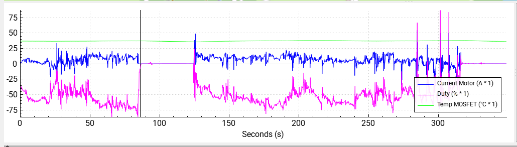

Still my onewheel threw me off 3 times today. It just plunges foreward, its not the tiltback it just happens randomly. I recorded a logfile while it happend twice. Maybe you can see something i dont?
onewheel_log_3 - Kopie.csv (1.1 MB)
onewheel_log_no_loc.csv (301.1 KB)
Just getting mine up and running. With the USB plugged in, I was noticing I can get it to go to the dead just by moving back and forth aggressively. I don’t see the duty cycle spiking above 94% (what I have it set to) but I think that is the only reason it would get in the dead state. I set it to 99% which it can’t get to and I don’t have that happen anymore…

Yes that could be it, i found that after a crash i had to reset the board by unplugging and then replugging it.
Is duty cycle the only value that brings it to a dead state? Maybe its possible to keep this safty setting by adding some overspeed delay?
