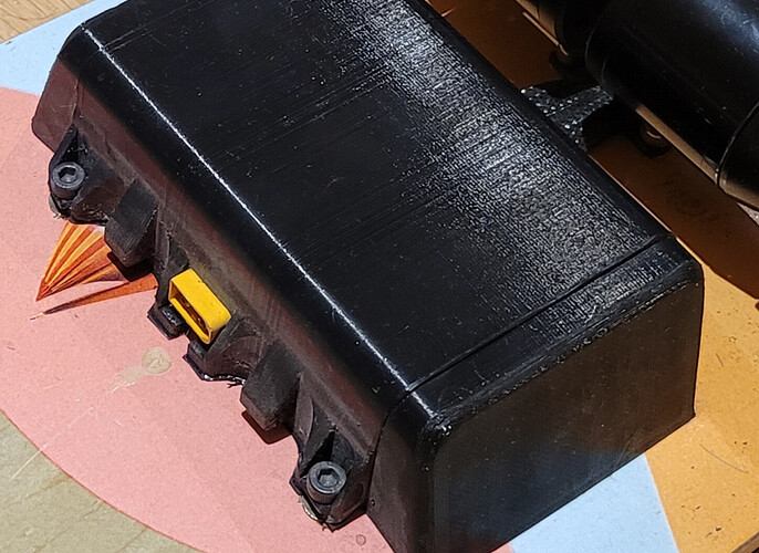

Nice I’ve also played with this idea on and off over time, very well done. Suggest getting on the tpu for some of these parts or at least for little soft spacers for things. Tpu is small nightmare to get working right but once printed the parts are typically very durable.
^^ those are my doing, the black is tpu on the longboard for the battery/bms. Orange is petg, with the straps eating some of the energy from impacts etc. it works fine but not nearly as pretty as yours :slight_smile:

Is that a harder TPU? I’ve never played around with that material before. Once I found PETG I went PETG-only. That would be a pretty solid replacement for the foam underneath the batteries. What TPU do you recommend?
And yeah that’s like the same exact thing! I like the straps, that looks pretty quick to swap. Plus then you don’t have to worry like I do about the battery completely falling off if the thing decides to break on you.

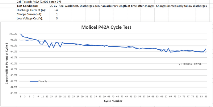

Please update us on what he says! I’m going to increase it to 12A regen per cell and I’ll update this post with what the capacity drains down to after a few hundred cycles. Thankfully with the smart BMS I’ll be able to (somewhat) accurately track the number of cycles. I might log the data over time too, we’ll see.
I can compare this to another P42A cell I’ve been cycle-testing in my spare time. It’s only cycled at 0.4A discharge to 3V and 1A charge so the comparison between the 40A discharge to 2.7V and 12A pulsed charge with 4.5A continuous charge on this pack could be interesting. So far I’m 86 cycles into the single cell test with a relative capacity of 94.5%. I’ll update this post with how it performs over the long run alongside the stressed 12S1P pack updates.

Ah sorry, I just meant TPU itself not something different was just typing on phone. I used some from hatchbox TPU it’s not super stretchy but definitely flexible enough and if you make the walls 3 thick then it’s pretty rigid but can take some blows and will flex around still with screws a bit instead of cracking (I also tried the battery box in PETG at first but cracked where the bolts/screws hold it into the deck)

Sweet thanks, I’ll check that out. Hopefully it prints okay with a bowden extruder…
I had a lot of cracking when I first starting printing enclosures in PETG when I had the layer plane parallel with the deck. After I starting printing them like they are here I haven’t had issues because the walls are able to flex instead of the layers flexing and shearing apart. I also make sure that the bolts hold the enclosure along the length of the deck which also allows the enclosure to flex.

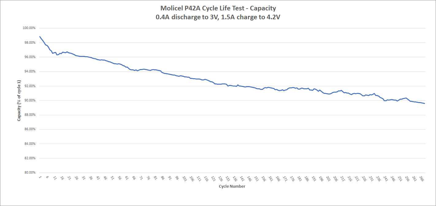

Update on my low-budget, low-stress cycle life testing of Molicel P42A:
Honestly idk why I did this but I find it kind of interesting even though its results don’t really apply to esk8 whatsoever.
Test conditions:
  • Charge current: 1.5A to 4.2V, 0.1A cut
  • Discharge current: 0.4A to 3V
Currently at 275 cycles and just under 90% capacity of initial discharge (initial capacity was 3757 mAh).
It seems like 500 cycles to 80% is likely. I’ll probably stop the test at that point. This is less than Molicel rates it for in the DS (500 cycles to ~85% at 20A discharge to 2.5V and 4.2A charge) and what other have measured (1000 cycles to 75% at 20A discharge to 2.5V and 2A charge).
I think there is accelerated decay of the cell I’ve tested as each time it is cycled I have to manually restart the test. I restart the test each morning, and each discharge/charge cycle takes about 11.5 hours. This means that the cell has sat idle at 4.2V for more than half of its life.
So I guess what you can get from this is that to get more life out of your packs, make sure to only charge them before you use them, and not right after you’re done using them. This limits how long they sit at 100% SOC, where the cell seems to degrade a lot quicker. This isn’t anything new, and I think most people do this already, but its good to see the data to understand why you’re doing it.
