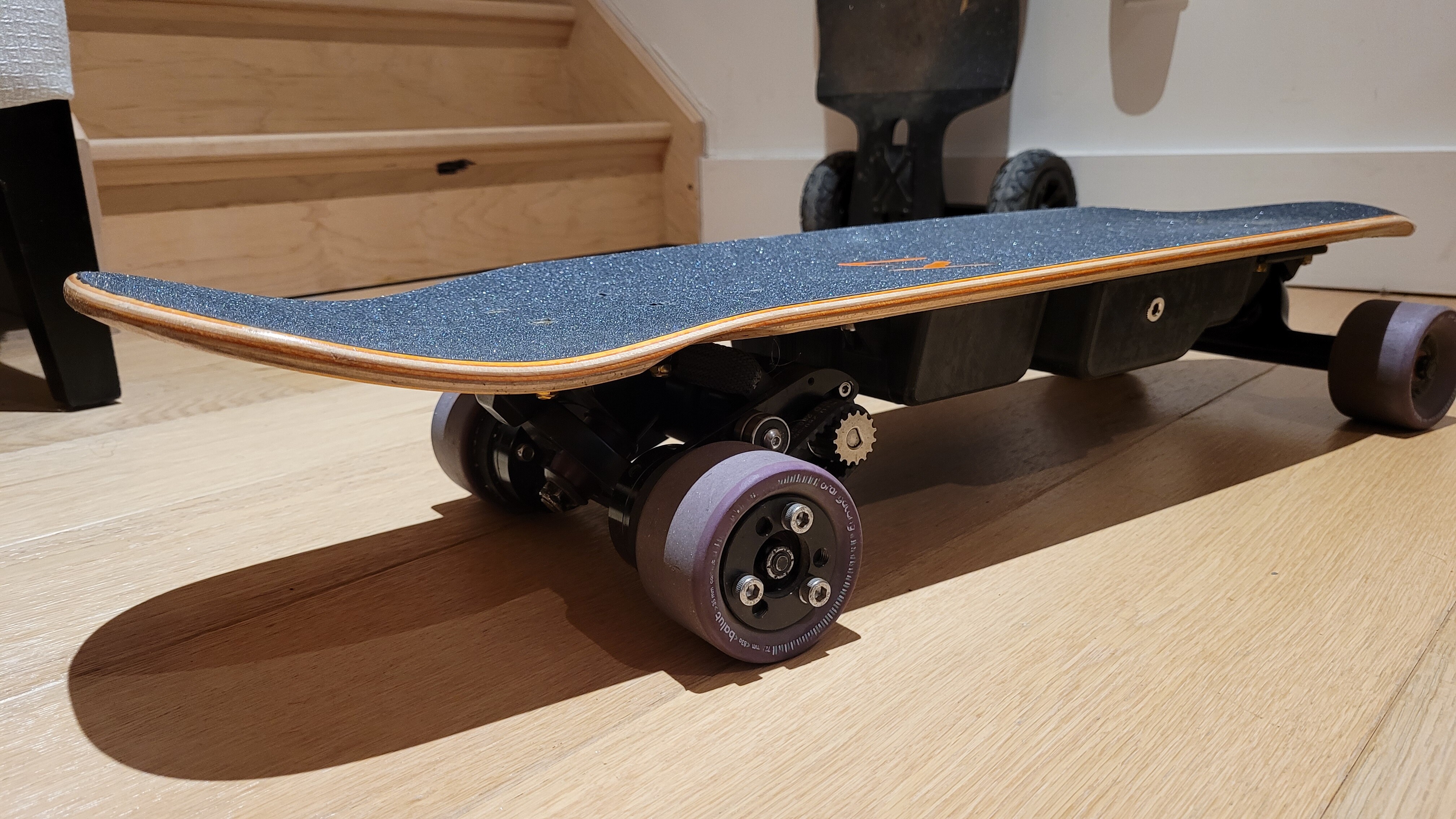

I thought I’d start with this board as my first documented build, since I’m really happy with how it turned out.
Just before this I’d finished up with my 2WD 6374 12S4P P42A build and decided it
had more than enough power and was pretty heavy. At the same time I started hitting up the skatepark with a buddy and I decided I wanted an electric skateboard that had enough power to pull me up the halfpipes, was as light as possible, and had a swappable battery so I could take it on longer journeys if I wanted. I went with 12S because I had a 12S 4.5A charger already for my other board so I wanted to reuse that. Also I’ve never seen a 12S1P before and I knew it could be done with the power that the P42A can put out.

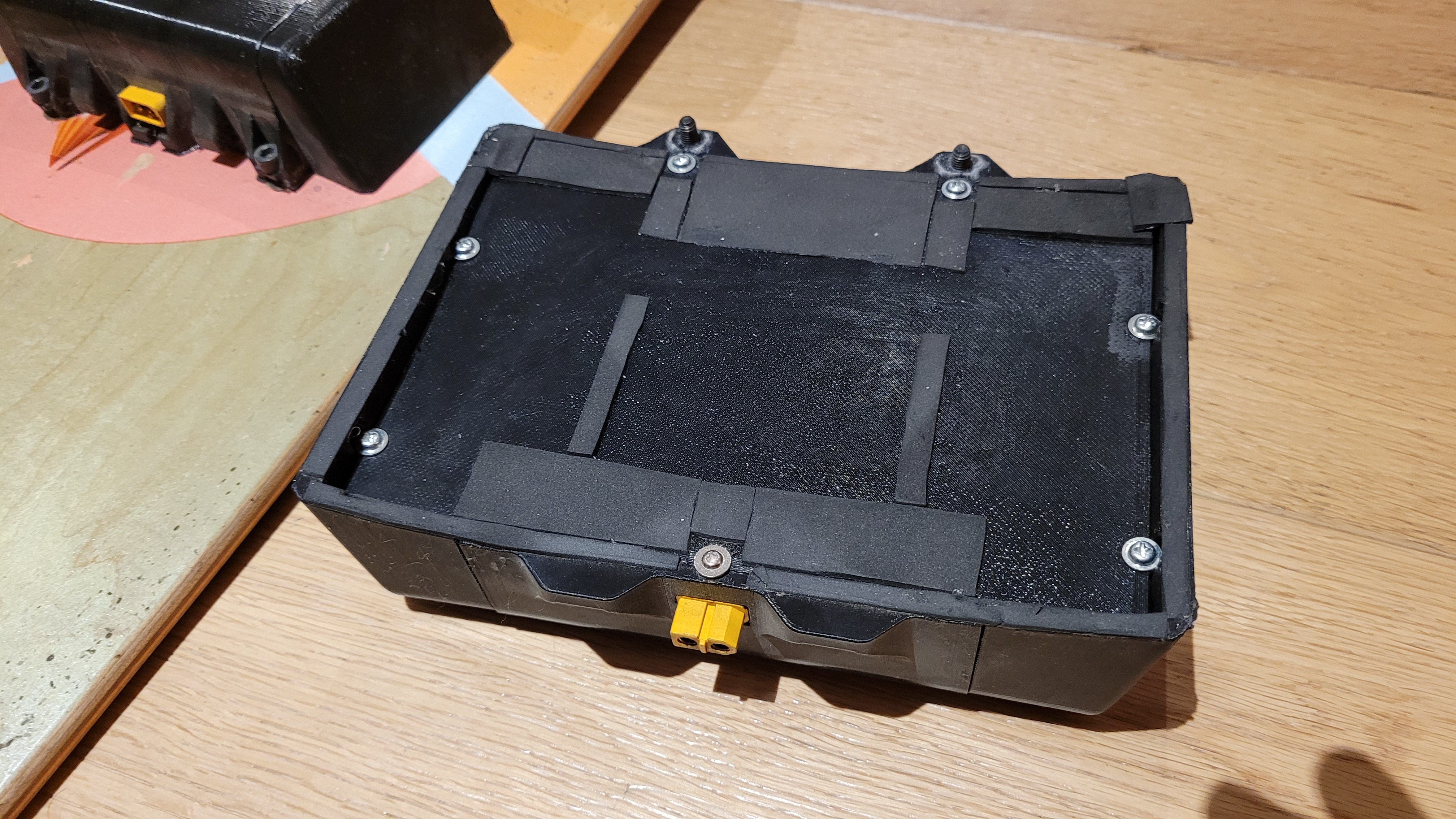

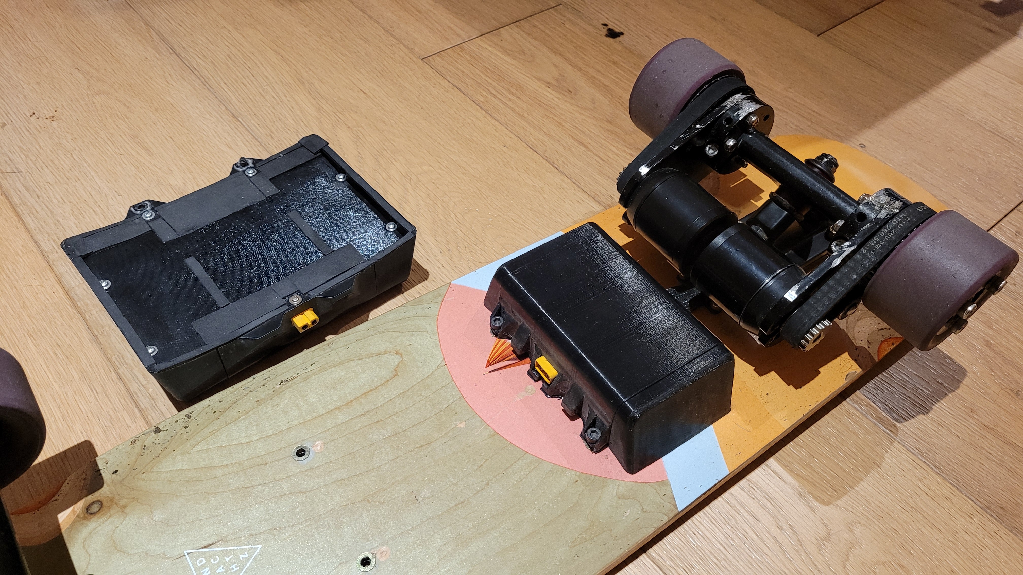

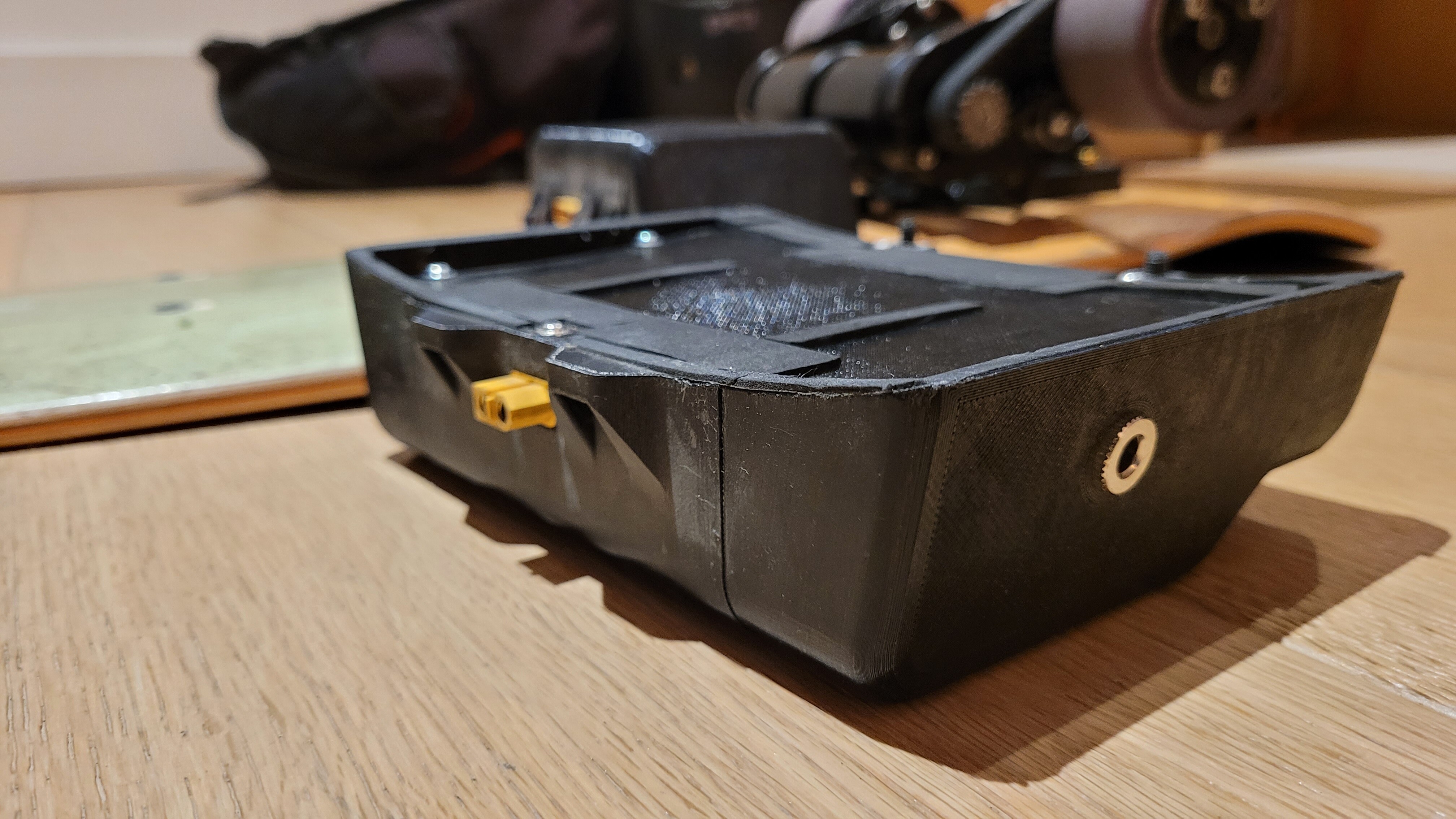

  • Swappable in a 3D printed enclosure (latches in by slots in the battery enclosure together with the XT60 port on one side and 2 M5 bolts on the other side). Each battery pack has it’s own charge port so I can charge one while riding the other.

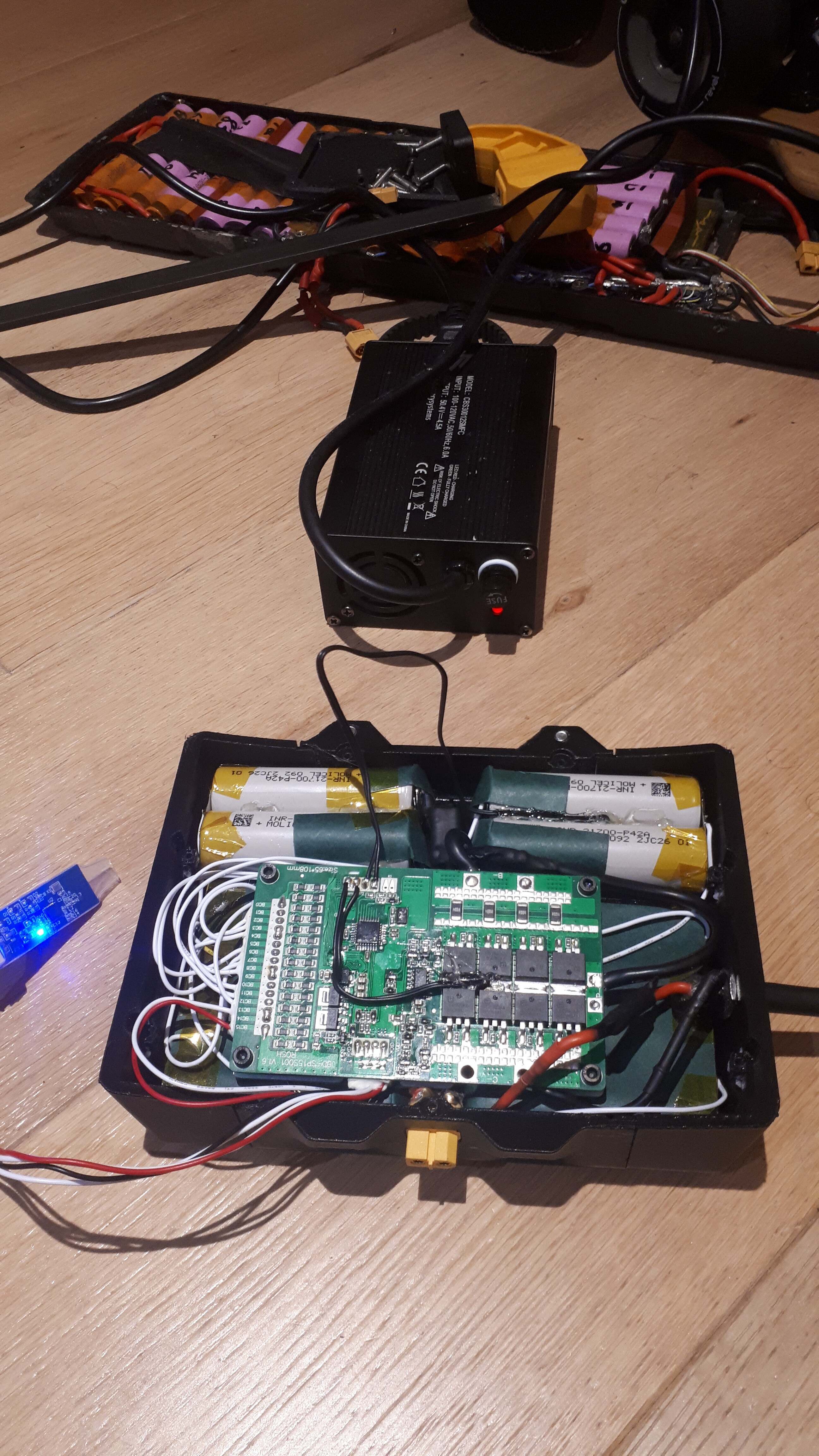

  • BMS: LLT Power 12S 60A smart BMS running unbypassed. I’m only going to use this BMS from now on because I love how configurable they are. It’s Bluetooth, so I can monitor the voltages of the cells at any time, and it has two thermistors that I use to measure the temperature of the cells and the BMS itself during charging.

All in all I’m really happy with it. It has plenty of torque. Probably too much for such a small board with a kicktail. I find I go into a manual quite often when I accelerate too hard. Surprisingly there is little sag though, probably because I set my cut-off voltage down to 2.7V per cell.
I’ve taken it to the skatepark and I’ve been loving how it performs. I purely ride bowls and halfpipes and this board has enough clearance to get over the lips of the ramps and most other things. I don’t street skate, so I don’t do any tricks on it, but I let my friend borrow it and got him to ollie it at the park. I’ll attach the video below. Next I have to get him to kickflip it.

The interlocking enclosure isn’t perfect. I definitely need to redesign the VESC enclosure to support the battery better. I thought I designed it well enough, but I’ve noticed some cracking near the bolts. I superglued it and it’s been fine since, but ideally it’ll need to replaced so it can better support most of the entire weight of the battery.
Also yeah each battery pack will have it’s own smart BMS. I only have one battery right now though. I’m waiting on the second BMS to arrive before I build the second.

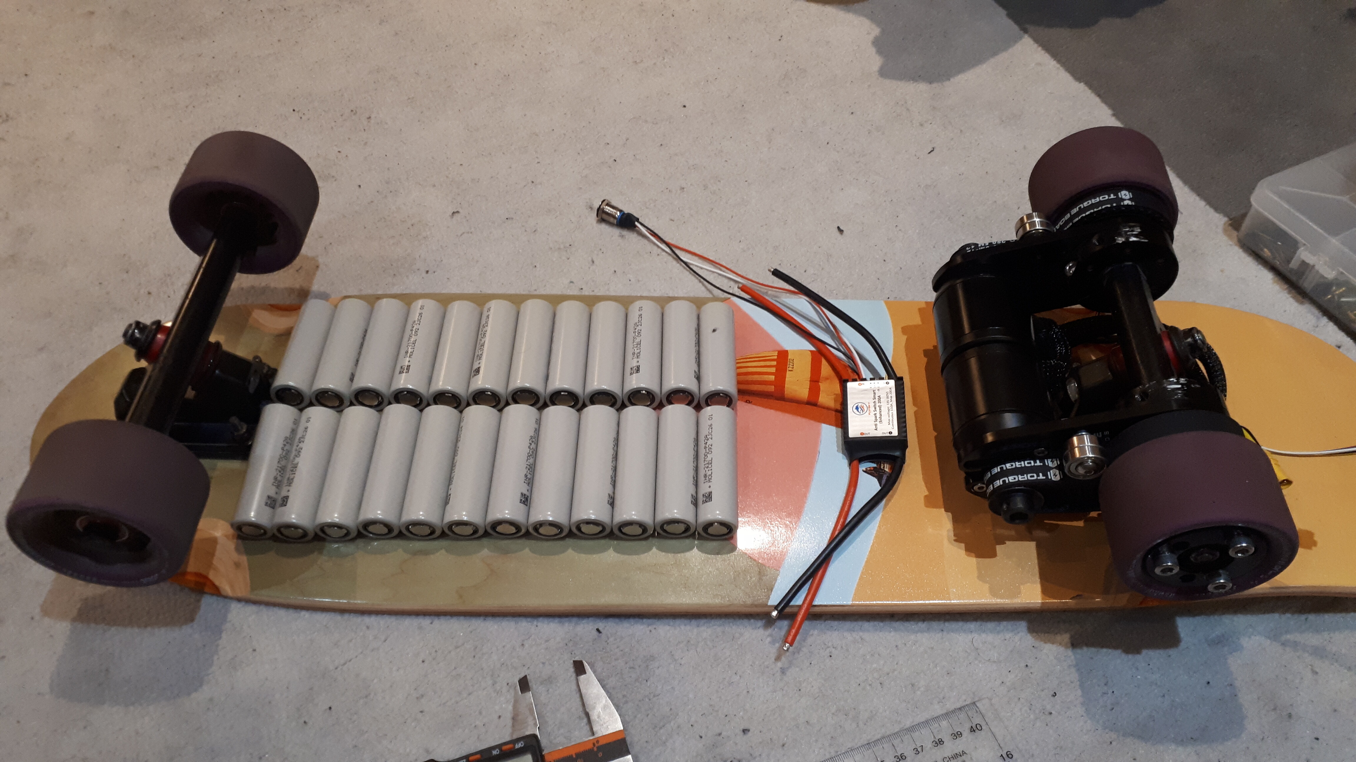

That was the plan originally! I tried to get it to fit but I decided that it couldn’t be done with a 3d printed enclosure. 12 cells long is more than the build height of my printer (250mm), so I would’ve had to break the enclosure into modules or made one long enclosure that was using a few connecting 3d printed parts, which I thought would be a bit flimsy.
Then I thought about making a swappable battery which imo is the best solution, because if I want I find the time to make the second battery pack I can carry a 12S2P around with me.
It was a tight fit with 12S2P:
