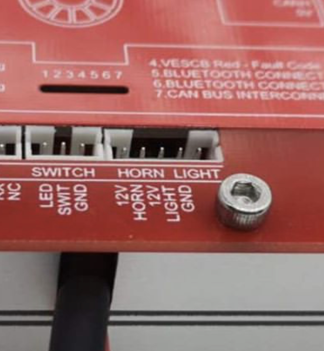

the remote on/off function works?
I didn’t fully understand it’s 12V 3A shared output? Or 3A for each channel?
I think single output, it’s a 12V 3A output. Good for lights. At least by the pictures I only see a single output
There is one for horn and one for lights.
As minimum that’s how I understood it.
Ah yeh right. Don’t know can be shared too. On the same output looks easy to be shared.
@rey8801 it’s confirmed that it is 3A combined so 1.5A per output.
Ok good to know. I don’t need an horn vesc controlled but light for sure. Anyhow 1.5A is also good for good 12v leds
huh? what’s ā€œhornā€ about? does vesc have code to dynanically control a horn under some conditions? is it like a fault alarm? or a hey get out of my way horn?
or is is just power pins?
I would guess the difference between the output ports is that one is switched permanently (the light) and the other just momentary (horn) when triggered.
so hooking up lights to the horn port, we can get strobe mode? :thinking:
does it have support for an extra remote channel/button push or something? that how you trigger it?
I would guess so, but could be wrong. It’s not written in the specs.
I think it probably works with their proprietary remote

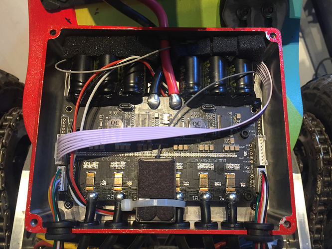

FSESC 6.6 DUAL is good.
FW5.1 no_hw_limits and APS80100, 120A battery and motor max.
Max current 87A ; Motor max current 143A ; Max ESC temp 45°C in summer.
I have four other ones on various builds.
You can rely on this one.
Update 20/08/2020 : I found even more (it was in march, less hot)
