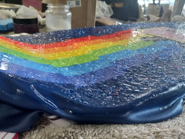

  • Glass frit with Nyan Cat on the deck!

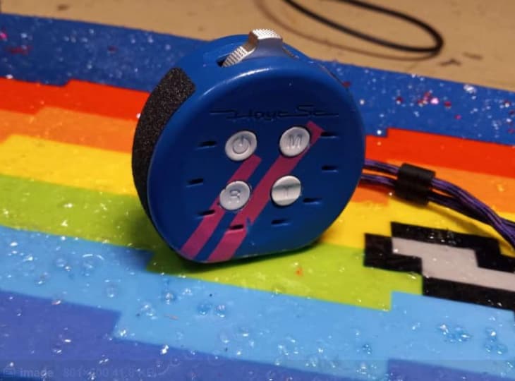

Since I’m still waiting on a lot of parts, I took the time to (somewhat badly) paint my Hoyt Puck, as well as swap on a more fitting color of paracord onto it. I’m most likely going to swap on a puck puck bruce case onto it down the line, but I’m actually pretty happy with the stock case for now.

As you’ve probably noticed, all of these parts are color matched in pink/blue/purple. The reason for this is of course Nyan Cat, the theme for this build. I’m planning on painting the edge of the FluxMotion deck, as well as the enclosure to match the theme.
On top of all this goes
With of course some glass frit + epoxy.

Definitely sounds like it’s about to be a beast. Love the nyan cat theme and paint job so far. If you want to try again I can send you an og puck case and buttons.
Hey I super appreciate the offer! I think I’m good for now though, the scuffed’ish paint job doesn’t bother me that much. :heart:
