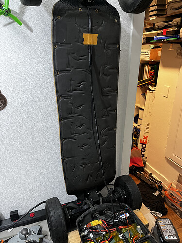

Opening her up to connect the cables and do an inspection, everything looks in shockingly good condition for how many miles she has.
re-routing the switch through the new hole also meant that it’s long enough to not need to unplug it anymore when going inside the enclosure, which is nice.

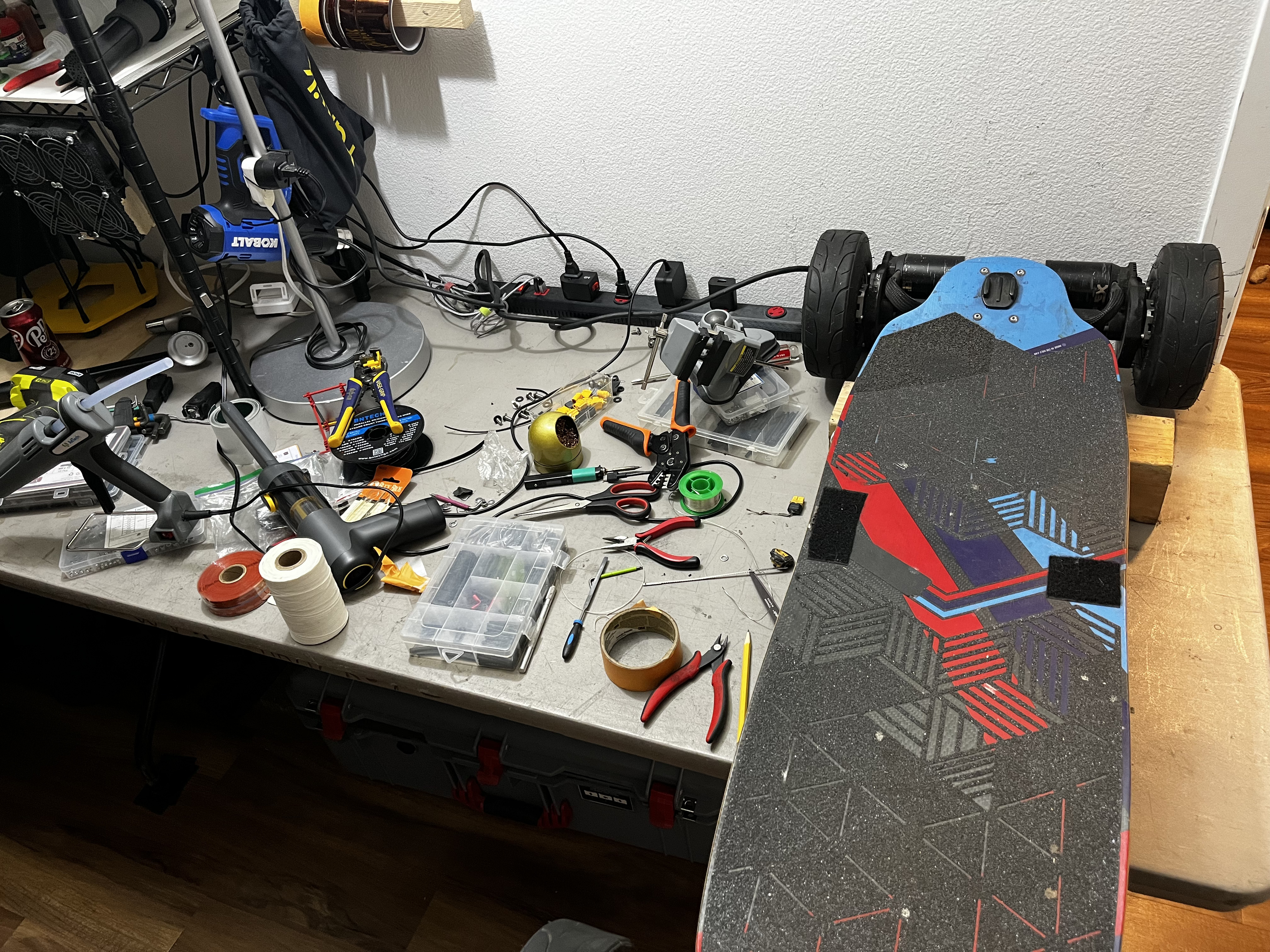

There’s something profoundly special of the state of a messy workbench at the end of a task
Approval from the on-duty inspecator
