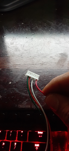

running it in Uart
im not to uptodate with the lingo sorry m8 but im pretty good with instructions, split the ground wires an canbus i don’t understand is that in the vesc tool
CANBUS is a communication protocol to allow one ESC to tell the other one what the throttle level needs to be. You remote connects to just one ESC.
You’d need to run a physical wire for CANBUS to work.
OR
you can run a PWM wire to both receivers
oh shit i could prob do that, like use a knife and cut the 2 out and run it to the other vesc
like the wire it ships with
so just cut the red ppm wire and out and run it to the other (slave vesc) and it will work
This isn’t on your VX2 right? The VX2 does not have PPM…
No, that’s UART. Don’t cut any of those
You’ll have to use CANBUS if that’s all your radio receiver has to work with
For CANBUS you will need an additional cable to go from one ESC to the other ESC

Help plz, got the vx2 remote but it only works with what ever motor the reciver is plugged 2⁚, made sure the slave was 1 and master was 0 any ideas
