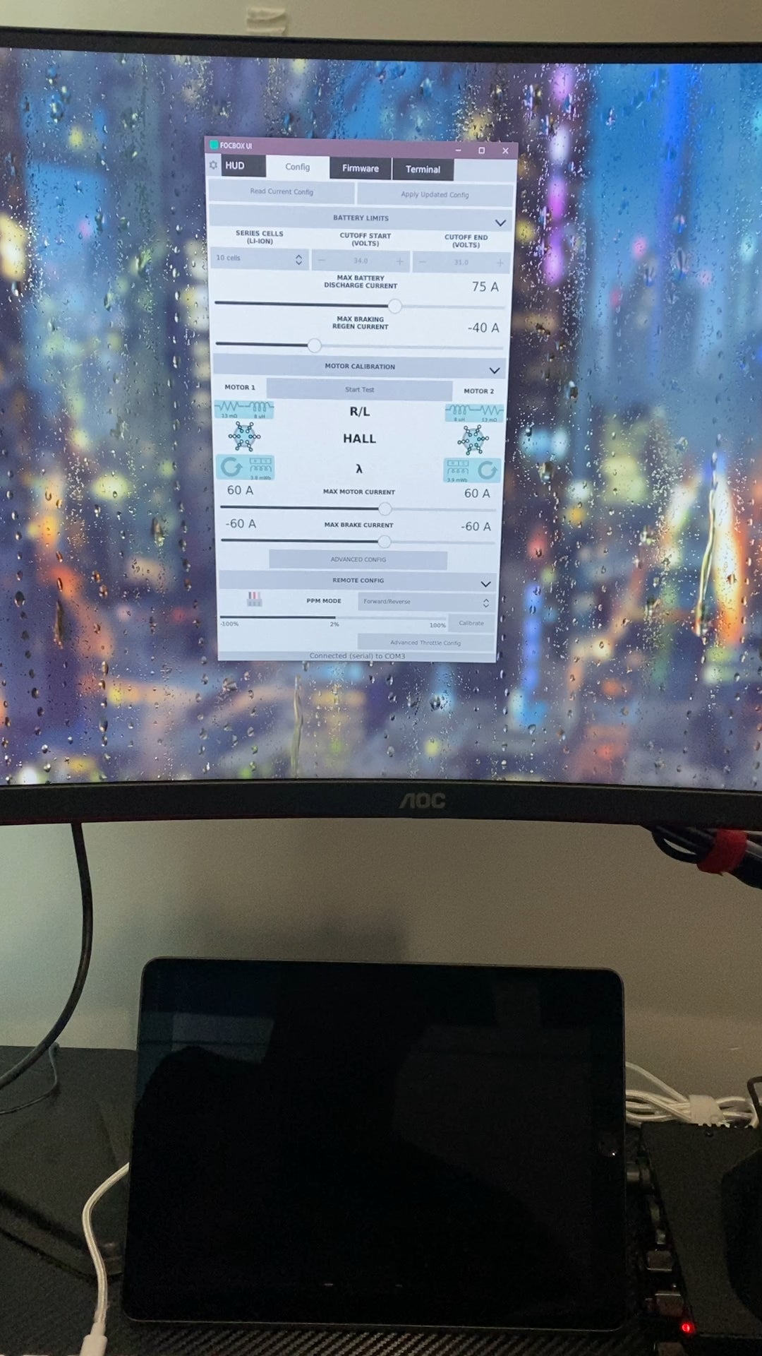

Be honest, how was it left? What volt battery was it connected to? How was wiring management? Were all connectors shielded?
To be fair, it is flipsky. And even though they have stepped up their game, they still do have product that sneaks through quality check and just die.
Try for a replacement. If they dont give it to you then get the refund.
Also, what antispark was it?
12s battery
wiring management was pretty decent (quite a lot of wires but all quite tidy)
all connectors shielded properly
the switch light keeps turning on by itself (i turn it off and then it turns back on like 5 seconds later by itself (it doesnt turn off even when the switch light is off though))

Your VESCs have too much capacitance, they are triggering the roll to start on their own. You’ll have to return it

It’s indeed the too much capacitance. This can be fixed with a simple circuit. All you need is a 5V Relais and a couple of resitors.
@Blise518B did it like this:
