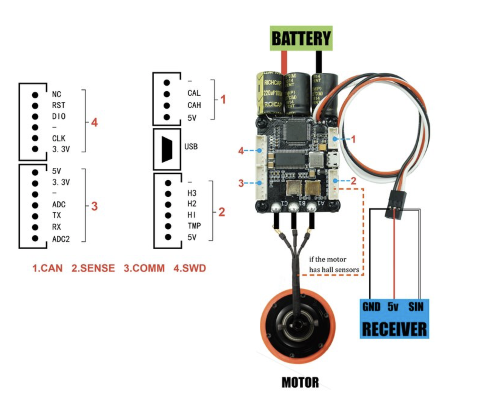

are there any uses for 1,3,4 ports?
Port 3 is for your controller’s receiver.
Only if it’s a UART or ADC controller. The PWM/“PPM”/Servo controllers go to port RECEIVER.
1 is CANbus - Chain multiple ESCs or other devices together for control, telemetry or programming.
2 is hall sensors, motor temp sensor, and/or encoder - For more precise motor control.
3 is I2C/UART/ADC - Some remotes, as well as telemetry use this.
4 is programming/debug - No touchy!
