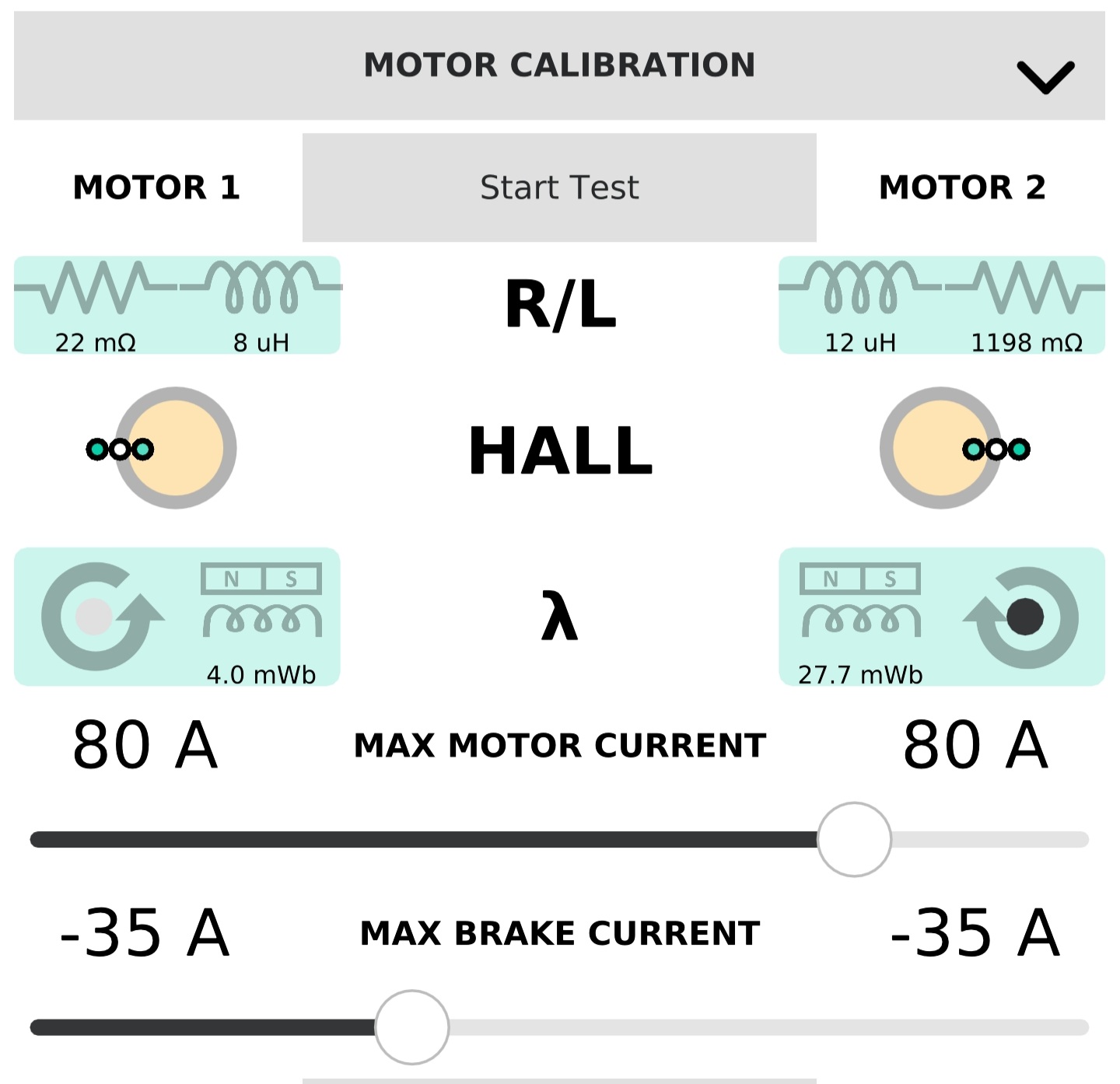

I don’t recall any issues with that, but I did try unplugging the sensor wire and ended up with a new issue: the same stuttering with low throttle, but randomly it’ll spin the wrong direction. Went to the unity app and tried motor setup and these numbers don’t look good focussing solely on their differential, though admittedly I have no idea what I’m looking at.
Haven’t gotten around to that, but may try that next.

1198mΩ is not right. Swap the motors, rerun detection, and see if the weird readings swap sides on the application.
