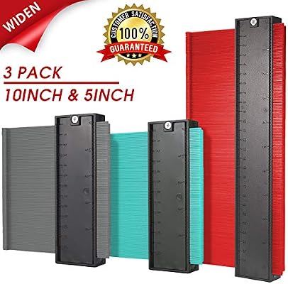

I did a similar thing with just printing some guesses at the curvature after measuring with calipers and worked out alright more recently got this thing that might help with figuring out more accurate curves but still think test 2D print and cut out of CAD then slices of the 3D model printed for test fitting is probably the best way.
the problem is it’s not for me so i can’t test it
