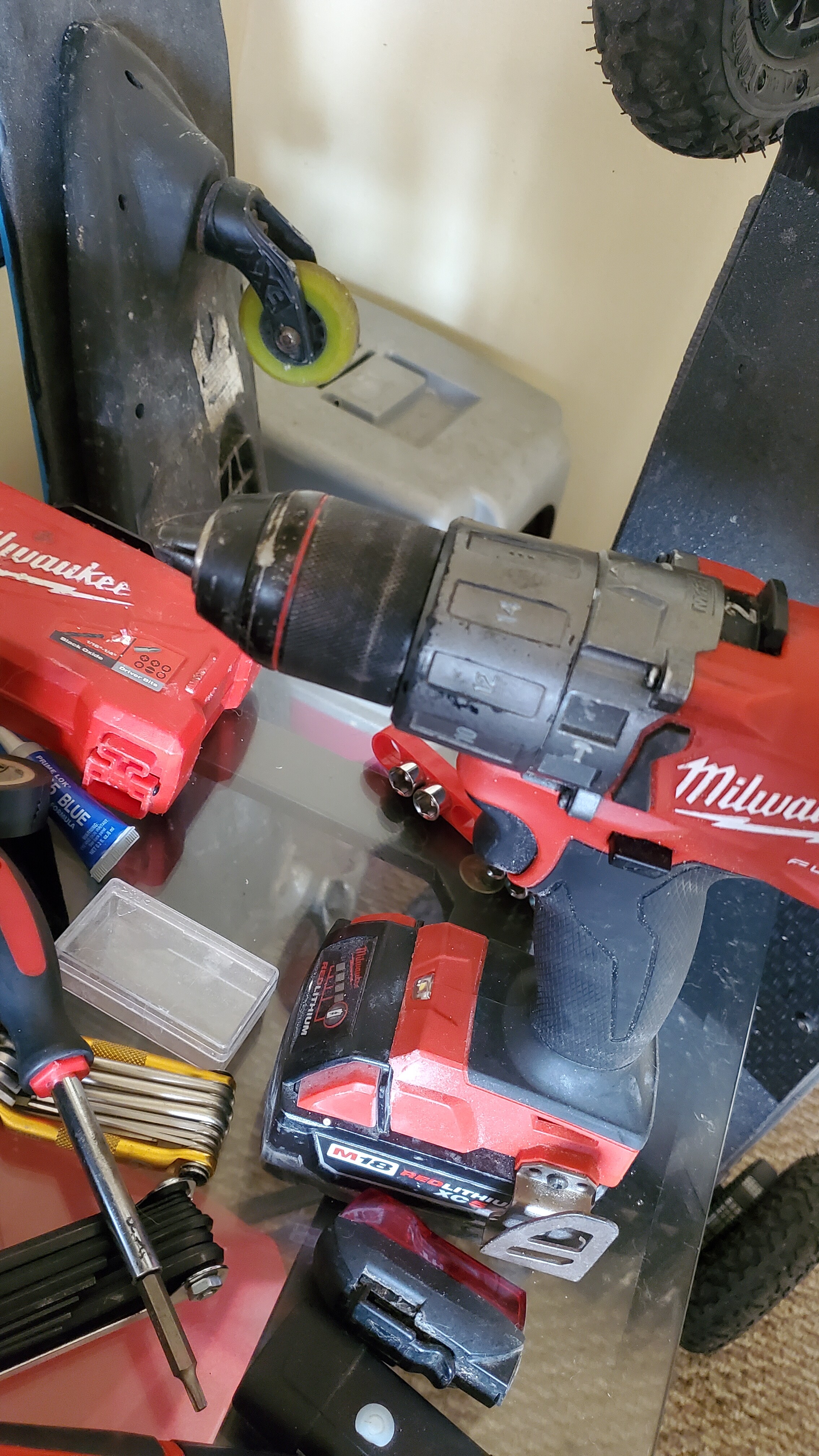

got an electric drill thingy? clamp the shaft to it, and see if there is any wobble?

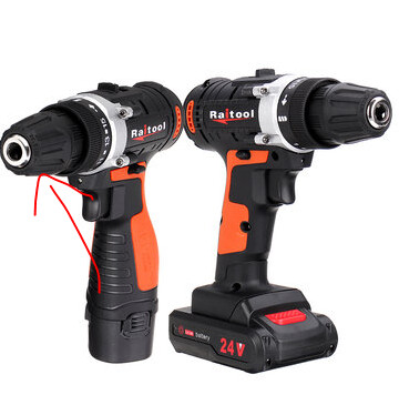

I think he means do you have a drill that clamps? Like a hammer drill or one of those drills that can hold different size of drill bits. Like this guy:
yeah got a hammer drill
i should jsut clamp the shaft and see if it spins straight or wobbles?
Correct.
u got the motor can off right? stick the shaft in an electric drill, tighten it a bit so it won’t go flying when u power it on, put the drill in weakest mode, then see which part wobbles when the motor can is spinning. got no video showing it tho

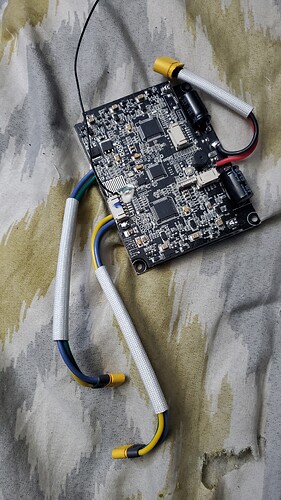

That chart is handy but maybe not useful here because as best I can tell it assumes a longer length and a specific acceptable voltage drop. Small wire has a higher resistance per unit length so in the same way you’d be safe to drive after a droplet of vodka, the resistance of a small wire can be fine if the run is very short (like 5 inches)
With that said it looks like 5A dissipates half a Watt even at 2x5" so I’d recommend a good bit bigger. 18AWG cuts it down by a factor of 4~5 and still isn’t really big and cumbersome
