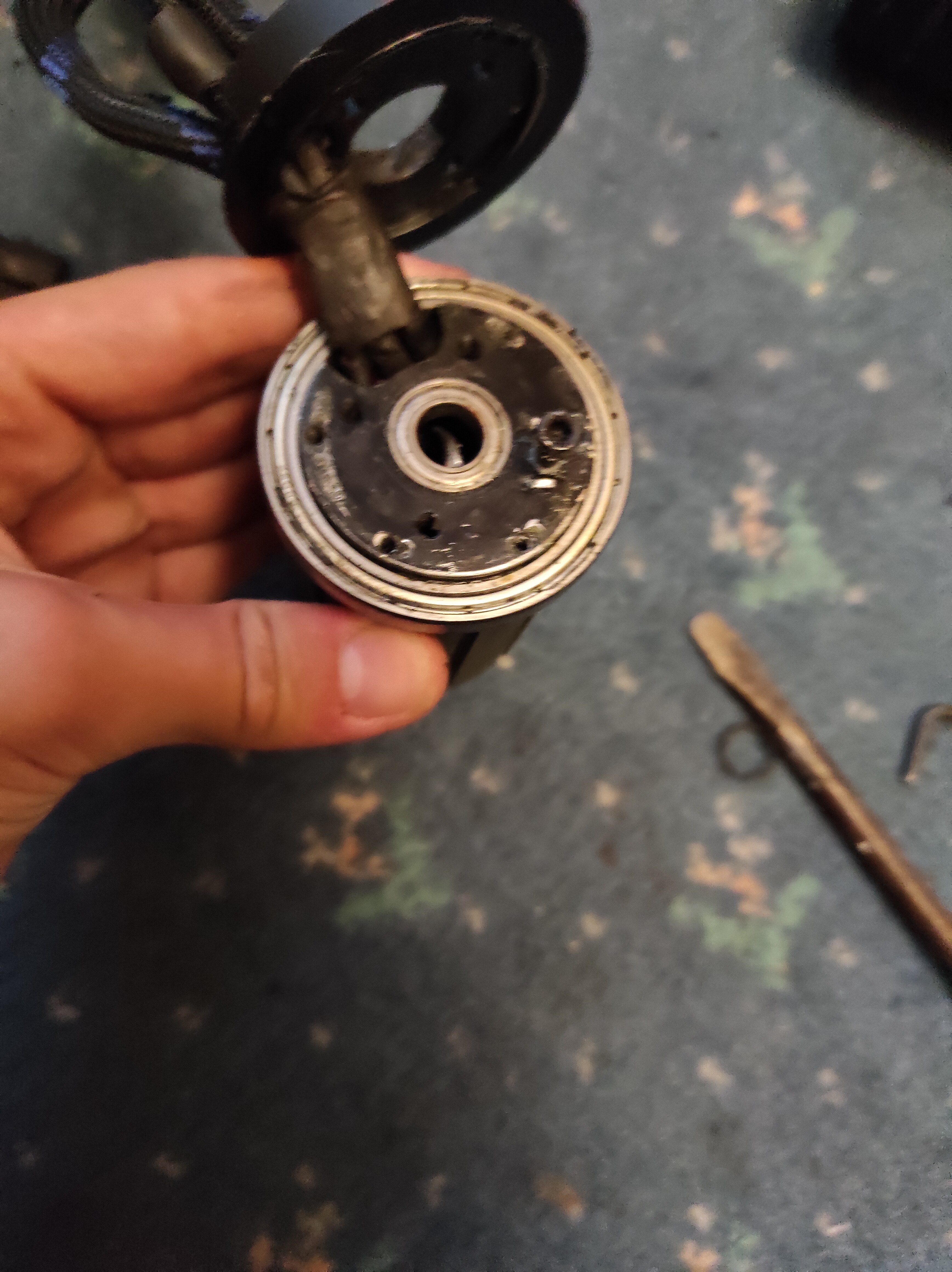

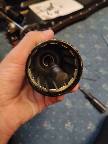

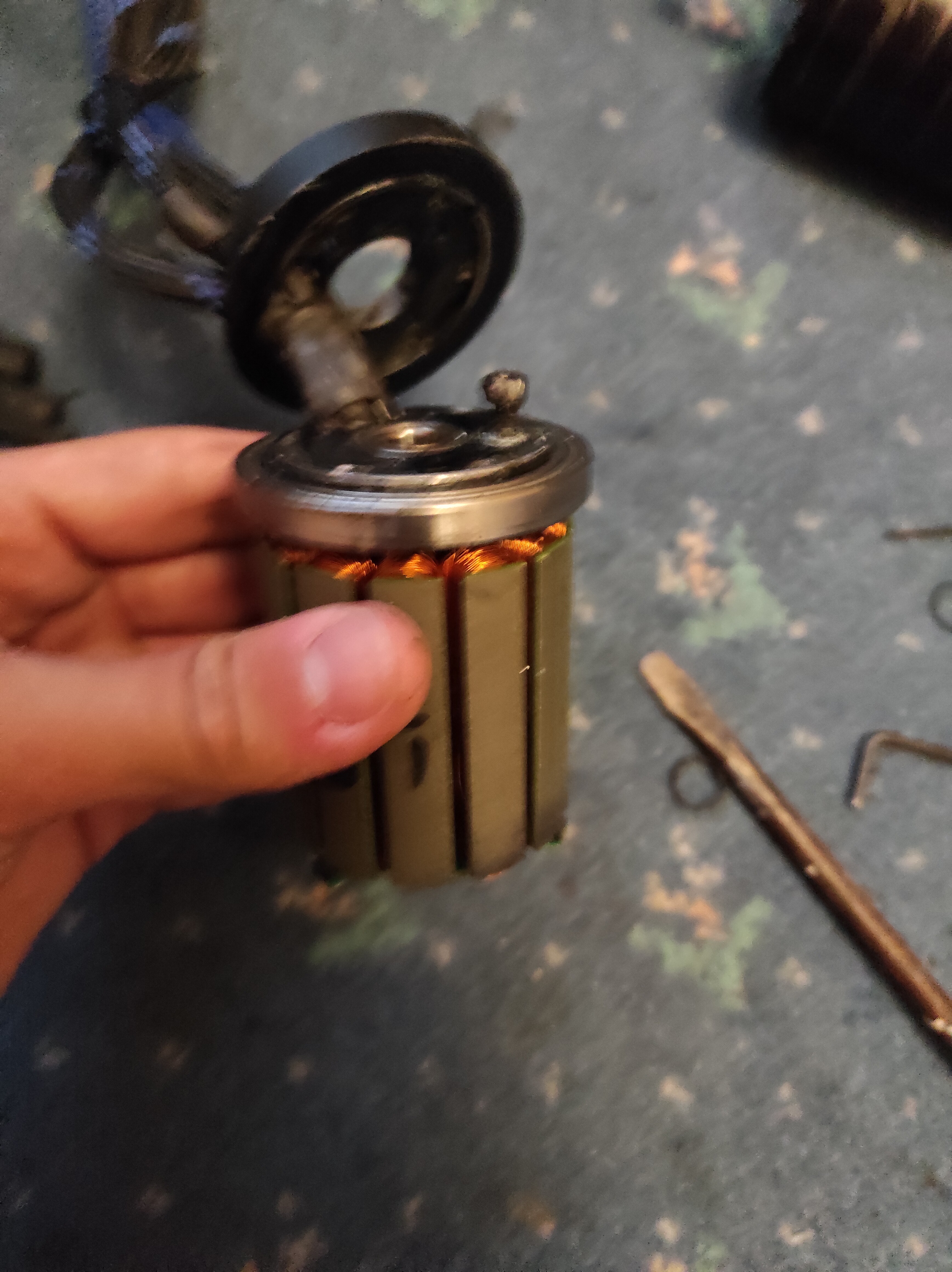

gotta my motor open
not sure what im looking for now to fix the issue though.

Im not sure if I helped anything, but check if ur shaft run true with the can?

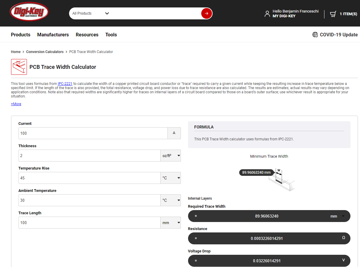

Does anyone know if the “Temperature Rise” field is defining “30ºC increasing TO 45ºC” or is it saying “30ºC increasing BY 45ºC”? I feel like a moron not knowing what that field defines.
@Battery_Mooch @DerelictRobot @shaman
Edit: After reading a bit further, it seems like that value is defining how much the temperature will rise BY not how much it will rise TO. Can anyone else confirm that is consistent with what they know of these calculators?
It’s ambient temp + rise temp. The calculation needs ambient temperature as the baseline to determine how much the temperature will rise at X amp/Y conductor width. So, BY, Felicia.
That make sense?
I agree with @DerelictRobot, it is how much the temp will rise BY. This method avoids having to take the starting ambient temp into account, which causes all sorts of confusion when considering final temps under different conditions.
Ambient Temperature + Temperature Rise = Final temperature under those conditions.
@DerelictRobot @Battery_Mooch thank you both!
