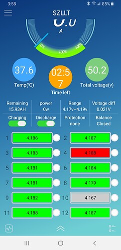

using llt smart bms. noticed that my cells flicker like this sometimes. anyone know what these colors represent?
is it something to be concerned about?
I think that just means those are cells are being drained since they have a higher voltage than the rest (it’s balancing, if I’m correct). And the red/Grey sections show the highest and lowest voltages a group has in your entire pack

The red and grey cells are just indicating your highest and lowest cell, nothing to be concerned about unless they are really far apart.
Your voltage spread there looks probably fine, though the low cell is a bit too low for comfort, especially since most of your other cells are nearly perfectly balanced.
so how should I fix it? should I just leave it plugged in and see if the bms balances it out?
That’s a good first step, yeah.
If that doesn’t help, a next step would be to manually charge that one cell group back up close to the others and see if the BMS will keep it there.
