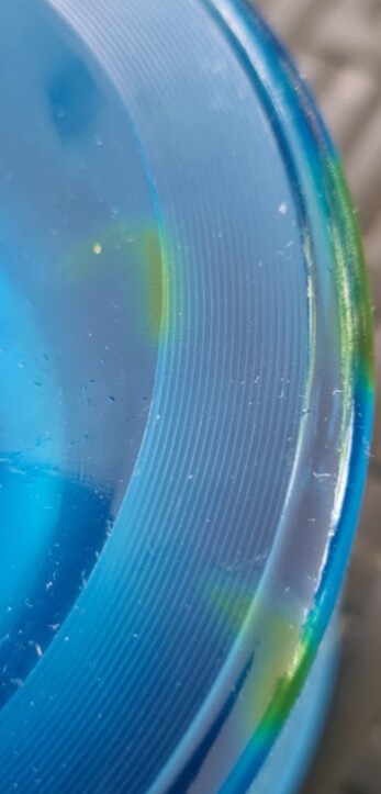

Okay guys, I don’t understand. One whole set of brand new TB110 were waiting in my closet for the build, away from sunlight or any chemical. Two of them, on the same hanger became really discolored on some spots.
I’m 90% sure there was no discolorations some weeks ago. The two others wheels of the set which are on the drivetrain and were stored the same spot few milimeters away, are spotless.
Any clue ?

If the wheels were sitting on anything, did the colour transfer to that surface as well, or to a hand/anything else that has touched them since? The only type of discolouration I’ve seen on polyurethane is yellowing, but it’s apparently a huge family of chemicals so idk what TB uses for the semi-transparent blue. The mechanism for discolouration is usually UV-related oxidation, you mentioned it was kept away from sunlight so my guess is maybe in transport/other storage those ones were e̶x̶p̶o̶s̶e̶d̶, blasted with UV but I don’t really understand so not sure if that holds any water
Just checked, no color transfer anywhere… Also tried scrapping the spots with my nails, nothing.
I wonder if I had some loctite stains on my hands last time I moved them. I just put a tiny spot of 243 near a bubble to see if anything happens during the following days.
