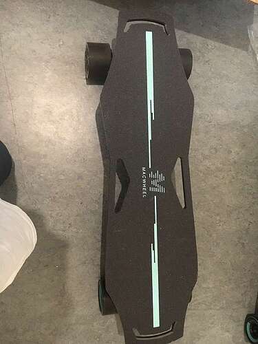

I found a deal on an Austrian website for a defect esk8board for 150€. The owner states that it just worked for two hours than it shutdown. The esk8’s brand is imacwheel. Searched for it in the forum but there was no single result for it. For those of you who can speak German or wanna see some pictures of it here is the link: Will teilen:
So my question is: Do you think that’s a good deal or a total waste of money?
If you’re planning to change the esc and see if the battery isn’t at fault, then sure. That’s what I did with a pre-built board that didn’t work.
The question i ask is why he doesn’t send it back and get it replaced if he bought it just a week ago and was quite happy with it.
Yeah. Either the support is bad or he simply doesn’t care about money. OR the board is totally broken because of his unappropriate usage and he just wants to squeeze the last bit of money out of it

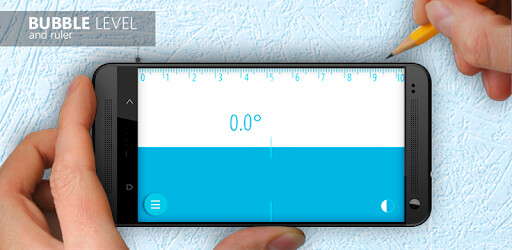

I am waiting on adjustable baseplates and an assorted bag of riptide goodies, if I change angles to adjust ride id like to know what +/- angle set up is best. which stock might be as they are there for a reason but I like messing with stuff.
If you have the deck in hand, you can use this app to measure the angles:
Just make sure you place the deck on a level surface to test it. You can also use that app to measure the angle of your trucks after any baseplate adjustments.
