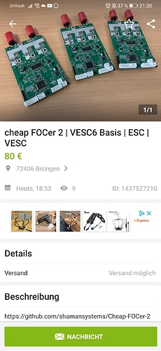

Is this a good deal? 80€ / pc
Not sure if you consider the Focer Group buy price?
Can’t tell you though if the ebay listing has things soldered that the focer kit hasn’t.
