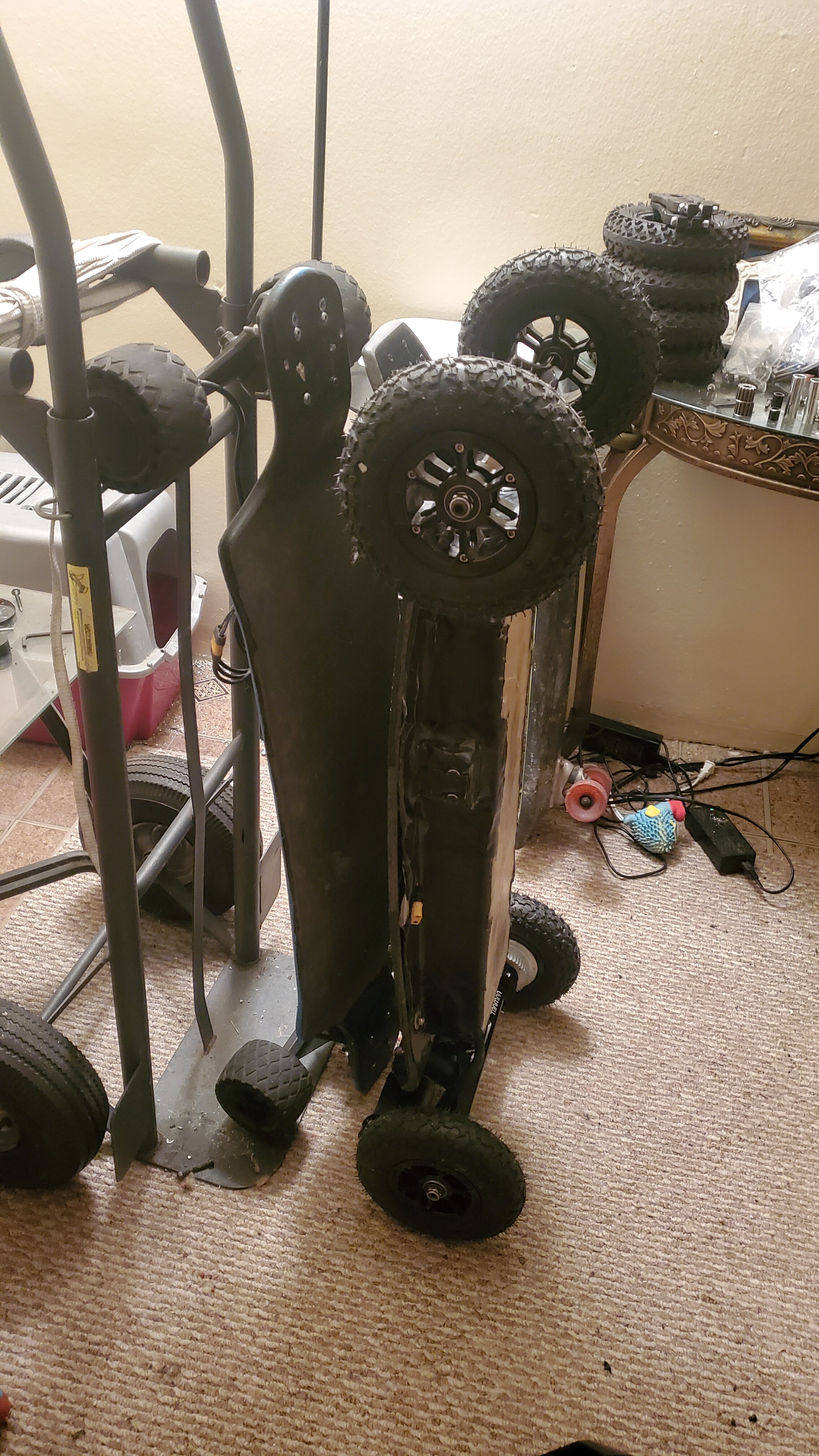

with 2cm currently they just scrape at full lean
with 1 inch it should clear fine
dont mind about look as i will sand and paint them
if you cna pick up some spare whenever you have the time it would be super kind of you
Making new truck holes actually gave me enough clearance to put the enclosure below it.
Thank goodness.

These are Samsung 30Q that I got in an mboards pack. I put 15 cycles on the pack, and found 6s2p to be shit, so I had artem reconfigure it into a 12s1p incase I needed to use it as a range extender for my upcoming board. In the mean time, I decided to throw it into this little thing as I had some spare parts from a broken prebuilt. The cells have at most 25 cycles
I’m only using this board for 2 weeks, so as long as -10A of regen won’t kill me its fine.
