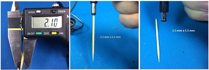

how do i go about to measure a dc barrel jack? 5.5x2.1 and 5.5x2.5 look too simliar and calipers doesn’t really fit in the hole
and no, i prefer not to mod the charge port because of aesthetic reason…for now
I want to know that answer too.
im gonna try this method when i get home tonight:
there is also a drill bit method, but i prefer not to stick anything metal into the jack even tho its not plug into the wall

Me too. Usually I just try if the male fits into the female, and that’s it.
Although, I think my eyes got trained to tell the difference by looking at the positive in the center of the female, which is thinner in the case of the 2.1 variant.
i would still prefer to have a close to 100% accurate method to measuring it, since 0.4 different is too small that even with two of them side by side, i probably can’t tell which is which
