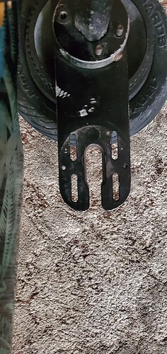

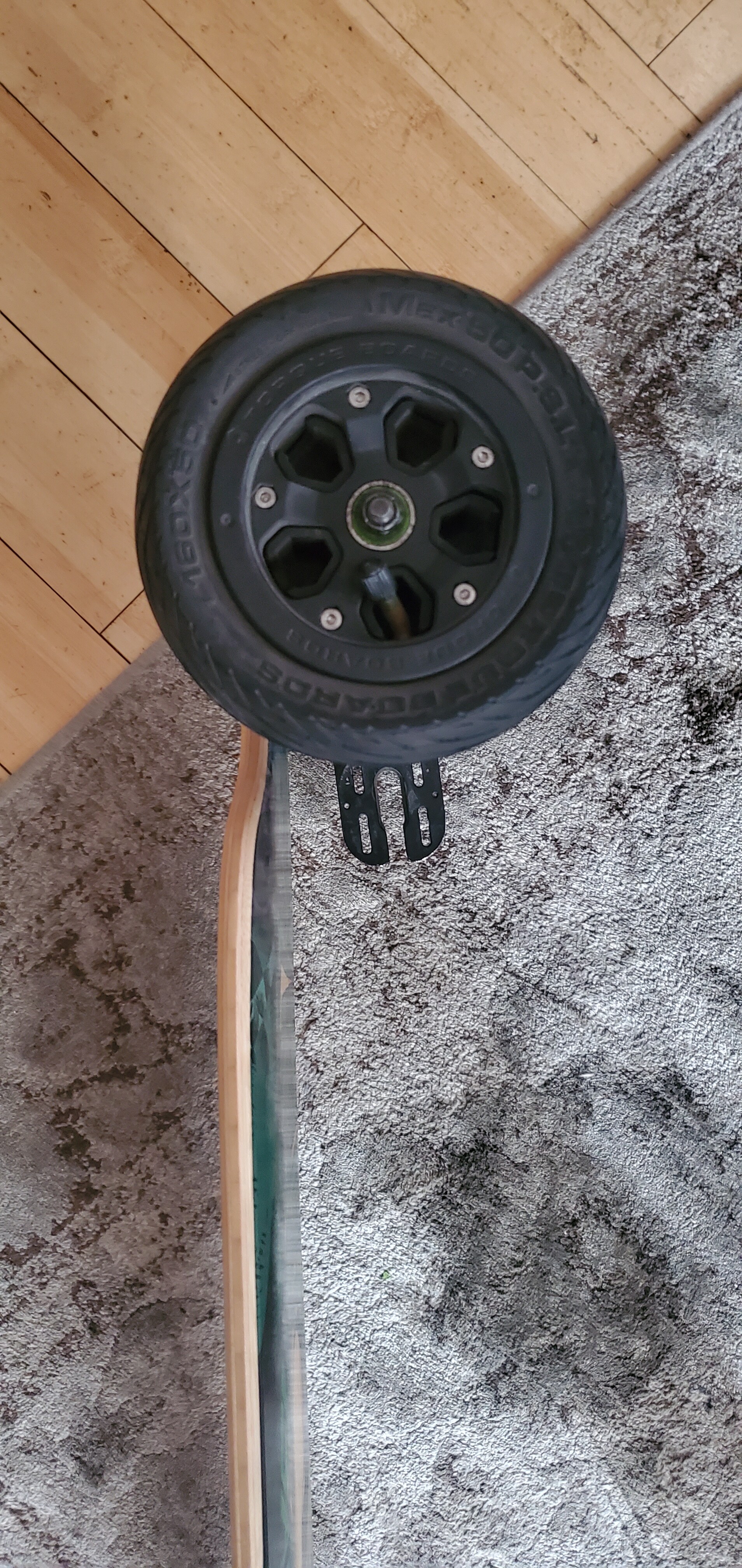

Do y’all think this is enough ground clearance?
For the motor mount
