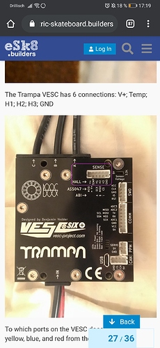

temp is usually white. You can check resistance value on it to see if it matches up with a typical thermistor value. The other 3 are usually yellow blue and green.
Weird that I always find answers to others questions easily while I suck at my easy dumb questions
Of course, check twice and be cautious, but this should be the pinout.
5 wire sensors just don’t have a temp sensor, but yours is most likely a 6 pin
The color scheme should be matching.
The only important thing is VCC and GND aka red and black
Phase wires aka yellow blue green are not important in particular order as they’ll get detected by software anyway
Temp should be white in most cases or just the leftover cable

Just post a Pic of your sensor and we’ll get you sorted out lol
  • Grab a multimeter
  • Measure resistance between the ground (black) wire, and any of the other four unknown wires while providing 5v between red and black.
  • The hall sensors should read either open, or 0 resistance, and will flip back and forth while you spin the motor.
  • The temperature sensor should read like a resistor, probably somewhere around 10K ohms.
And… Is “usually” located directly adjacent to the 5v pin

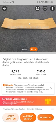

Where can you get these template diy deck wooden pieces with that 35 degree that you can cut with a jigsaw just how you want them to be?
Here’s an image because my description sucks

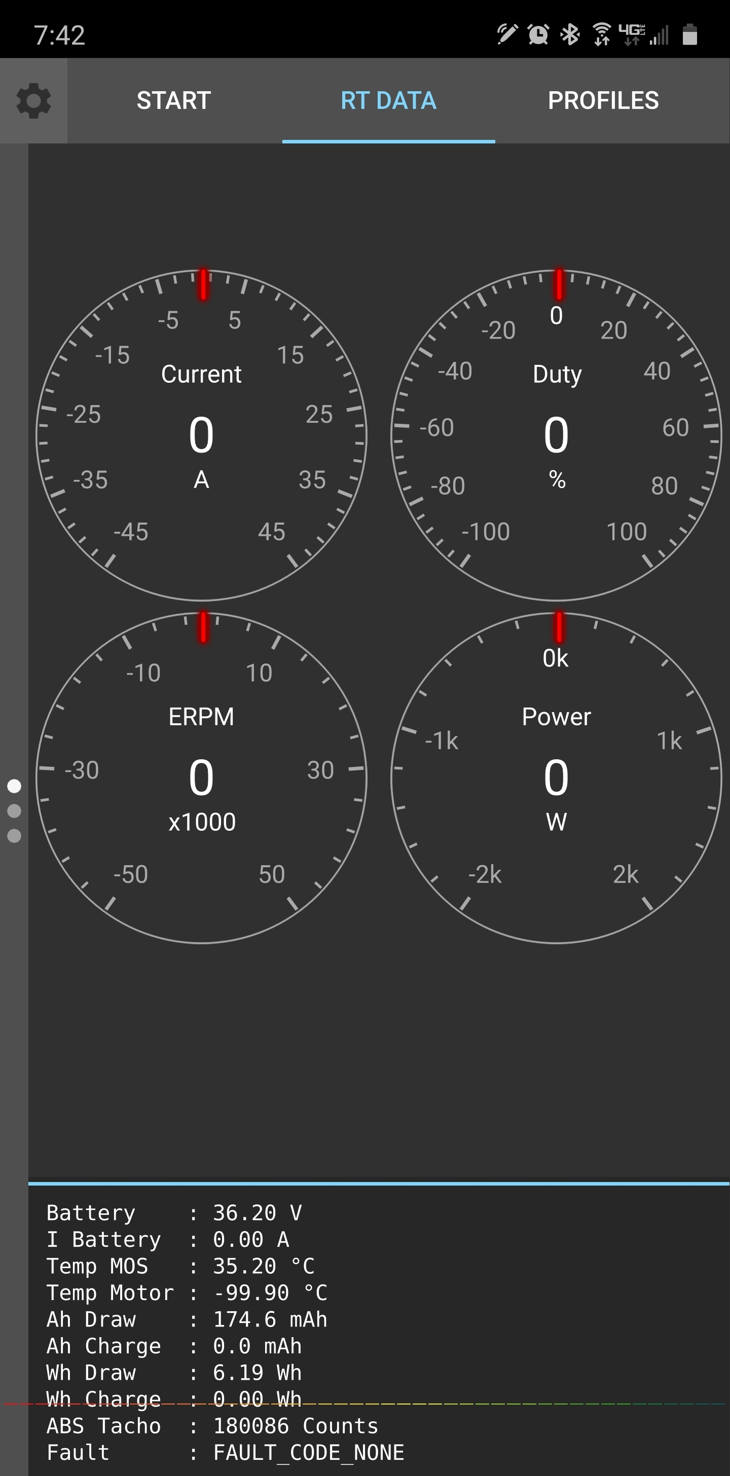

Unity fw 5.1 10s5p (LG MH-1) 50A discharge BMS. riding hard for about a mile, my board powers off. the only way I could get it to power back on was to power cycle the switch on the battery. happened a few more times on the way home. the last stretch I took it really slow like 2-5 mph and made it home without power off. battery was at about 36V. My cutoff start is set to 36V end is set to 32V. what could be causing this.
Total trip was about 8 miles.

No chance you went over 50A discharge? I’d throw this over in the “vesc FW 5.0 beta testers wanted” thread
thx, I could have… I was riding hard and fast. I have my battery set to 45V max.
