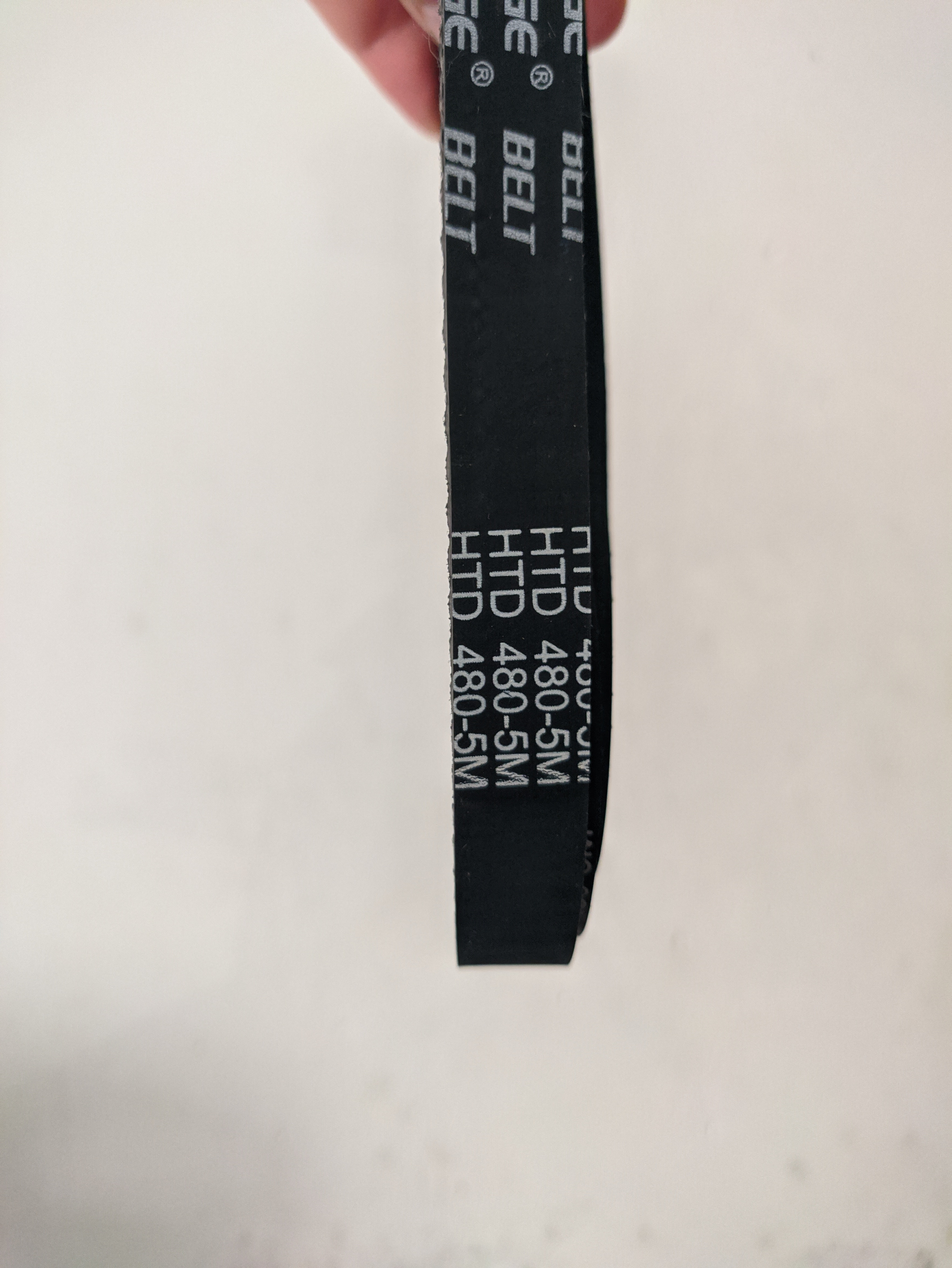

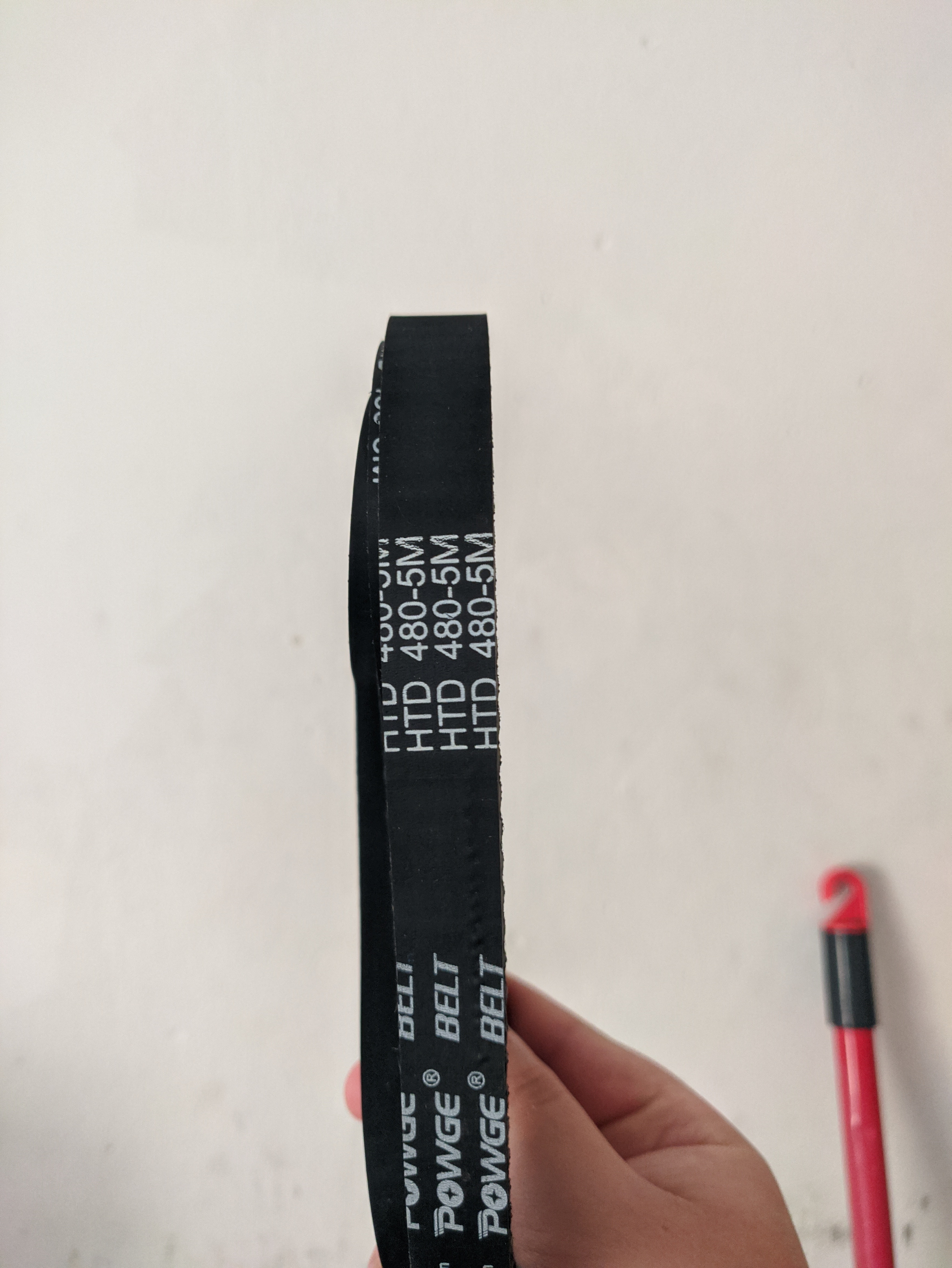

Theyre both advertised as 290mm, both motor mounts run parallel to eachother, so mounted the same way. BUT one belt is pretty loose and the other one tight as it should be… dont know what to do about it… they are different manufacturers though, maybe i should get the exact sam ebelt twice… but its weird that theyre both 5M 290mm and so different in tightness…
Theyre positionned the same way, exactly next to eachother, just like if i had cross plate.
Ill provide a video when im back home! Thanks!!!
Did you try what i told you with flipping the belt 180°? That fixed it for me.
Like flip inside side to outside side? Yeah i did that :confused:
yes, if your belt is like this:
you turn it around to this
Did so… :confused: A said, theyre different companies… but same length
