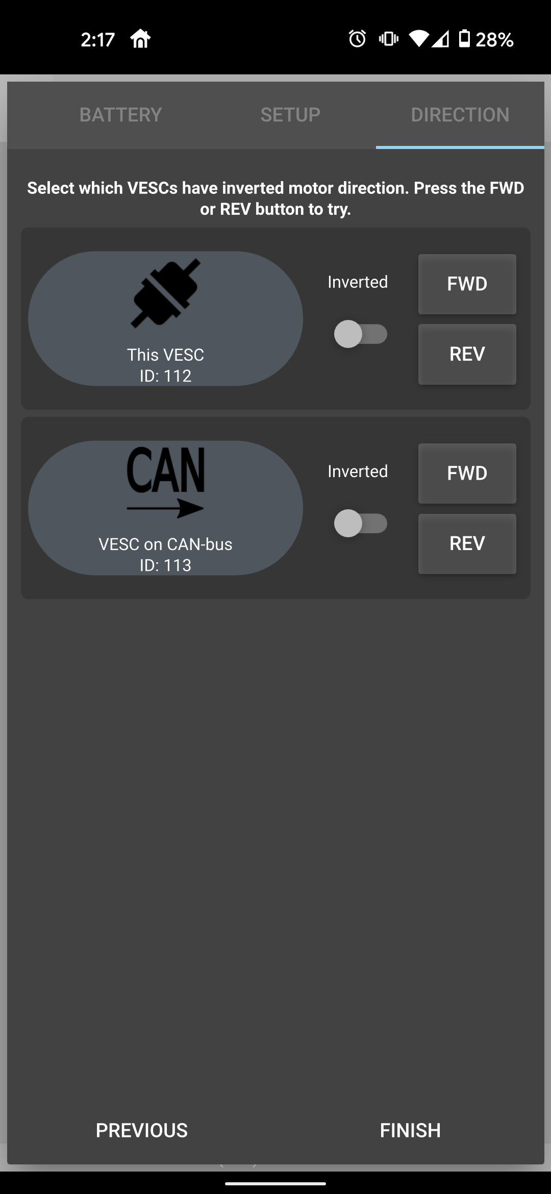

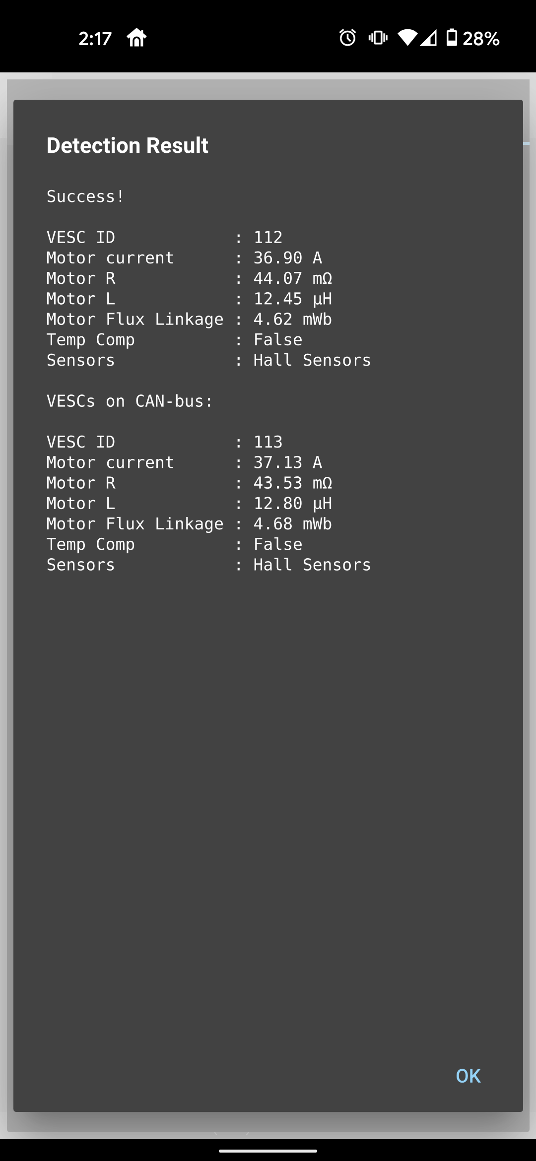

I’ve got a set of TB DD’s with one motor not showing sensor results on my unity at 12s with the latest FW.
I’ve confirmed the connection, what’s the next troubleshooting steps?
EDIT: I got the sensors to show up by running calibration like 5 more times. Now the motor has a very odd startup behavior with tiny inputs. Remind me to never build someone else a board again.
Edit2:
Weird detail, on the direction screen, testing doesn’t have the motor spin, just makes angry motor noises

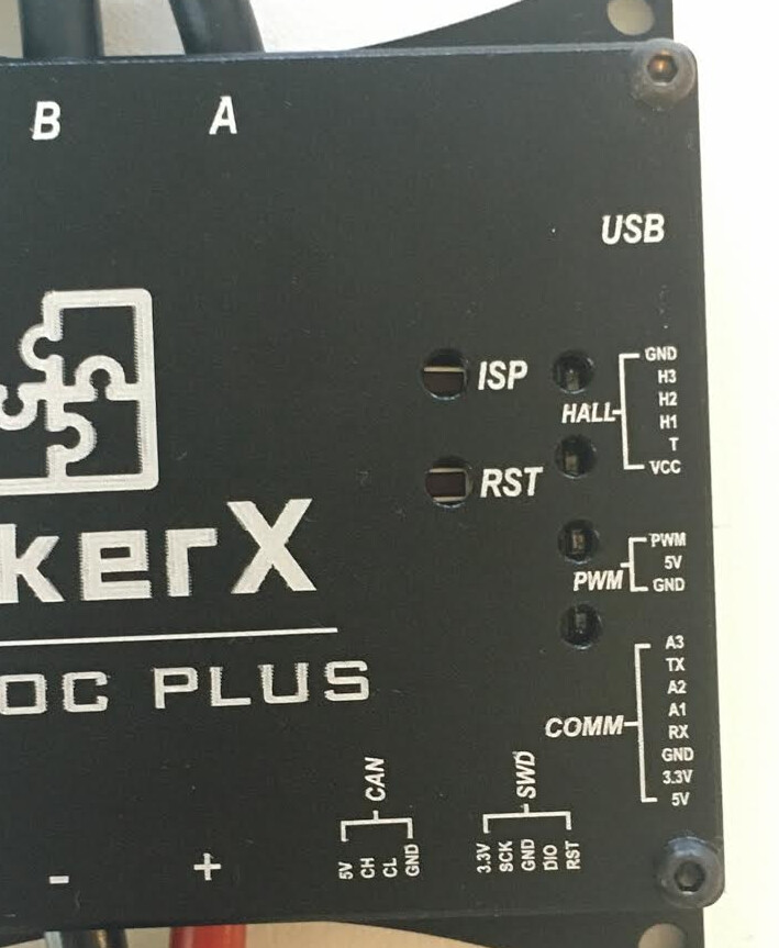

what are these holes in my ESC good for? - im guessing to reset something?
can i cover them up to avoid unwanted stuff getting to the PCB?
Looks like status lights. Cover with tape
:+1: thanks
You’ve probably already thought of this but have you connected to another ESC to make sure the Unity isn’t the problem?
That’s the one thing I haven’t tried yet because I would have to disassemble one of my other boards. I guess it could be a bad unity considering that it is a blood one

Switch the sides. Connect left motor to right side of ESC and right motor to left side of ESC.
Take note if the problem does — or does not — switch sides.
