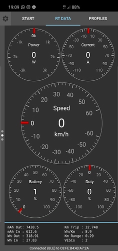

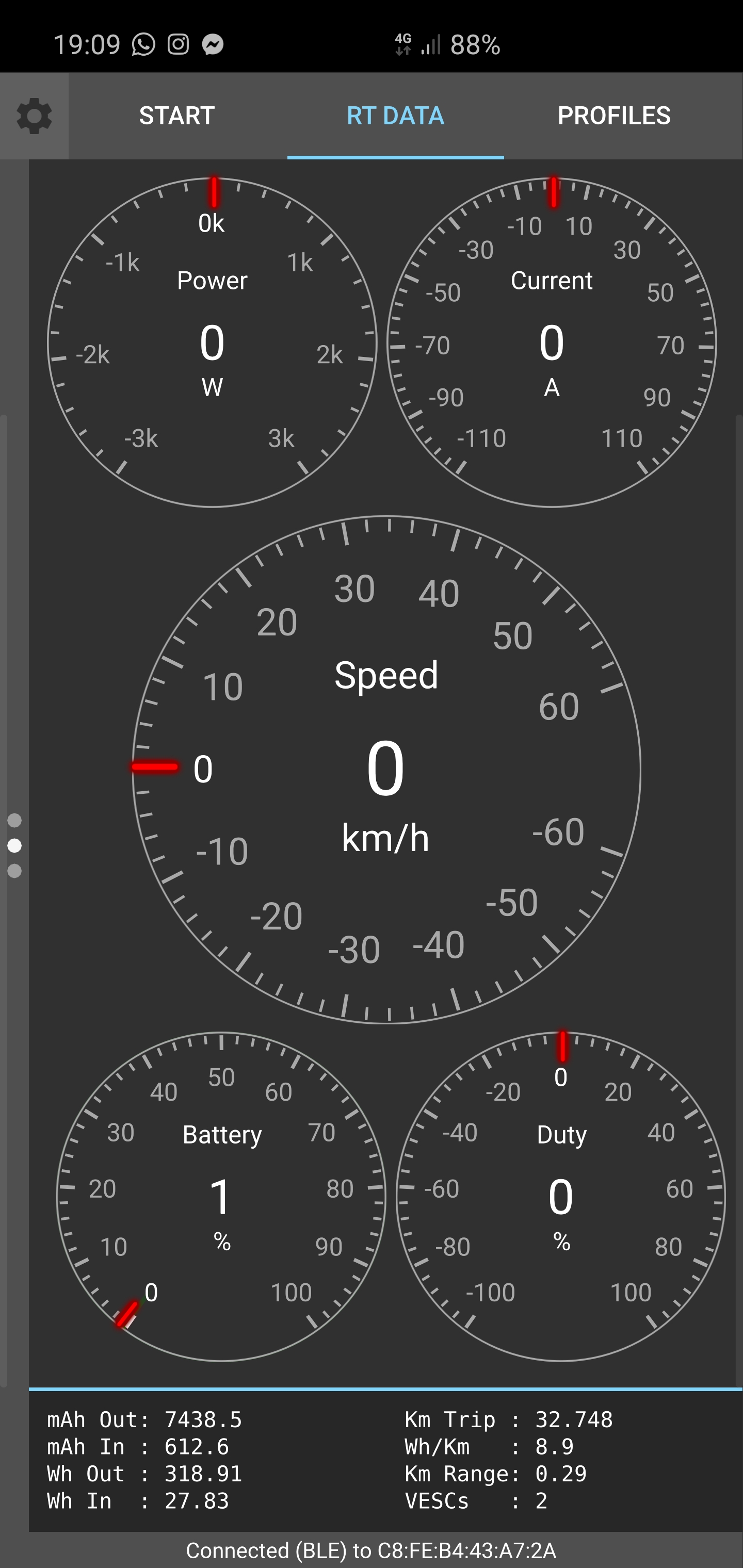

Does vesc only measure consumption that passes through to the motor?
I am supposed to have a 9000mAh battery, yet i am only able to consume around that number shown.
Is the other 1500mAh lost in the esc, remote receiver, etc?
Or is that simply the expected capacity for 30q’s under high discharge?
So 9000mAh + 612 mAh regenerative capacity - > 7438mAh with only 1 percent of battery left…
Resons could be cutoff voltage. You dont empty your battery to “real 0 percent” most cases. Assuming your battery pack is brand new, it could be really be that.
When on 34V most people already have set their cutoffs, having ~ 8 percent of battery left.
But why the difference is so big… Idk.
Maybe add not 100% full charging, maybe some losses in the ESC itself into heat that aren’t put into the motor etc. Also they’re 3000mAh under perfect conditions only, for sure.
The regenerative part i would skip it all together tbh. Maybe 20% of that actually got transformed back into battery charge. Most of it is agressive braking in london peak time traffic
Battery was at 38.4v in the screenshot (12s)

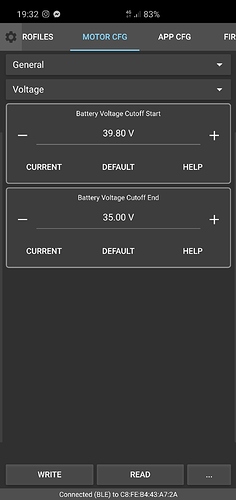

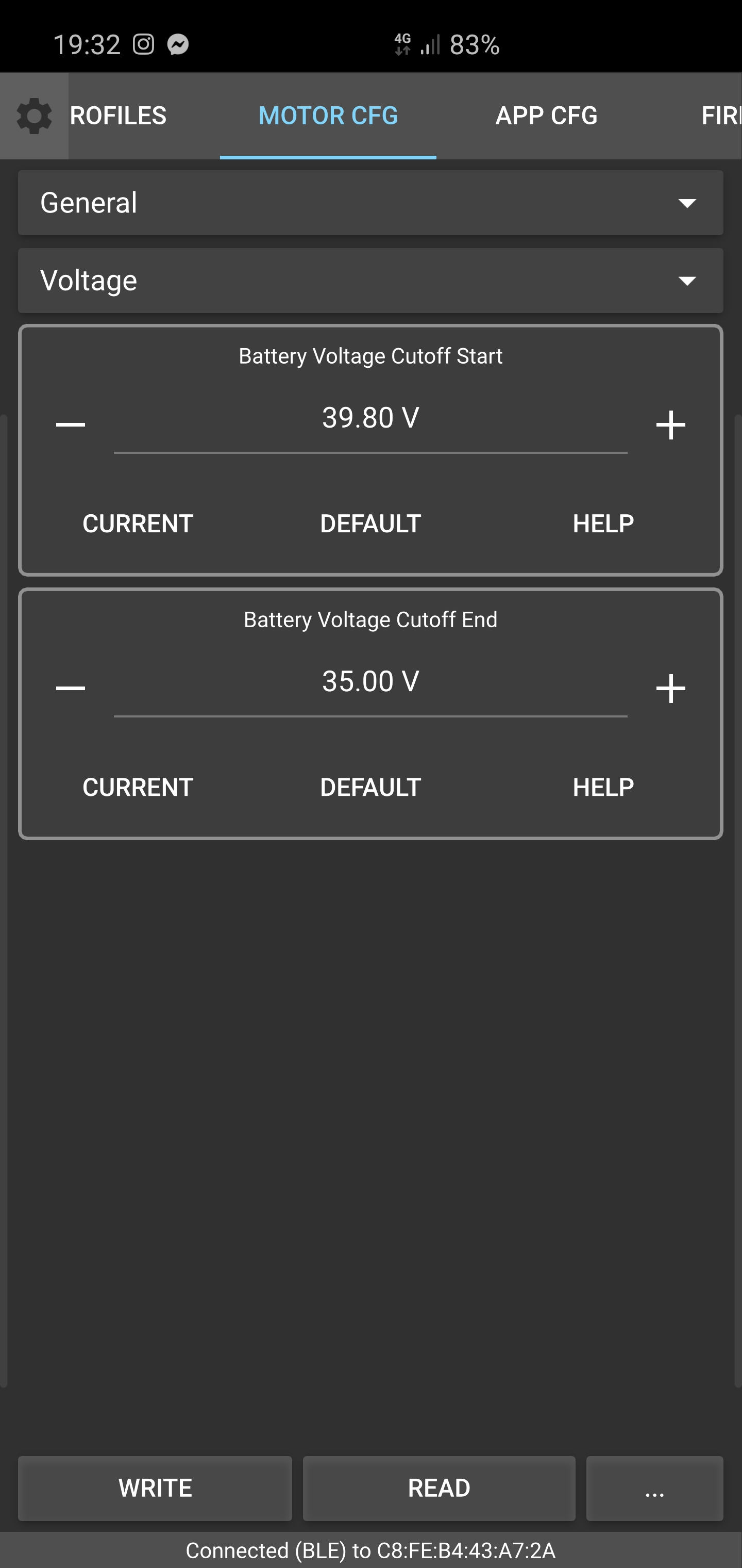

My cutoff voltages are default -1v on every number
Battery charges up to around 50.(1~2)v, maybe balances for a bit and stops around 50.3v measured by the esc and drops to 50v left alone (~95%). I think it’s pretty full?
One thing is that maker-x esc runs pretty hot by default… hovers around 40°c doing nothing, even if booted from 10°
What cutoffs do people use for 12s?
Taking in consideration sag of course…
