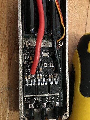

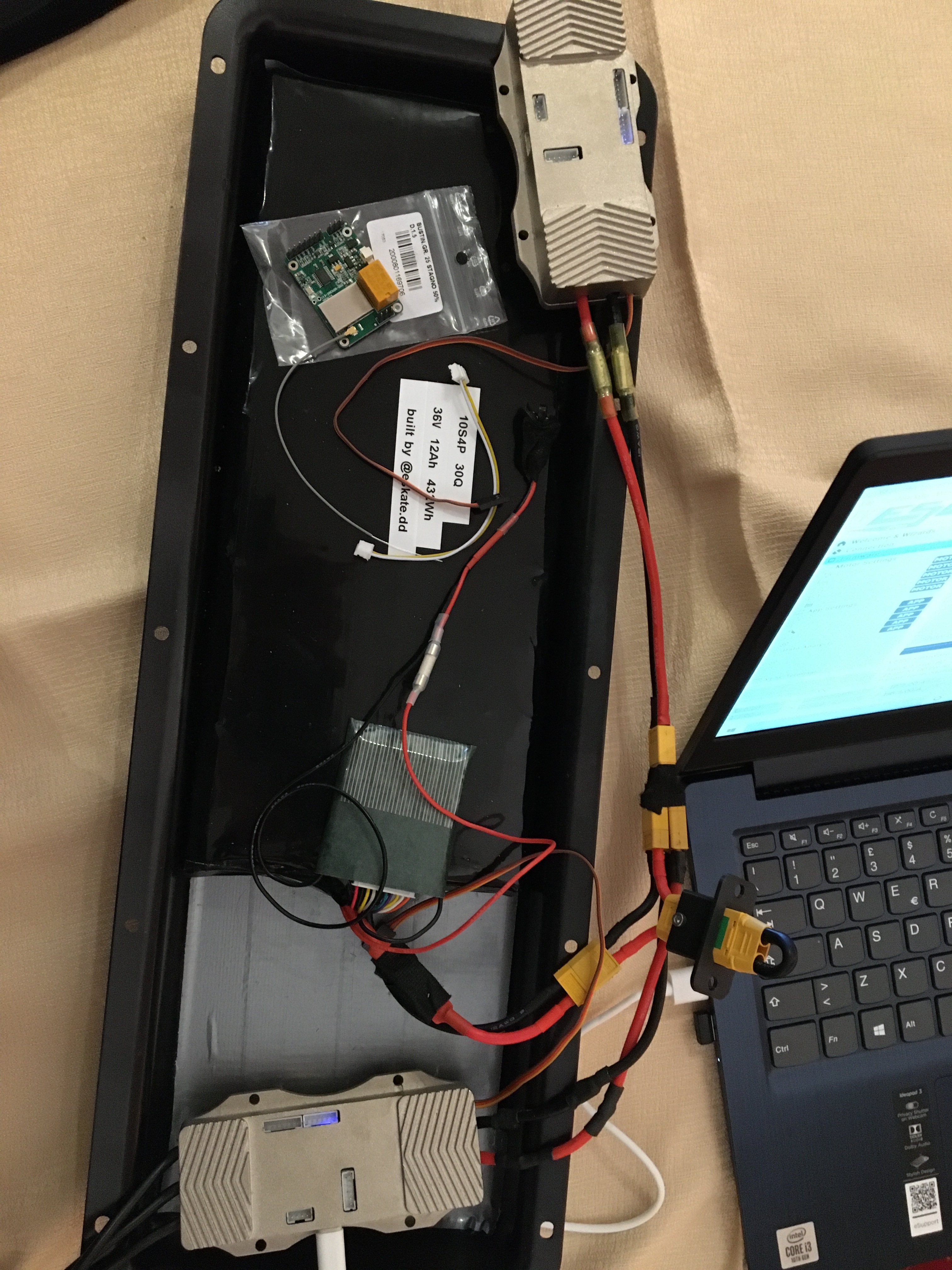

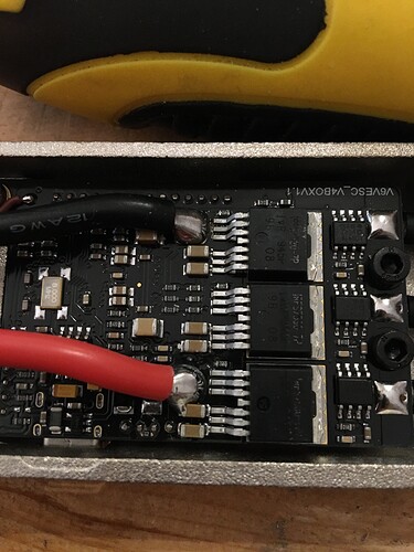

Any visible issues with this connections?
I think there is a short between the red cable and one of the capacitors… I don’t know if that should be there (probably no)
SOLVED

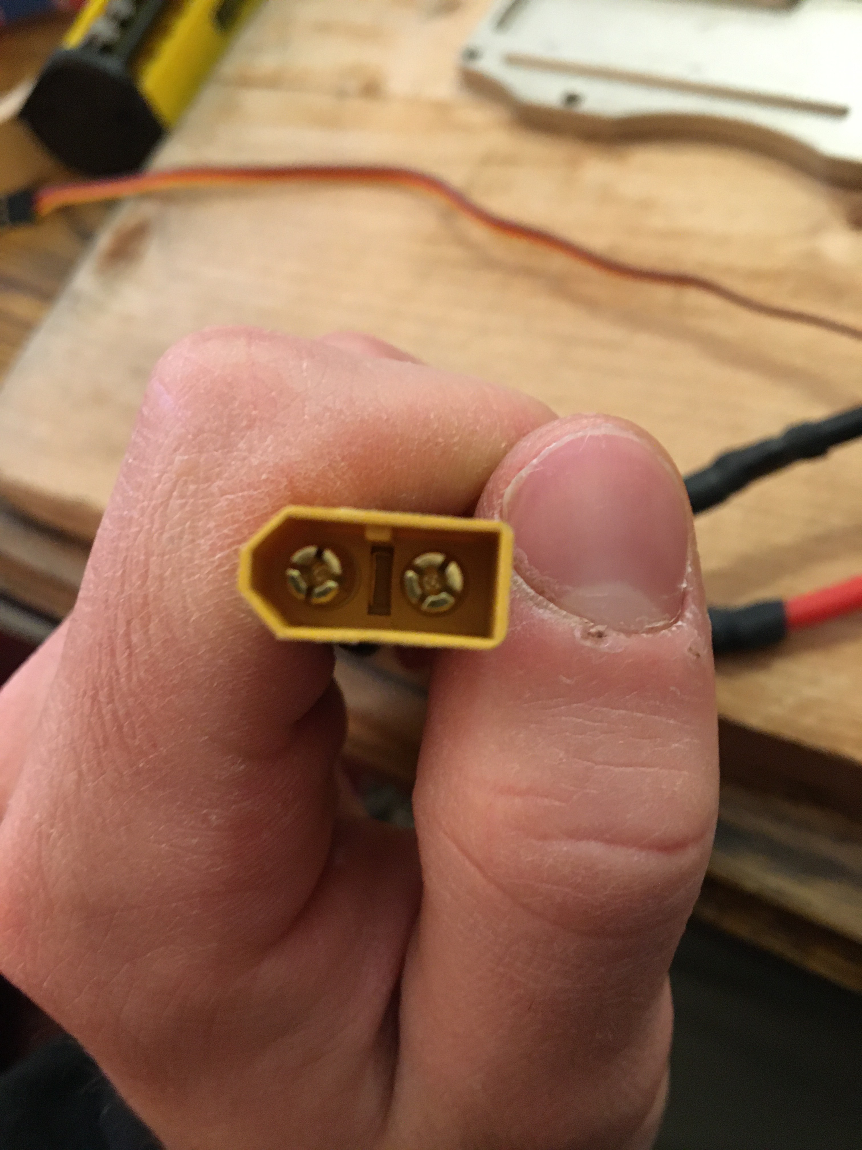

I re-made the connections between 12awg wires and xt60, didn’t work at first so I screamed a lot of bad words (those type of real bad words that we have only in Italy),chilled one hour and then tried again and now current flows and the esc connects to the Vesc tool app!
