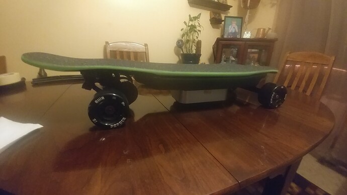

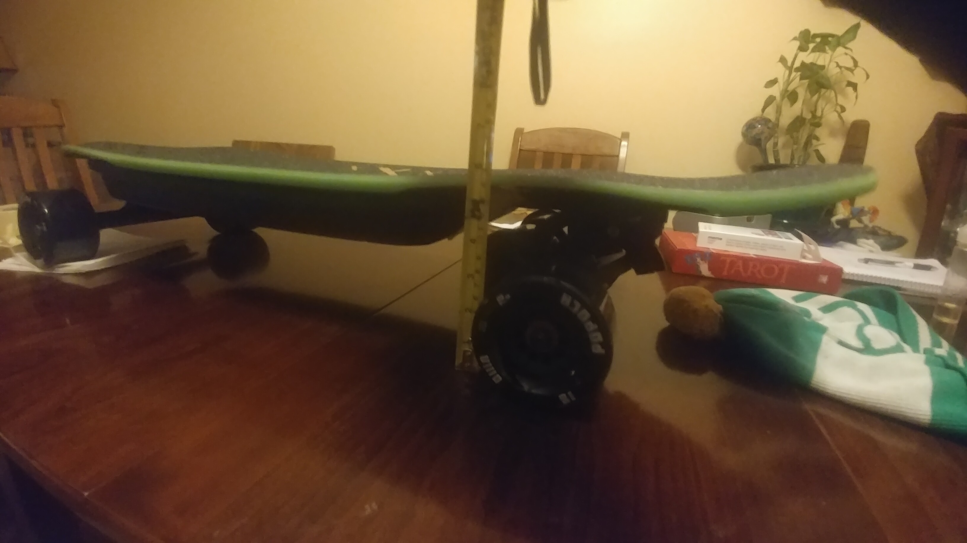

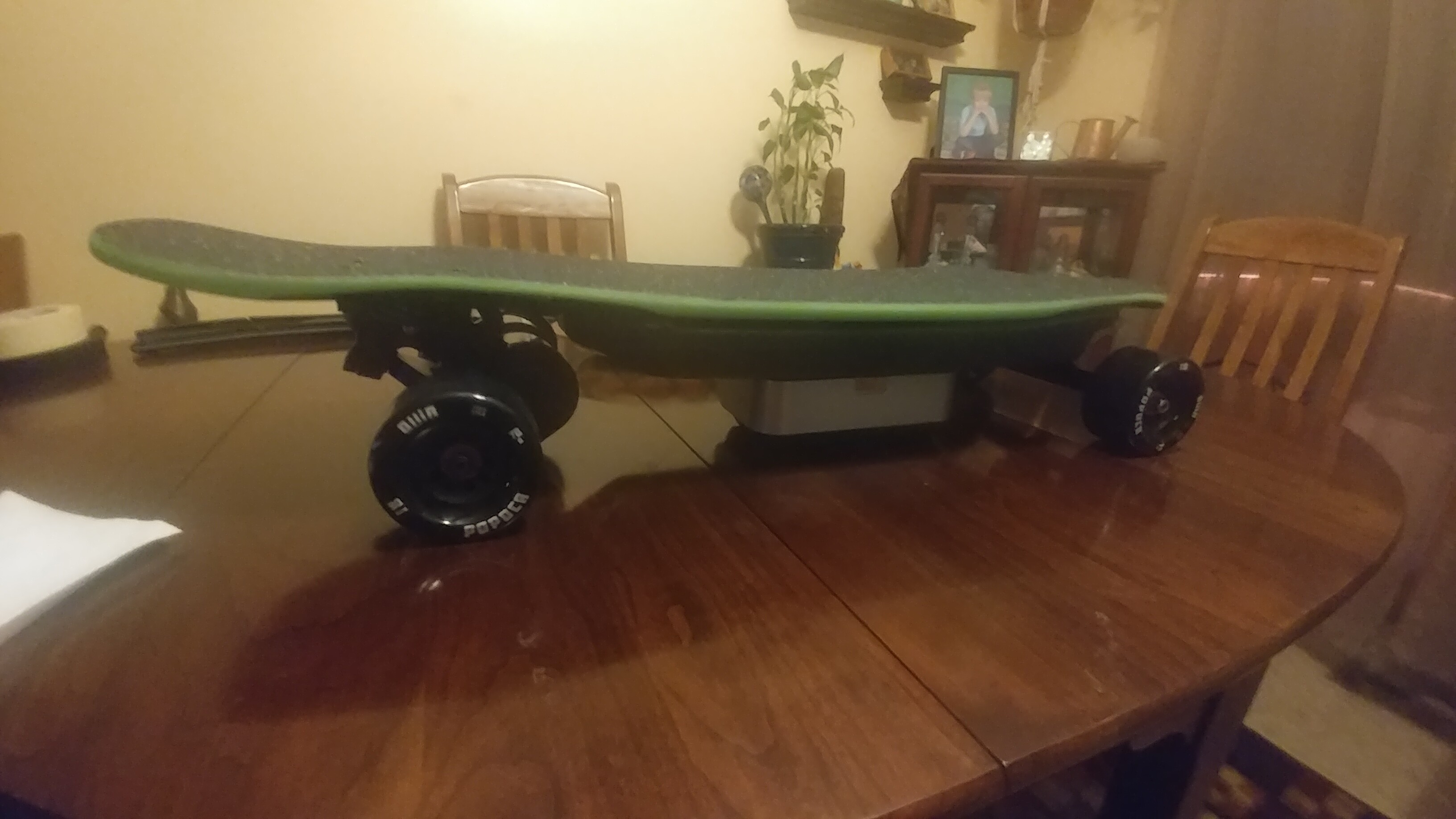

This makes me feel a little better after mocking up my build…
I may be wrong, but my understanding of the turning geometry of skateboard trucks is that your center of gravity is measured from the truck, since that is where the turning happens, not the ground.
So adding risers or top mounting your trucks changes your center of gravity, since you are increasing how far you are from the truck, but changing wheel sizes doesnt matter since you are not changing how far away from the truck you are.
This is the only case I can see where using bigger wheels would change your center of gravity.
That said, i still stand by my anecdotal experience that center of gravity doesnt matter as much as the rest of your truck setup (truck geometry, angles, bushings, etc)
That’s going to be an awesome skate!
What deck is that?
I hope so, trying to fine tune the last details(wheels,height/skin maybe).
Moonshine Sidekick
That’s what I thought, but the angle was really shallow, so I wasn’t sure
I hear vibration is mellowed a bit as well with urethane inlayed at the mounts.
I want do drop the tunnel risers, but then I have to drop the BN gears and move back to belts.

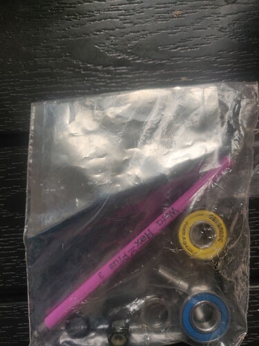

what are the best hex keys you can get
heard some complaints against wera
What wera the complaints? :joy:
Seen a couple people saying the ends broke of and bondhurs is better?
@xsynatic I seem to remember you being one?
One of them was Al and definitely me. Although i broke the absolute smalles one on a grubscrew with loctite. All others so far are very good for me.
Ah ok thanks
Just make sure to not get the stainless steel variant.
other than that I’m very happy with them as they also only cost 24ish euro
Same
Iam happy with my Wera set too
And the good thing is - you can buy every single replacement key separately (costs something like 3-4 Euro each)
I have this little set with me each time I ride, so I’ve bought one additional key :slight_smile:
What variant do you get?
i have the hex plus blacklaser. You could get the HF variant with a screwholder on the keys
