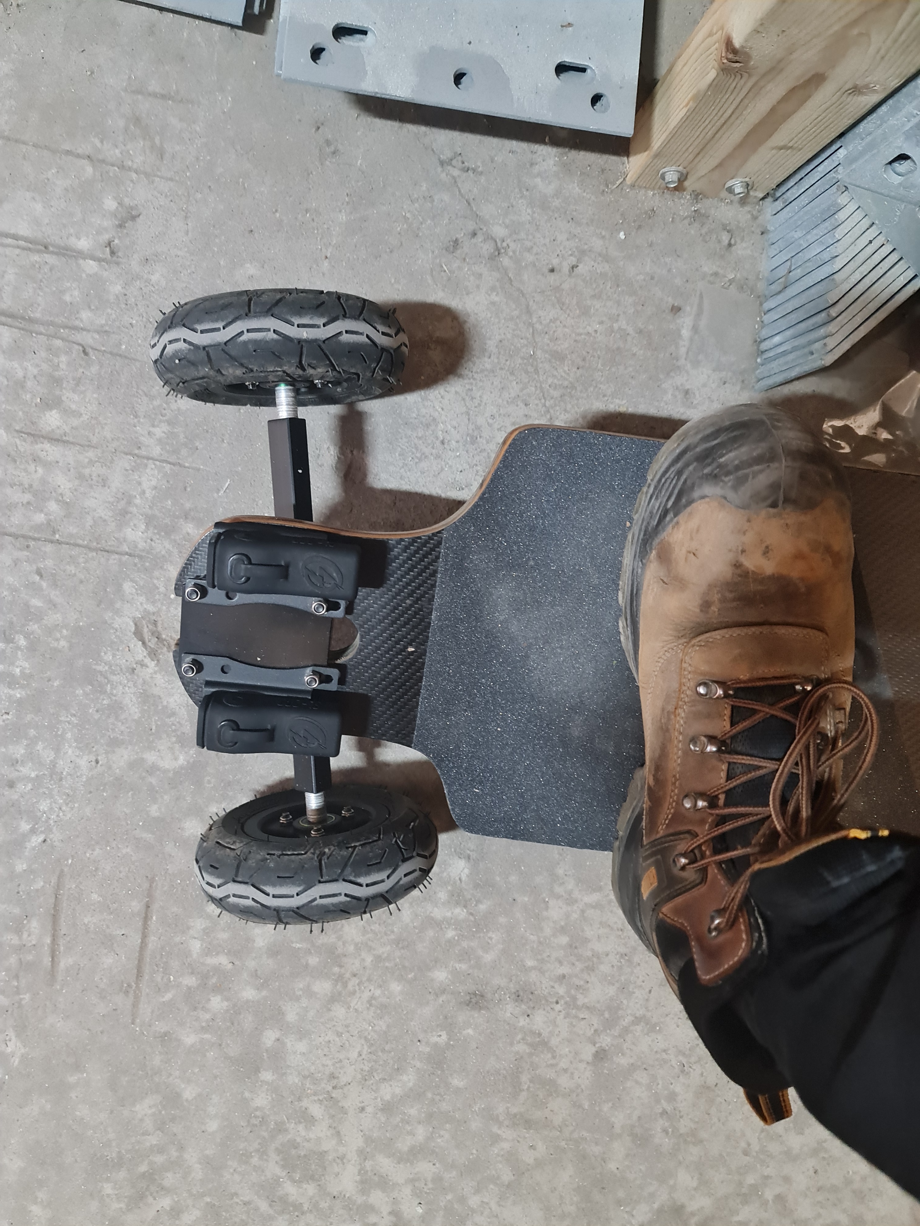

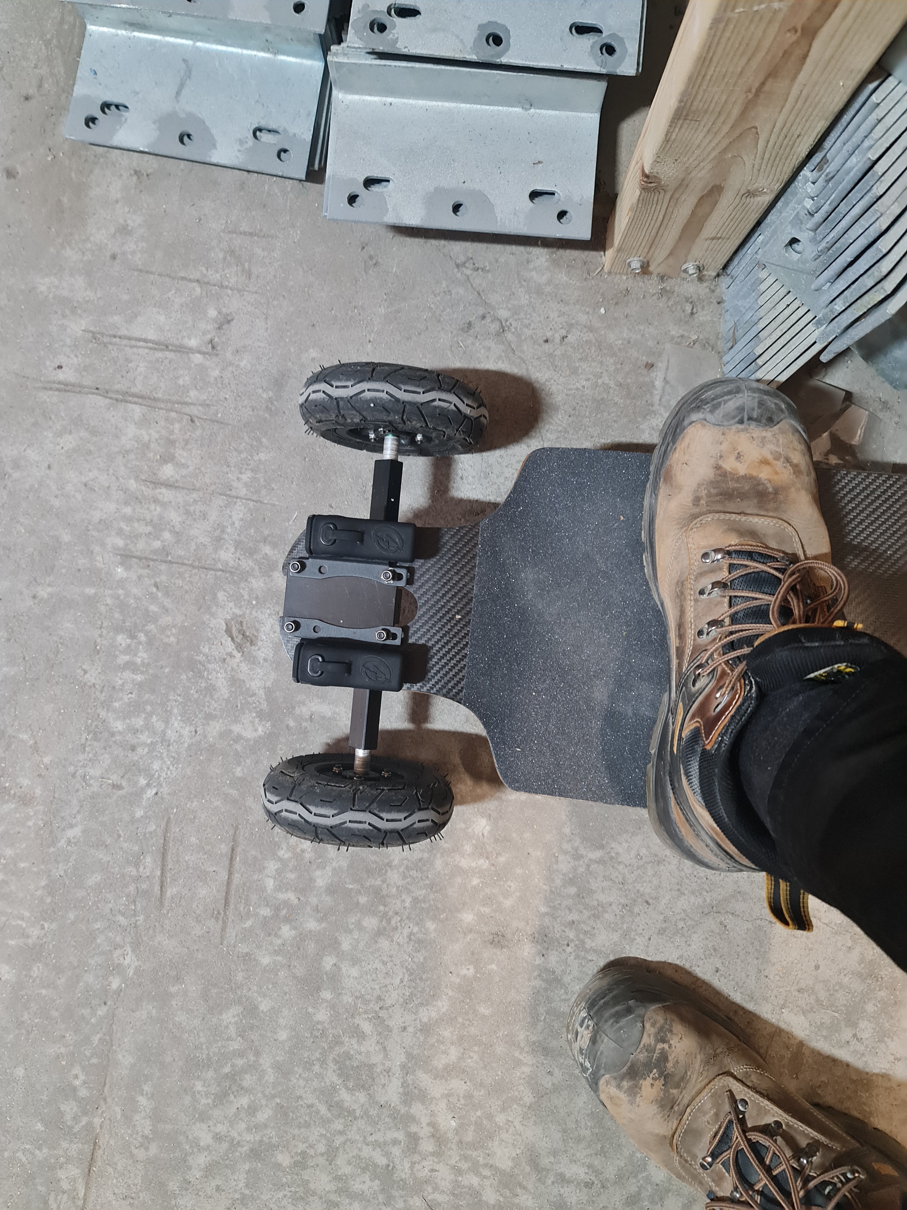

50° baseplate, no chance of wheelbite
Most people refer to them as crossbars I’d say
Cross bars, torque bars, motor cage, not really a name it goes by. The average guy refers to them as motor protections

I have the same setup @Geo_Engineering_FTW
6" pnummies with no wheelbite, drop through mounted with BN 220 hangers. Since the TB are smaller, no problem there either.

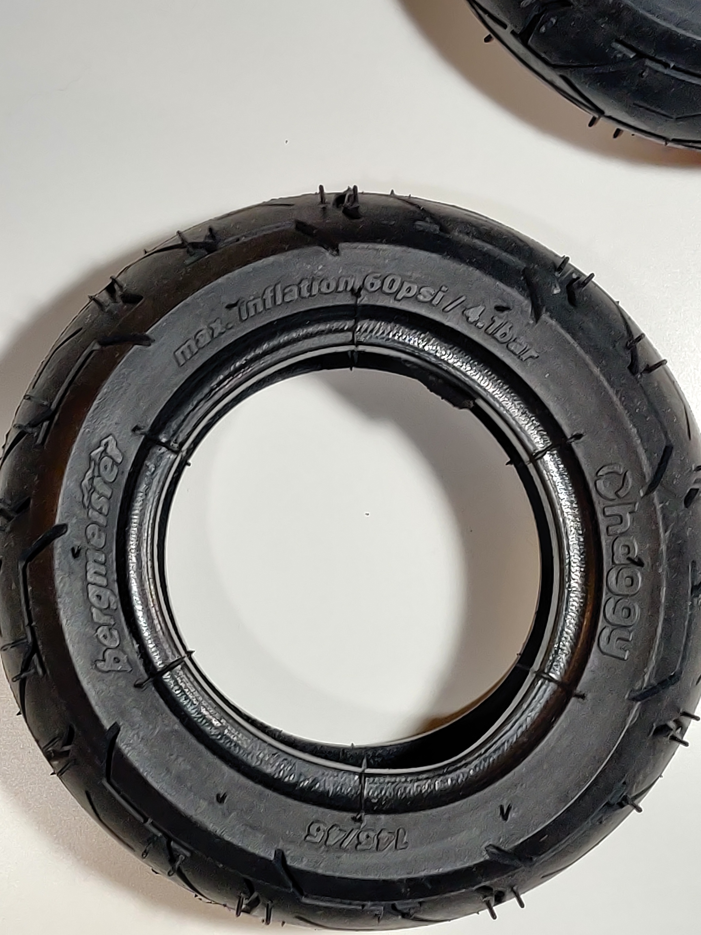

If only my bergs tires didn’t wobble so much…
My bergs seem to wobble a whole lot less than aliexpress 6x2’s to be honest. I’ll probably try to put a counterweight inside the tyre to match the valve and see what happens
Really? I’ve heard exactly the opposite.
My bergs actual tires just aren’t round all the way I don’t think
Did the wheel balancing with my TB pneumies and helped a ton with the wobbles from imbalance especially at higher speeds, it’s still got some imbalance but far less of an issue.
Bergs are about half the weight from my hand-scale approximation, so even if technically they are more unbalanced, it’s not so bad they almost lift off the ground at speed, unlike aliexpress wheels…
Of course, they didn’t exactly look centered at the beginning, it took some inflation and adjustments to center the entire lip and break them in like that, but they’re really nice on the front now
Interesting, you’re like the first to say the bergs are more balanced than Clevers lol
I have bought bergs twice. Once was almost exactly a year ago, the other was this summer when timo was doing his moving sale.
The bergs I got last year were perfect. Totally round, never had a wobble or a flat or nothing.
The bergs I got this summer…
Not so much…
