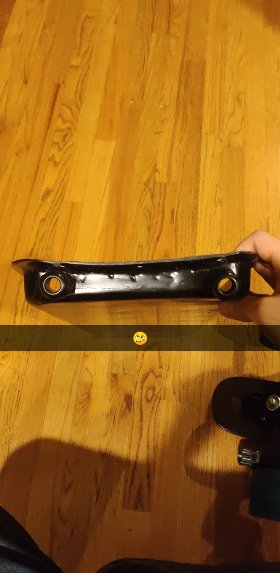

Could I unfuck this by filling in the hole with jb weld and re drilling? Or do I absolutely need to do another layup of fiberglass?
I taped and marked the holes to line everything up but clearly I suck at this :joy:

JB weld (Or any epoxy/resin/adhesive) has very little strength on its own. You need some kind of reinforcement, be it fibers or a backing plate to support the forces you will be applying by drilling a new hole.
