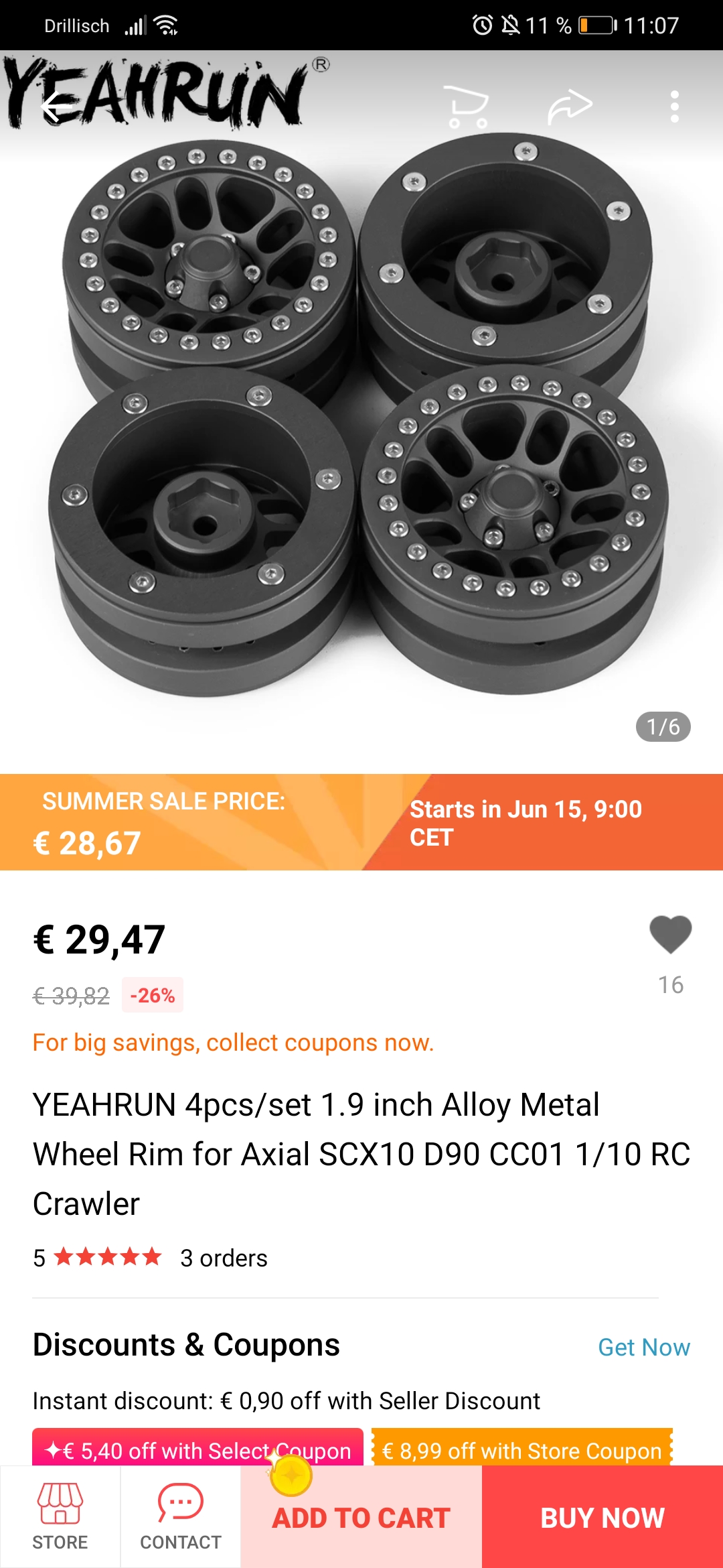

Why is there no wheels with these rims for esk8?
I mean besides trampas Hypa gummies :roll_eyes:
