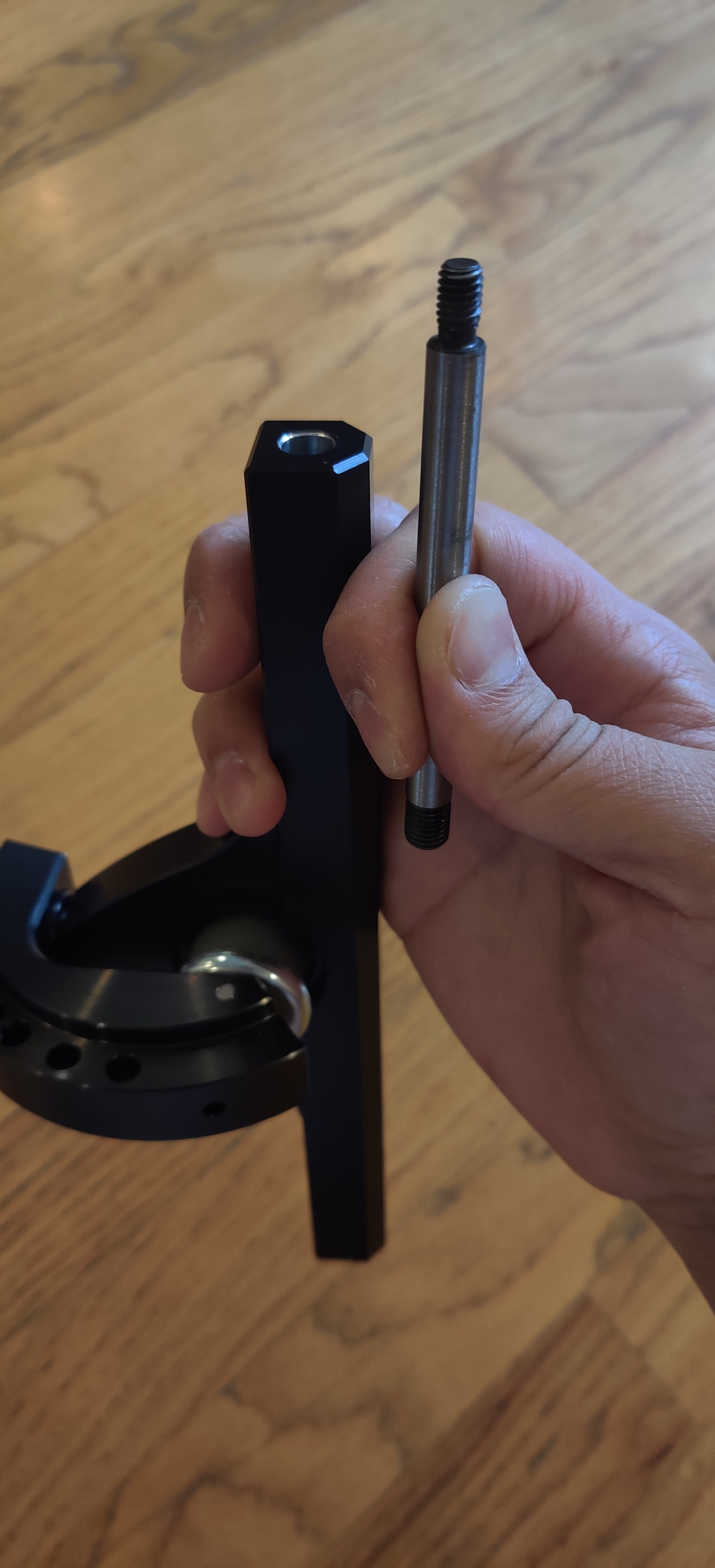

I clean the hole out with alcohol and a cotton swab, let it dry, then epoxy the axle in with JB Weld or West System 650
