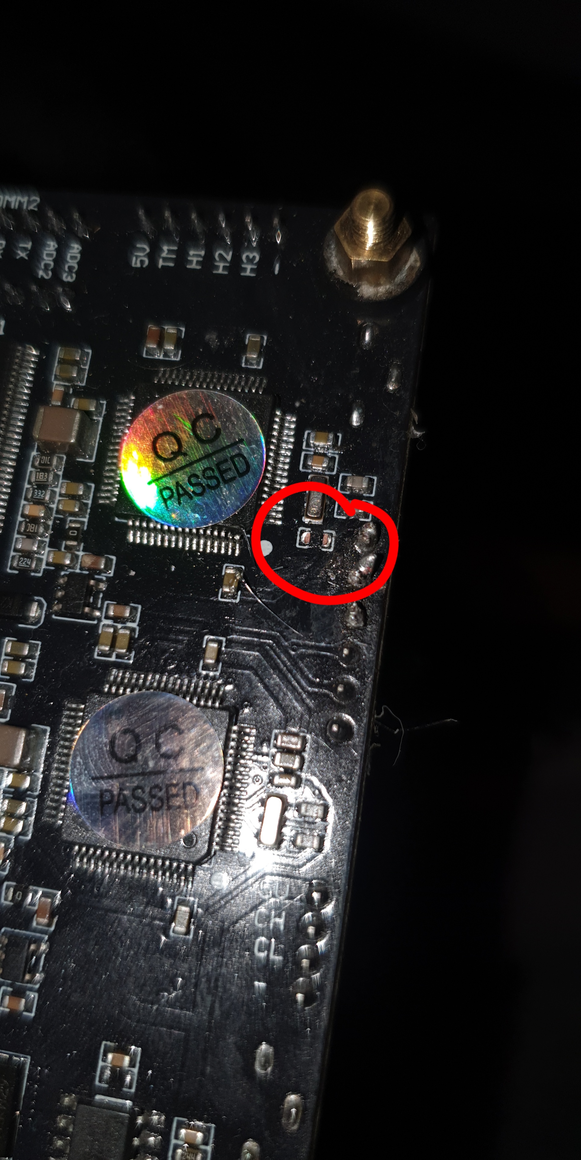

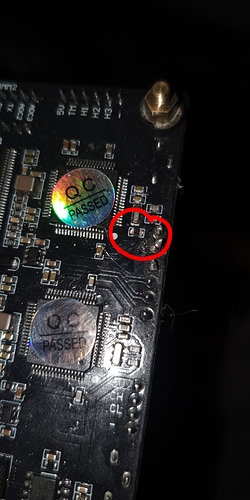

Hi guys. I just accidentally pulled this little chip off. Is it important to have it should I solder a join between?
It looks like it was probably a surface-mount resistor. Definitely shouldn’t use that controller until you find a matching one and replace it. I think the best thing to do would be to measure the resistance of the resistor that fell off and replace it with an identical one from mouser
Thanks for your response. first I have to find it because i dropped it on the Fu**ing carpet

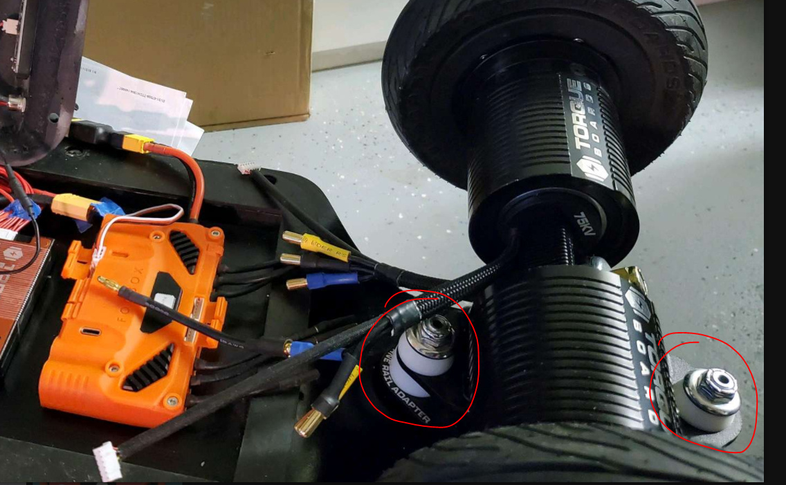

Wtf is going on here

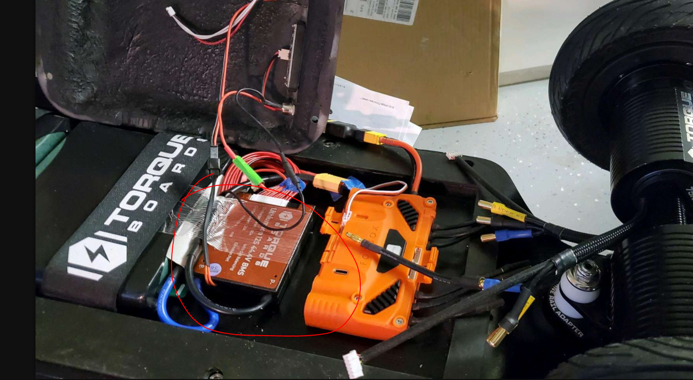

And here: Daly BMS with TB logo???
It looks like a surf adapter… I think
But that Daly BMS with TV logo is interesting :laughing:
I lost it :frowning: Anyone have any info or spec sheet so I can find what spec it is?
This thing https://waterborneskateboards.com/products/rail-adapter
As for the TB daly bms, no idea :man_shrugging:t2:

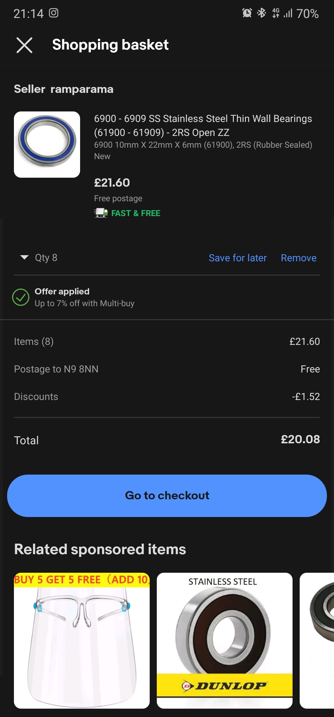

Stainless steel bearings: good or bad?
Also, is there any bearing size that’s 10x22x7?
Best i find is 10x22x6, with prices that vary wildly

If someone else has the same controller, they could measure it for you. What controller is it?
